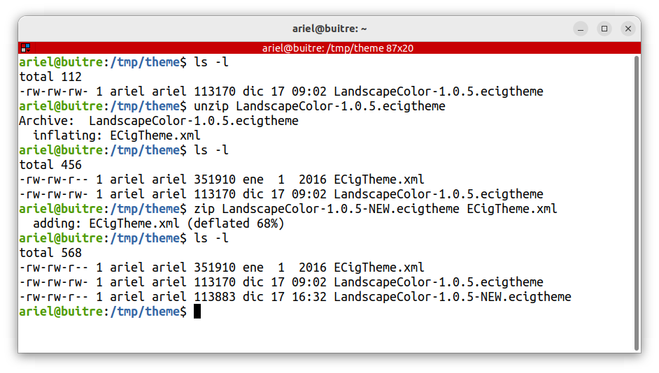

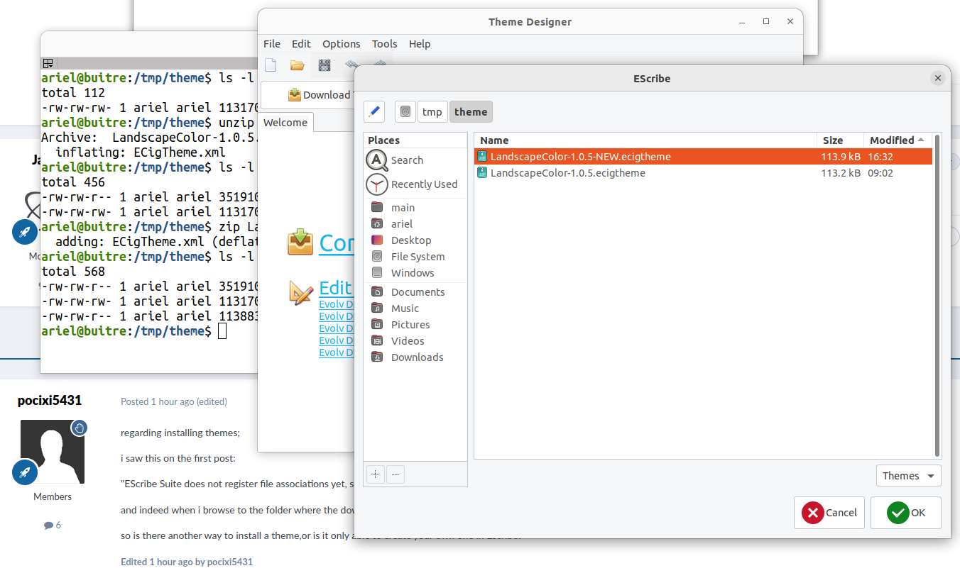

In order to Escribe to recognize a theme (either by opening with "Escribe -> Theme -> Load Theme..." or with the Theme Designer) the xml file (ECigTheme.xml) should be zip compressed and with the .ecigtheme extensión: -
