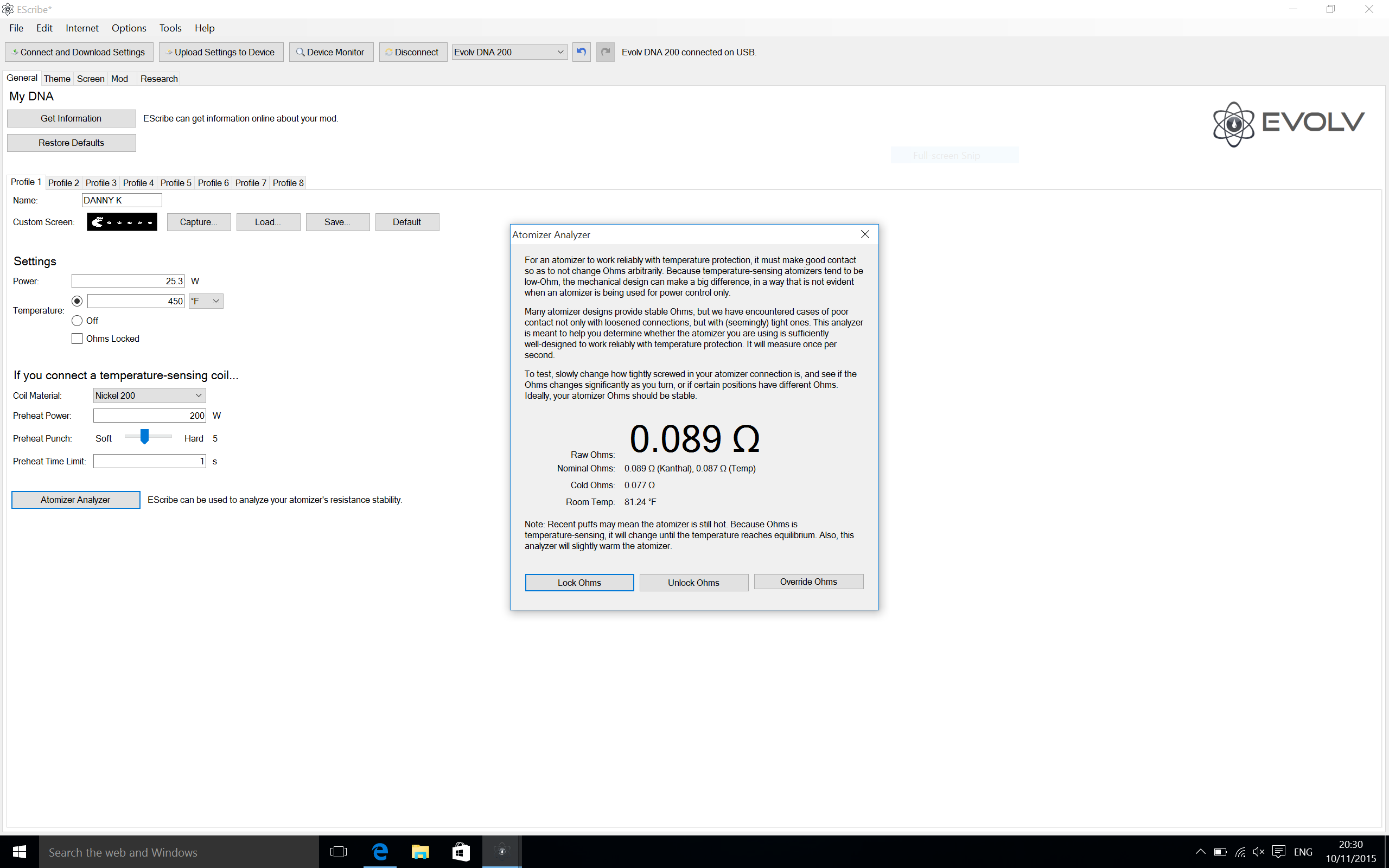

In the atomiser analyser if you look next to kanthal ohms it says the temp (ni200) ohms.. You can also change the preheat if you want too? I'm not sure why your asking? What are you having problems with? it would be better if you posted screen shots of the graph rather than excel format although everything looks fine I don't know exactly what I'm looking for?[/QUOTE] It's not a problem as such - was just confused as to why it said (kanthal) but i now realise it also says (Temp) with ohms. if running Ni200 you dont really need to see the Kanthal ohms and vice versa if running Kanthal you dont need to see the Temp ohms. Im guessing it was easier for Evolv to program it that way.
Apologies if this has been asked before Could someone take a look a few screenshots / csv files to see if this is normal This is a Ni200 build yet the atomizer analyser says (kanthal) ? is this correct ? Also Preheat is set to 200 (Default) ? Any advice would be greatly appreciated. DNA2.xls DNA.xls
