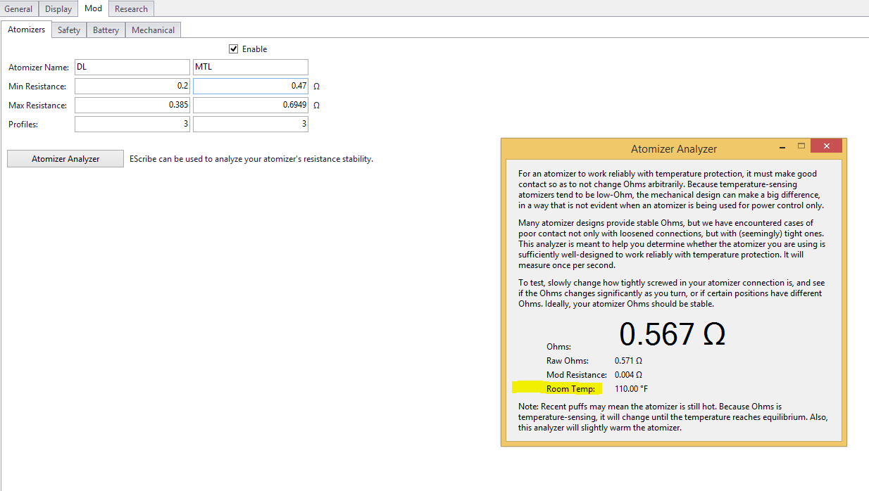

On my DNA Go, I haven't been having much luck liking the vape on either .5 or .25 pods. It just feels like they have a low ramp up and eventually burn out as I am forced to take longer pulls. Just checked in the Atomizer Analyzer and noticed that the Room Temperature is at 110F, which is completely way off (actual room temp is 70F). I am wondering if this is an issue and maybe causing poor performance. I tried to do hard reset, reboot and soft reboot, but nothing seems to make this temperature go down. Even in the Device monitor the Board temperature is constant around ~122F Anyone who can chime in and let me know what can I do about this.

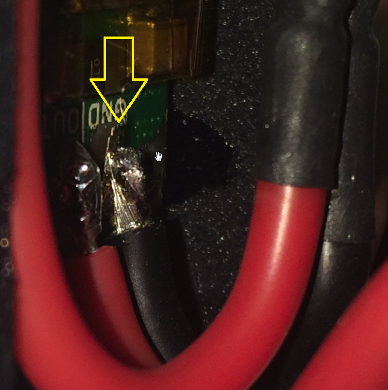

Sad to say.. my GND pad is also lifting. My mod is a 3d print and this is the negative lead from 510 and the only ground to board, all other are on plastic no screws. Is this safe to use for now until I get some hot melt glue as mentioned by John.
