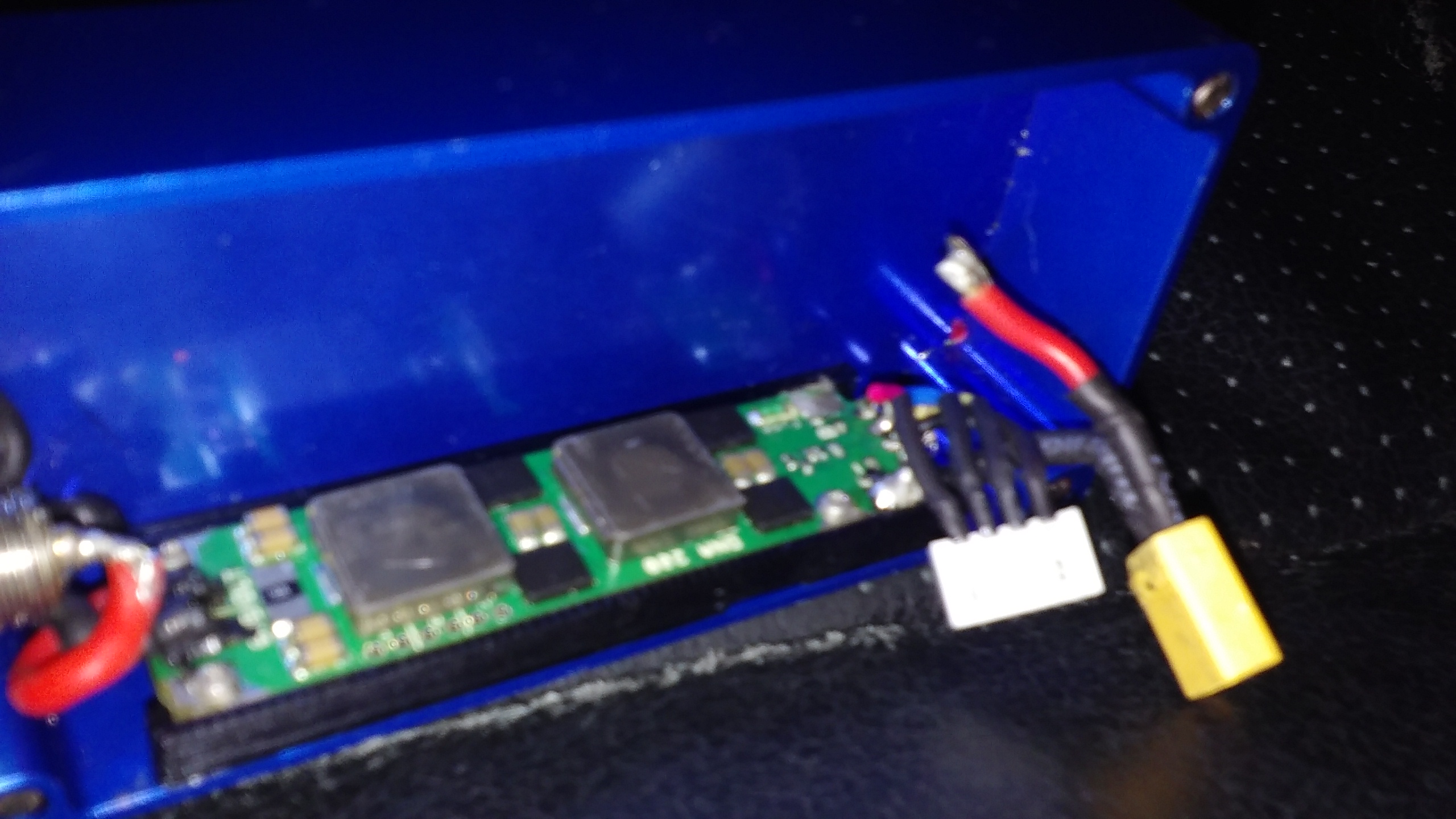

I had my Reuleaux dna200 board go bad on me, it actually had one of the two large square inductor's come off the board completely. I sent it in and got a replacement board from Evolv, which btw as always they were a pleasure to work with and were great about doing the replacement. When I took this board out I noticed a couple things I didn't expect. First thing was the wiring seemed a bit small. Not the balance wiring but the battery wiring, the 510 wiring was large enough as well. Also it was wired strangely. Anyways, that's not what I want to know about. It had these two little square blocks, one of which was soldered between the B- and the balance ground solder point. The other was between then B+ and the balance point 1. I was able to remove the 2 little blocks and keep them. Although they are all black looking now and not sure how good they are but they still have the same shape. Anyways, I want to know what those little blocks are and if I should reuse them and wire it the same way? Or is there a better or different way of doing it? Also should I remove and replace the small wiring from the sled to the dna200 board? Will it make a difference in sag under load? Here is pic that I found on this forums posted by vaping bad in this post: /topic/67734-topic/ -

OK I opened it up finally to figure out what is shaking around. It turns out one of the 2 big square heat sinks has come loose. Is that fixable ? Or am I screwed now ?

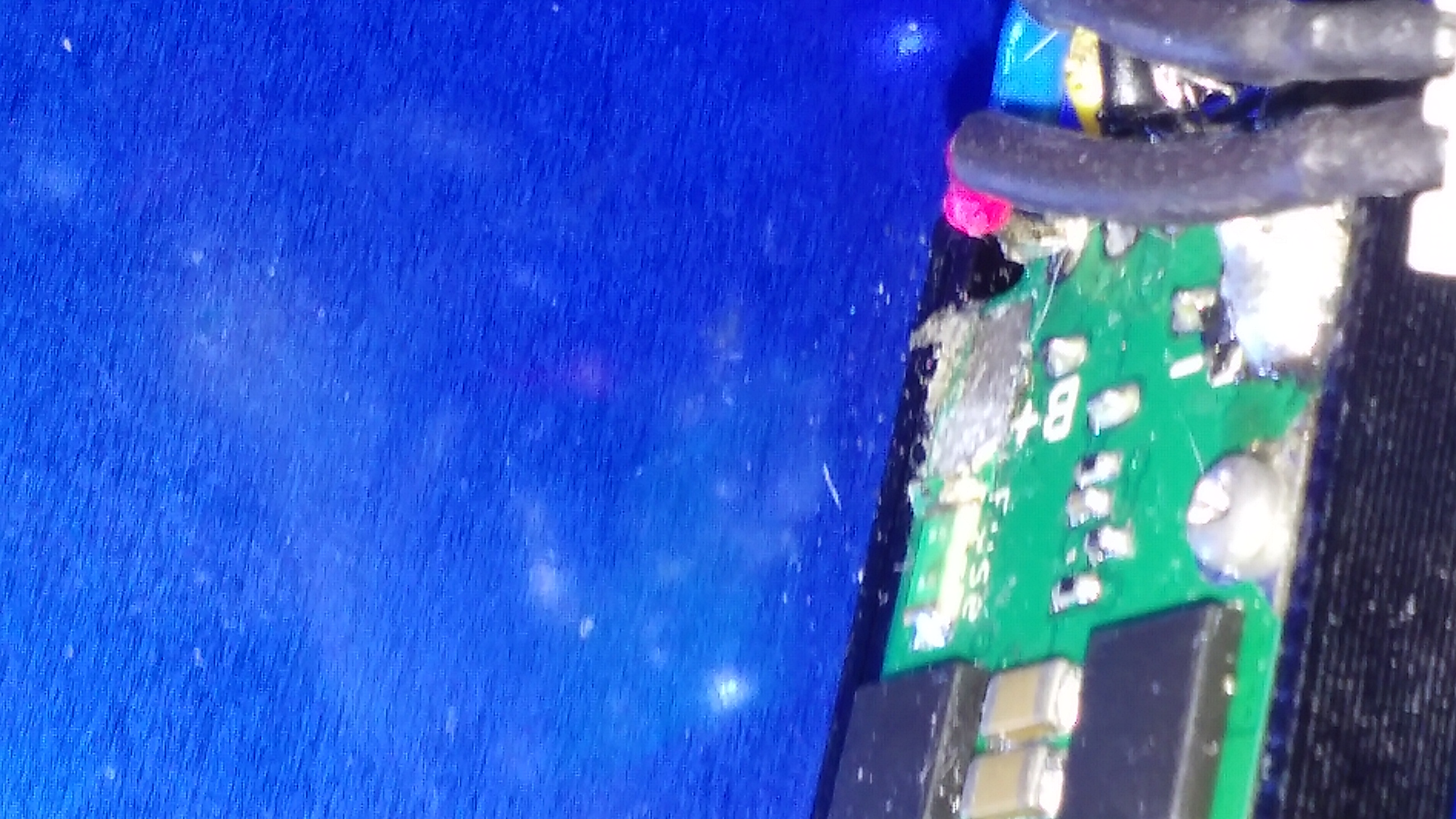

What you see on the board isn't a solder pad. Its what's showing now that it's no longer there. Thanks for the Reply but it's of no help. If it was that simple I wouldn't post. I have been doing this a while but first time a solder pad actually came off a board ever.
I don't know where you got that from but I didn't rip anything off. I know how to solder but that's not the issue. Maybe because the pictures arent great or you misunderstand but the actual solder pad Isn't attached to the board but it's actually fallen off of the board itself. The wire still has the actual solder pad soldered to it. There is no solder pad to solder to on the board anymore as it's attached to the wire. If it just needed to be soldered I would have done it myself and never posted. If I don't hear back about this soon I guess I will start support ticket.
My first board stopped working. Got new one but now pad is off board. Can I epoxy it back in or is it a gonner? The pad is still soldered to the wire. I have hot glue/epoxy but I don't want to do anything that will less up chances of getting it replaced by evolv. I really just don't want to pull the chip out and deal with rma and it's gonna be a pain to get chip out of box for 2nd time. I really would rather avoid doing so but if not possible on. I just don't know if it will work if I put it back on. I have seen it done when it has only been partially off but this is all the way off and right next to fuse as well so it worries me a little.
