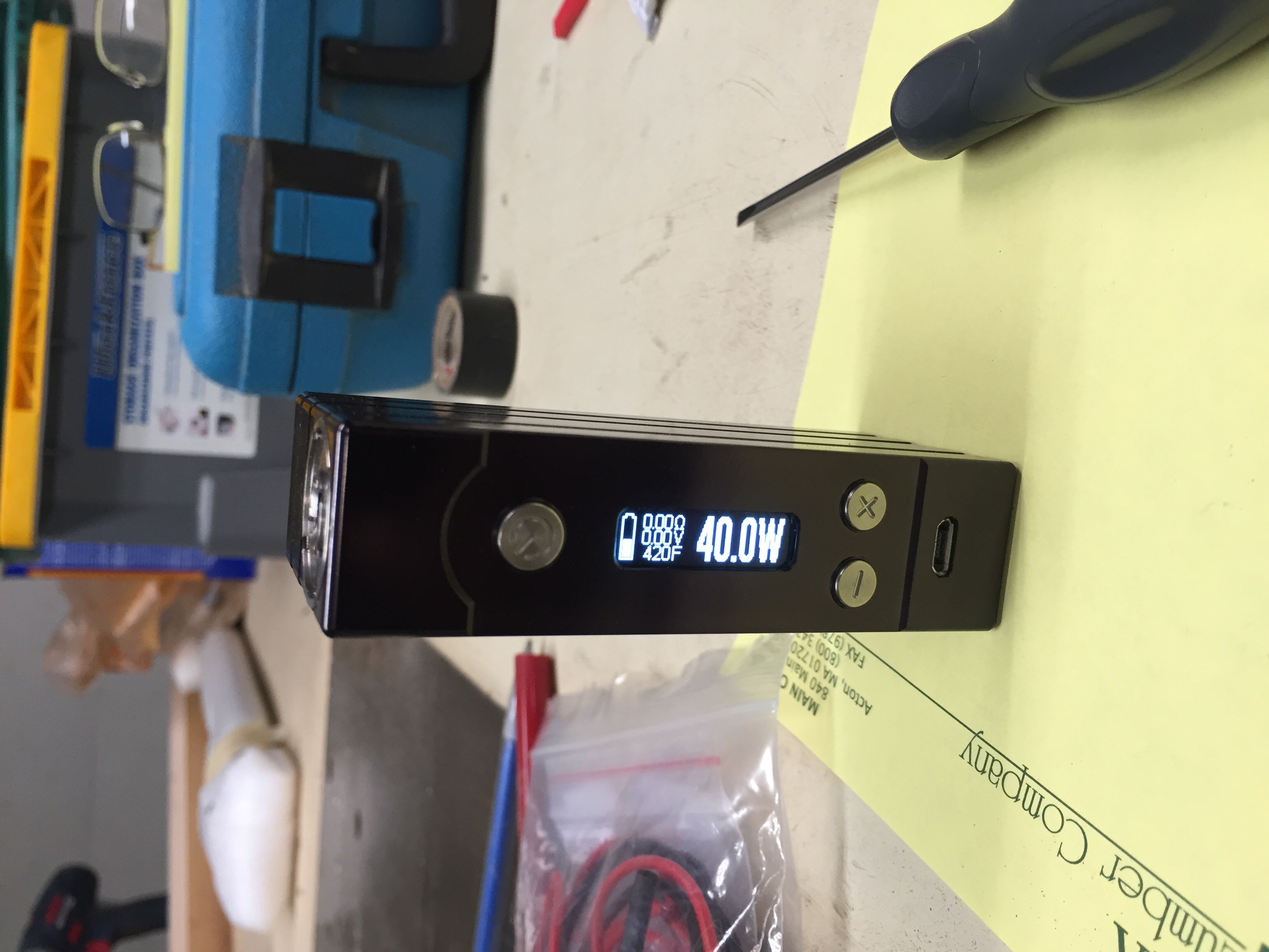

Yessss. Fixed my screen with one from another board that just arrived. Also added bullet connectors I took out of an xt30. Was a tight fit but in the end it wasn't much different space wise as the jst. Hopefully now there's no issues. Also lined the side of the lipo against the board and 510 with some thick rubber electrical tape.
