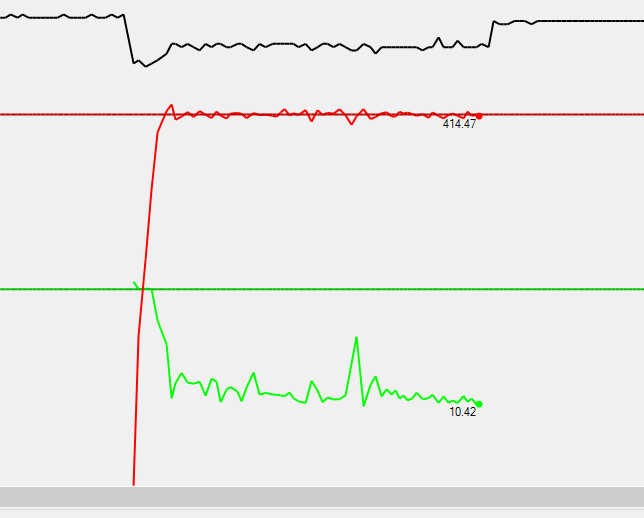

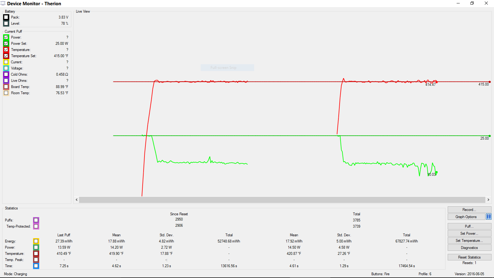

  6. You can see where I was running out of breath at the end of the puff but they look pretty good don't they?
  7. I figured it out like I say I am new to this stuff. But as you can see they both hold the temp pretty close but the Lavabox smooths out even better then the Therion
  8. I was using a setting of 415F and the watts were set to 25w
  9. The first one is the Lavabox the next is the Therion
