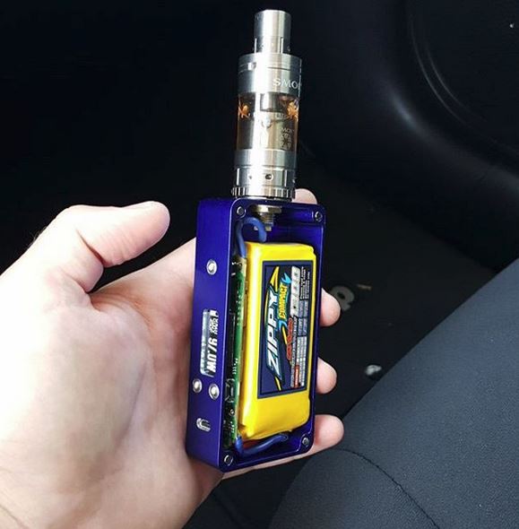

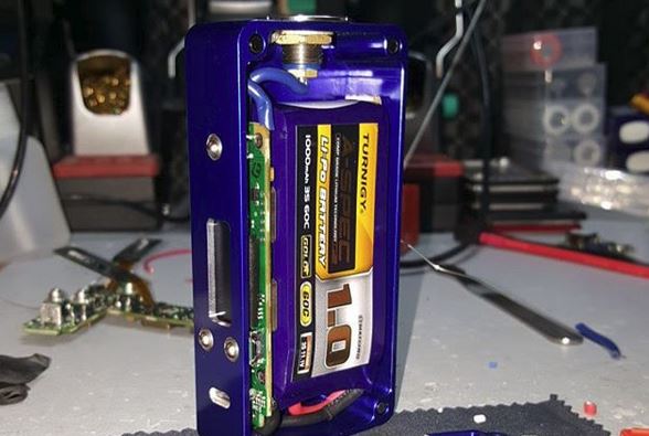

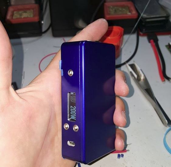

I've build around 4 1590B box's that battery will fit just fine.
Got a board back with burnt fuse. What would the mouser or digikey part be for a fuse replacement, I have already removed the blown fuse. I would like to replace the fuse myself as to not have the user wait a long duration. Update: I read the manual and it stated the fuse is manufactured by Schurter and the part number is 3413.0332.22 Mouser.com http://www.mouser.com/ProductDetail/Schurter/3413033222/?qs=%2fha2pyFadujkDmRci6X%252bAjZpKNMNNwxjncWzATFONlvFFtZLJI1Yww%3d%3d
I fit 2200mAh batteries in the hammond B boxs. Finished https://instagram.com/p/6Yp84WAWEc Basically the internals. https://instagram.com/p/545cYQgWPy

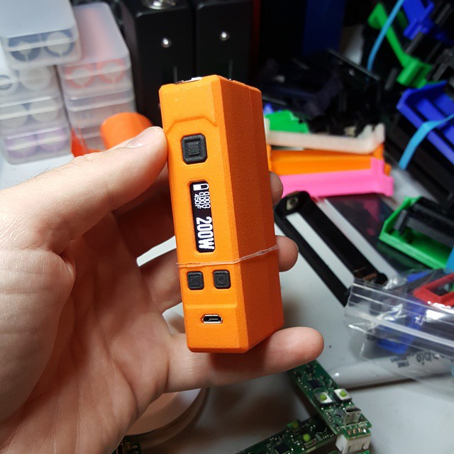

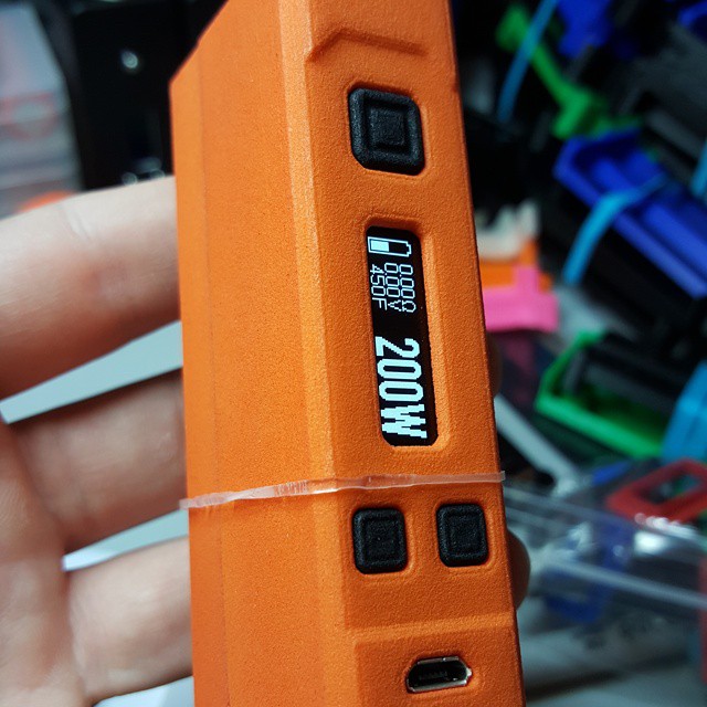

I have absolutely no concerns of users taking my approach in fact I condone it. At this point the tact switches I use have a surface area around the actual clicky push button. The hole I slide the tact switches into are VERY slightly offset to make contact with the surface area of the tact in conjunction allow the switch to be, again very slightly, held in place. The 14AWG ground wire holds the top portion of the PCB in place because of its thickness. The 510 + is looped so that when pressure is applied the PCB pad doesn't have any resistance and pull off the board. The bottom portion tact buttons UP and DOWN simply hold the bottom portion in place and the position of the charger connector holds the bottom. I then place a sized pad in between the battery and the pcb which holds the center and absorbs any press on the DNA chip. With this approach the entire construction has 0 Epoxy and 0 Glue. Enjoy -
Removing the DNA 200 Buttons and replacing with Tactiles
xevape replied to xevape's topic in Installation and Assembly
I'll leave this up to Evolv to answer definitively but I must state that once you remove buttons or do PCB work I'm assuming the warranty on the chip is void. As far as me personally I don't re-flow to remove items I re-flow for BGA issues. When working with a PCB and requiring removal of working items that are being replaced I tend to opt-out of heating other items on the board potentially causing failure. This instance I chose to do two irons and just touch all 4 points to remove the buttons. 10 boards doing just this took me 15 minutes for removal of all buttons. I then changed tips and found the exact point to snip the tact button legs so that when mounted the USB connector did not stick out. Lastly with 12 legs holding the board up I tested pressure Thank you @XEVape
