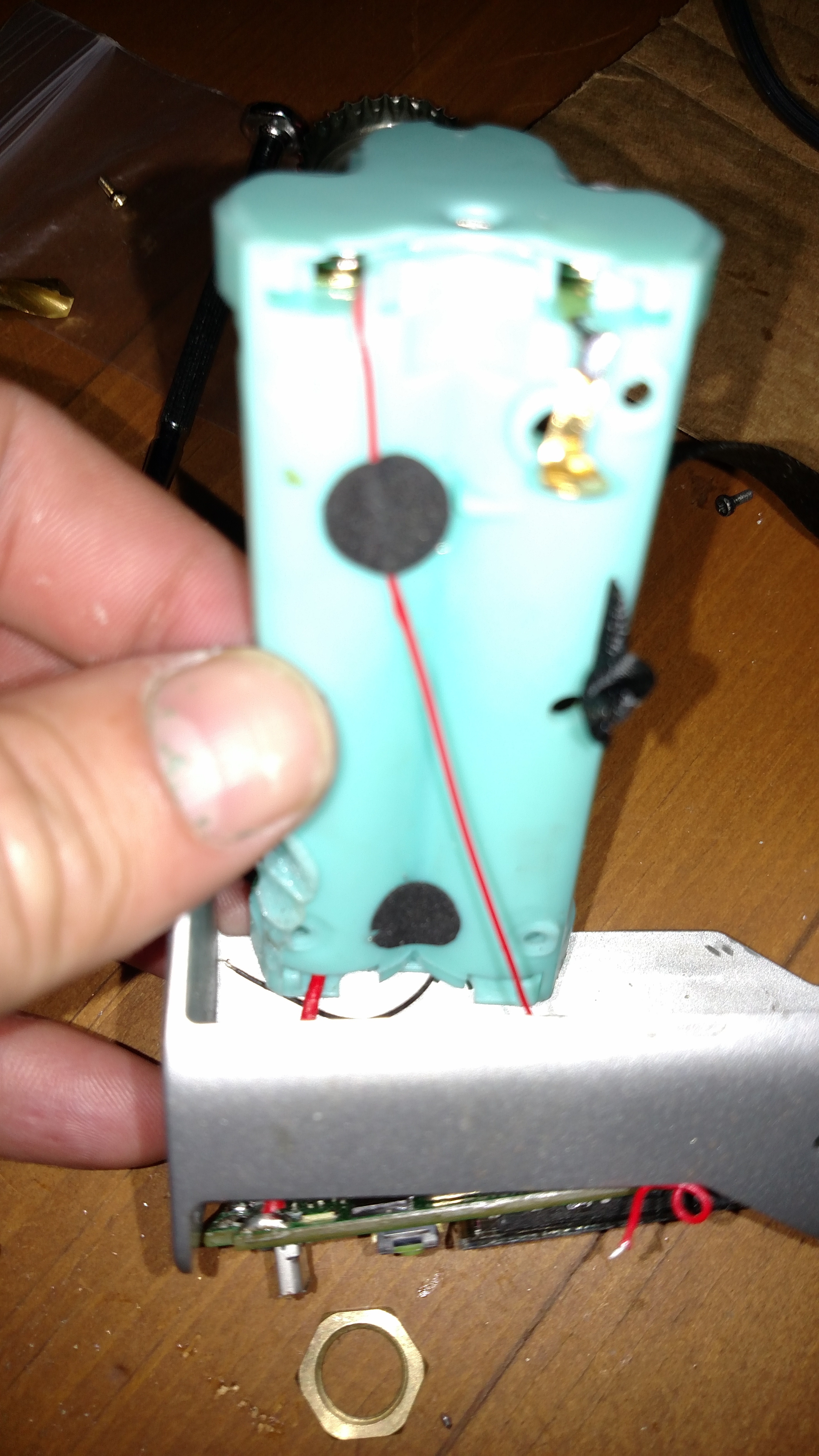

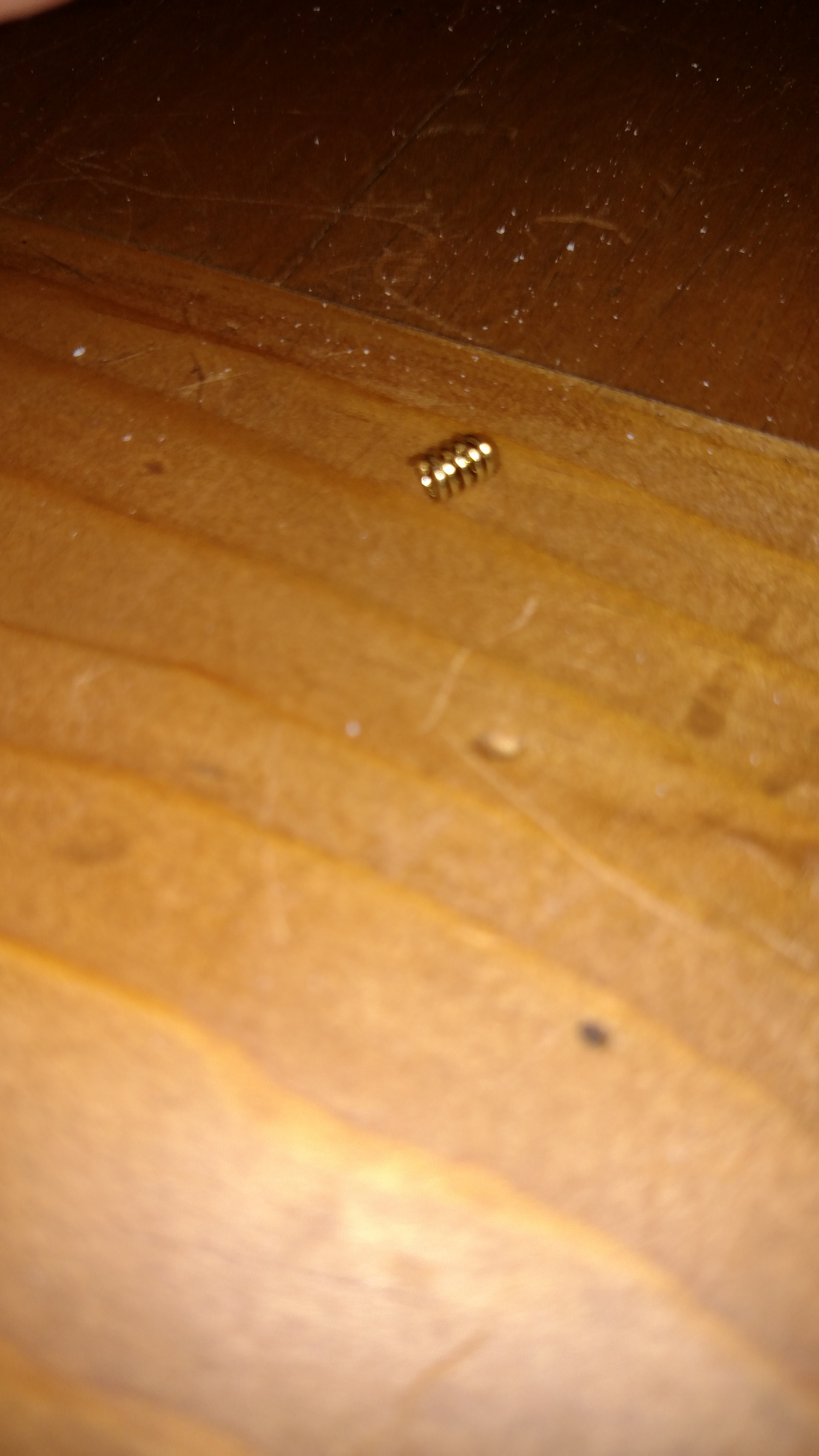

Random gold spring wismec dna 200
combatwombat replied to combatwombat's topic in Connectors, Components, and Accessories
Ya, it is kinda funny. I got it back together but had to change the ground to a 22 awg wire instead of the gold screw and bracket. I did change the 510 to evolv 510 so if probably did come from the shotty oem 510. Never take things apart after a BBQ party lol. Thanks for your guys help, I really appreciate yall. -
I have the two bigger silver springs for the negatives. Not sure about this one. -

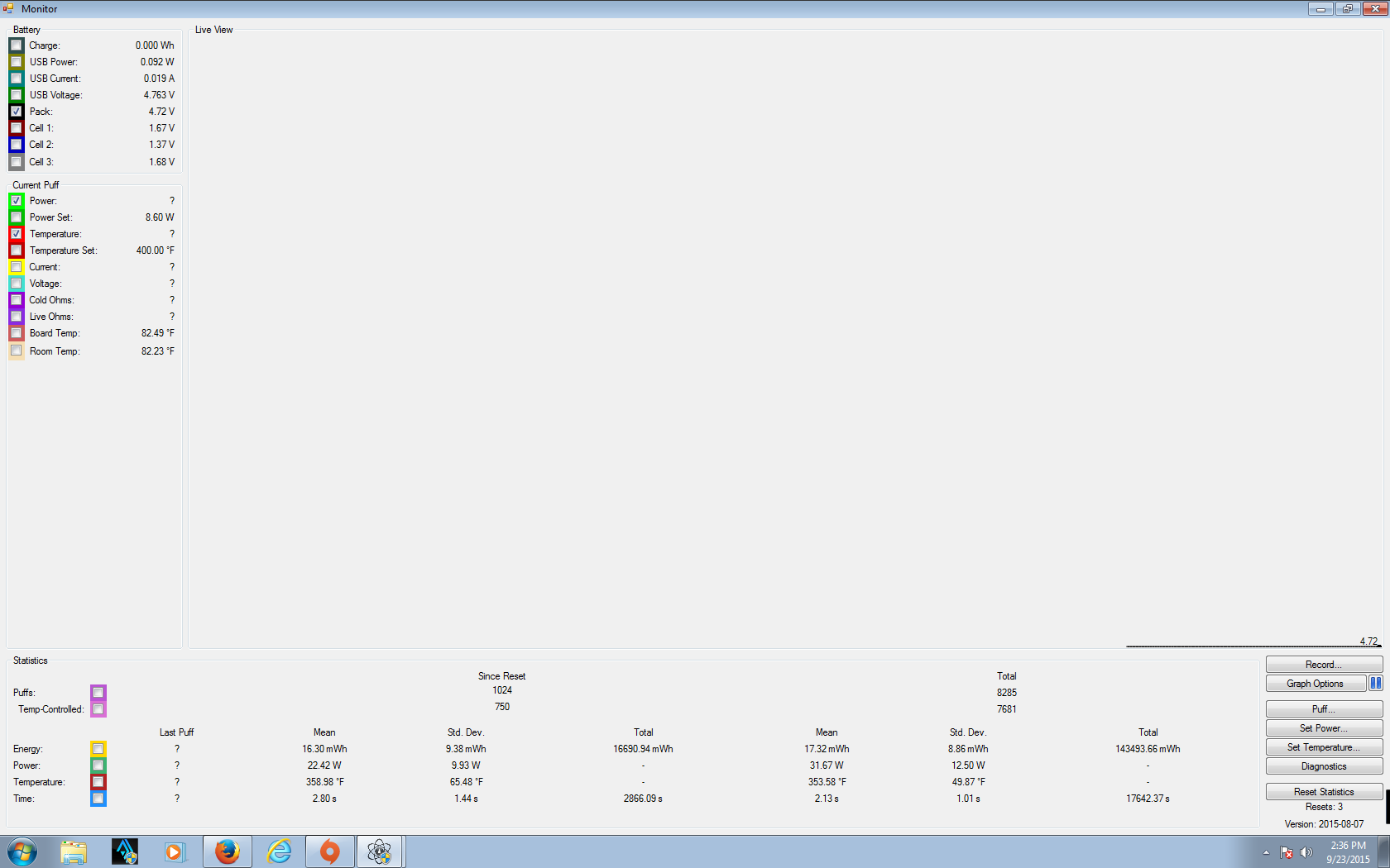

I have a 9.9v 1050 lifepo4 which is new and only cycled 2 times. I left it for a week and mabey the button got depressed but I hooked it up to charge and it wont charge and device monitor says pack is at 4.7v.... I had the soft cell cutoff at 2.7 so I do not see how this is possible without the board malfunctioning. -
