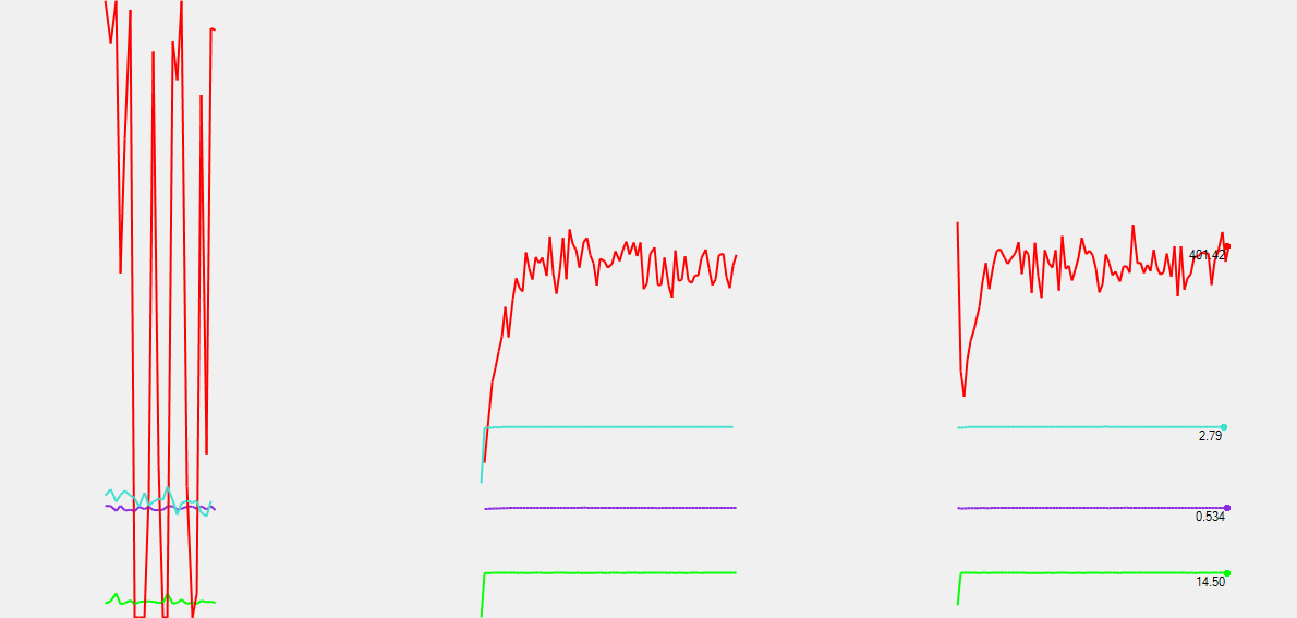

I would say yes. Even with low watts applied for 5 seconds, the cell in question drops immediately. This is image is 40 watts for 5 seconds:
So I have a device that I don't use much and was planning on storing it so, I wanted to discharge the lipo a bit. I plugged it into the device monitor and was pulsing in 30 second, 30 watt bursts. I started to see an "imbalanced battery" message and noticed that one cell held less voltage then the other 2. I allowed the battery to balance and tried pulsing again. The same cell drops immediately much lower than the other two. When I stop pulsing, the cell in question comes back up significantly but still well below the other 2. If I allow it to continue charging, the battery will eventually balance. I have 2 other identical DNA 200 devices that do not do this which makes me think I may have a bad battery cell. These devices are my only experience with lipo batteries so excuse me if I am missing something obvious. Battery with issue is the first image. Battery without is the second.

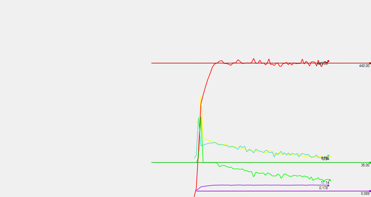

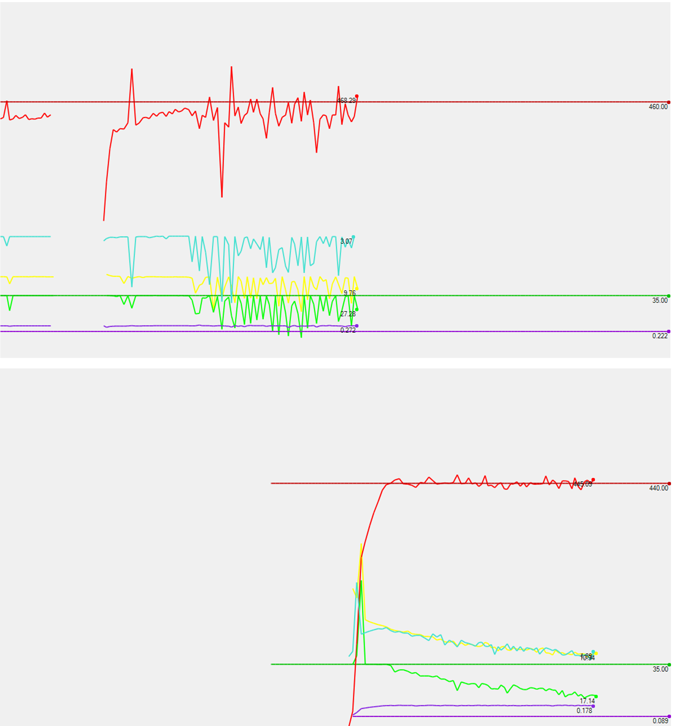

Same atty, same mod. Different wires & coil resistance. The mod is set to the correct wire when this happens. Take a look at how wire 1 bounces around when hitting temp and wire 2 is much more stable or smooth. Any idea why? I have ensured contacts are clean & screws are tight. If it matters, wire one is SS 304. Wire 2 is NiFe30. I should add that this atty has been consistent with NiFe. This is the first time I have used any other wire with it. I'm wondering if the atty being made of what I assume is SS430 is causing some sort of 'conflict' or if SS304 just isn't a good choice in wire? I have some titanium I've yet to try...

Well, that answers one question I asked in another post a moment ago. So if the build doesn't matter, should the atty make a difference? I am using 3 attys with the same NiFe30 wire from Stealth. One of the attys works fine, as I expect. The other two are bit moody. Starts out hot as hell & tasting burnt. Reaches temp limit almost immediately. If I keep vaping it, the temp settles down and is usable. This is with out changing any settings between switching attys. Hard booting sortta resolves the issue for one of the 3. I have another issue where the mod doesn't recognize the TC wire. Hard booting the mod via escribe ALWAYS resolves this.

I have several questions/problems that I can't seem to figure out. I hope someone here has my answers. 1.) When setting up a new wire, what is the best route? Using a TCR file from SteamEngine or using the wire wizard via SteamEngine. I notice when using the TCR, changing the resistance, changes the file's values. Using the wizard, the values appear to remain the same. Is this correct? Am I doing this wrong? I have tried both with the TCR files and the wizard with slightly better results with the wizard. 2.) I have setup 3 different types of attys. Each has the same wire type with roughly the same resistance. I have a profile setup using a wizard generated file. One of the attys seems work as I expect. Nice vape, not too hot.... When I switch to either of the other two attys, with the same profile, same temp setting, the vape gets very hot to the point that the wick tastes burnt almost immediately. Hard rebooting MIGHT resolve the issue for ONE of the attys but not all 3. If it makes any difference the 3 attys this is happening with are: Smok TFV4 <- Worst offender Tob Supertank RBD <-Works perfect (or as expected) every time Kanger mini <-Works most of the time I posted about this in another thread and thought it might get some traction as an admin here going by James asked some questions and for my settings file but I have not heard anything back. -
James, thanks for taking an interest. I have the default display changed so my device doesn't display the temp but rather battery charge. This change was due to the initial issues I was experiencing with the Hcigar's battery. This has been resolved by changing the default values as found elsewhere in this forum. My battery last all day now. As for the ohms changing, they do but I figured this was supposed to happen as this is how temp is monitored? The ohms seem to go up with use and back down as the device cools. Using the atomizer analyzer just now, this coil seems to be quite stable between .081 & .082. Firing it & they go up to ~.142 or so and drop rapidly when I stop firing. Atomizer Analyzer reads cold ohms @ .076 which I believe to be what it read when first installed. I have uploaded the escribe settings I believe you want. This seems to happen no matter which TC wire I am using but the last few days I have been using profile 2 which is NiFe30. When I notice it happen again, what do you suggest I do to record the occurrence for your purpose of troubleshooting? Many thanks for the assistance. This has been very frustrating as I thought I was doing something wrong. I have tried many different builds with several different TC wires. For some reason, I thought I'd try the Windows fix-all of rebooting and this seems to work every time. Go figure! escribe.zip

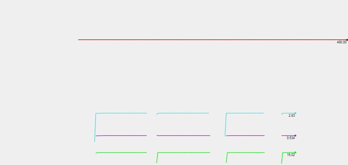

Yet another test convinces me there is something up with either the device or escribe: I attached an atty with an SS coil and switched to the appropriate profile. Temp control functions as expected and is reflected in escribe. Did the same with an Ni200 coil with the same results. Switched once more back to the Nichrome coil and escribe & the device seem to be functioning and registering temp as expected. What is the issue? I am running firmware 9-30 with escribe version 1.0.35.2.
Just after the initial posting above, escribe & the device are no longer registering temp? Nothing has changed. I set the device down long enough to write the post, finished and tried vaping again. The device vapes fine but not temp is being registered.
Wrapped my first coil with NiChrome 80. .52 ohms stable per the MOD and escribe. Uploaded the TCR from Steam both from the Wire Wizard and the old TCR. The coil is installed in a Kanger submini. Values loaded from Steam are: Temperature (degF)Electrical Resistivity-1000.98965118400.9957387237012001.0079133074001.019927866001.0329486278001.047827768 In device monitor, with temp monitoring mode enabled (temp limit disabled) the device/coil performs as expected. As soon as I enable temp limit, the temp registers all over the place which obviously cuts power to the coil. I have tightened both the coil & atty base several times to no avail. This is only happening with NiChrome. Any insight would be greatly appreciated.
