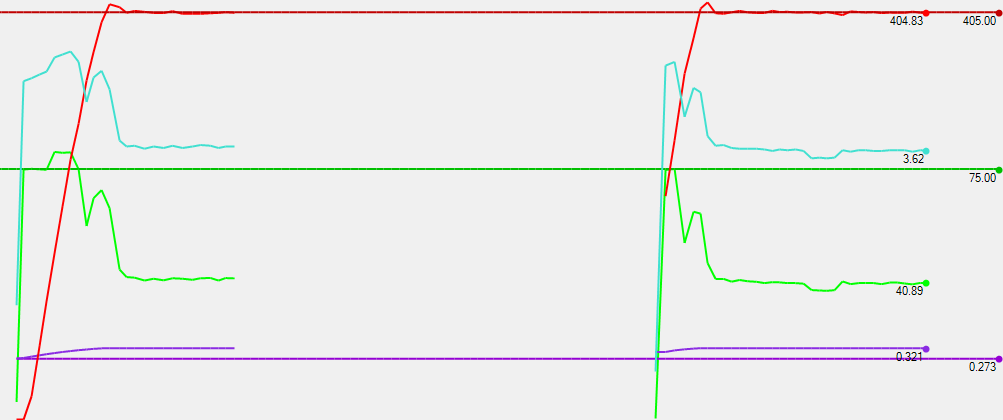

  6. I have to agree with Yoseff here. My therion came with all nickel presets although they were labeled as different wires. Assuming correct values are used, there's a very noticeable difference between SS & Nickel in regards to the graph and the right most value in the graph. LostVape did a poor job setting up this device. Out-of-box experience was crap and frankly, SS is on the DNA (and other boards) is crap. On both the Therion & the Hcigar VT75 I have. The chip just can't decide what to do half the time. My VT200 running sp2 however is working great with SS.

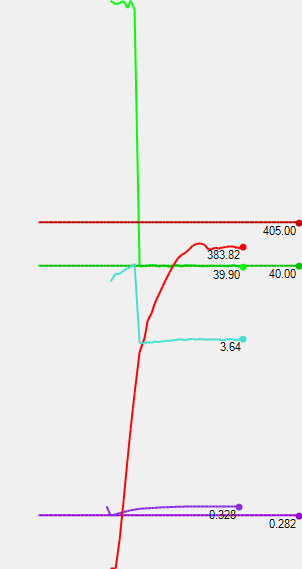

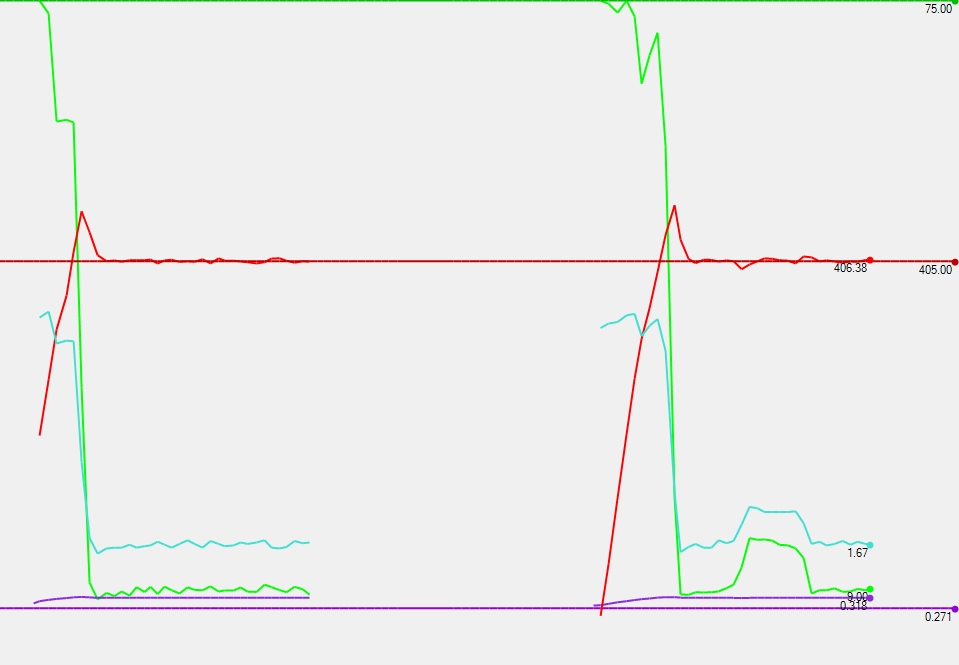

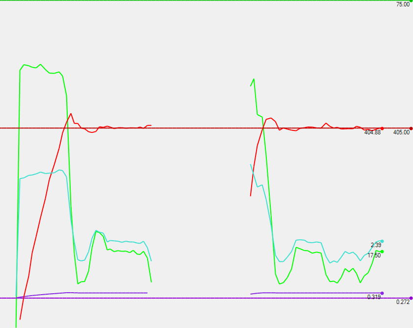

  11. Can't figure this out, hoping someone here has an idea. I have a DNA 200 running SP2 of the latest firmware. I have 2 DNA 75's running the latest 6/5/16 firmware. All 3 mods are using the exact same TCR file from SteamEngine for SS316L. All 3 mods have had the case resistance set using a copper plug. All 3 mods have had the case cooling analyzer run & settings adjusted. The screenshots are of each mod using the same atomizer with the same build. All 3 mods are using the same settings for the screenshots: 75 watts, 405 degrees, 75 watt preheat, punch set to 5 for 1 second. The 200 seems to run great. I love the vape. Warm, dense, & flavorful. The 75's are weak. I can actually detect the wattage cutting in and out once temperature is reached. I notice the same difference regardless of atomizer. My builds are usually about the same so initially I chalked it up to the atomizer and just increased the temp. Today I decided to compare the mods w/the same atomizer. For the screenshots, I had Escribe puff the mod for 5 seconds. The 200 levels out around 40 watts & 3.6 volts. The 75's drop to between 9 to 17.5 watts and 1.6 to 2.4 volts. The atomizer's 510 and the mod's 510 have all been cleaned with alcohol prior to the screenshots being taken. The build is a dual, SS316L Clapton coil, 26/36, 7 wraps slightly spaced. .27 ohms.

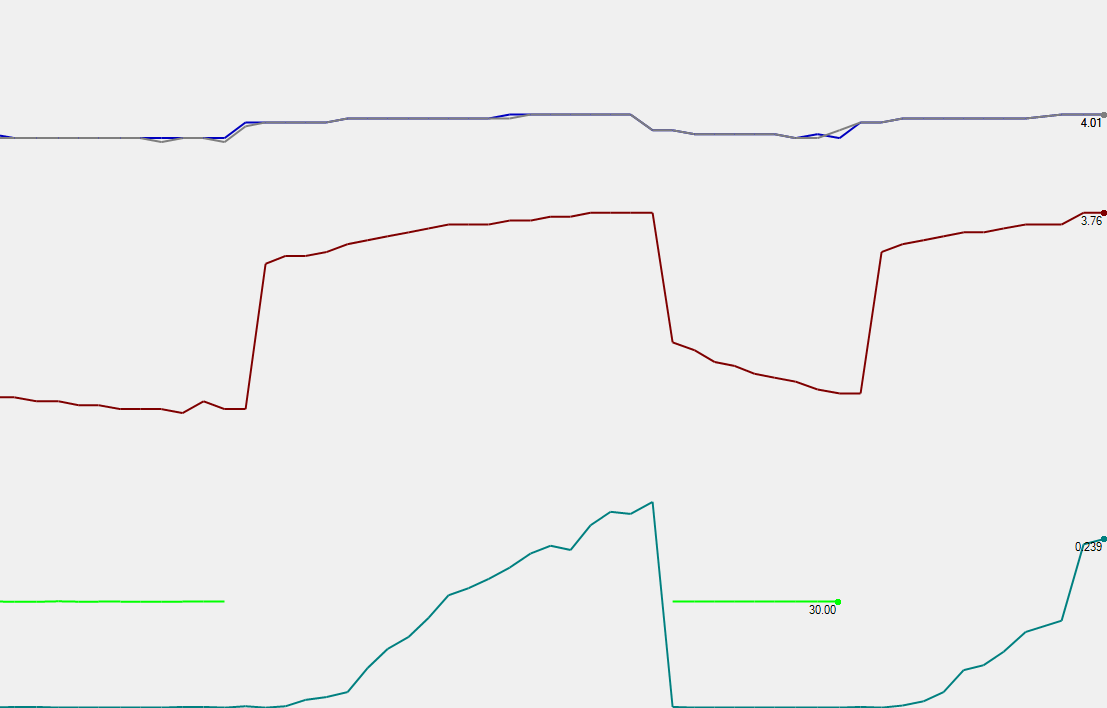

  23. I would say yes. Even with low watts applied for 5 seconds, the cell in question drops immediately. This is image is 40 watts for 5 seconds:

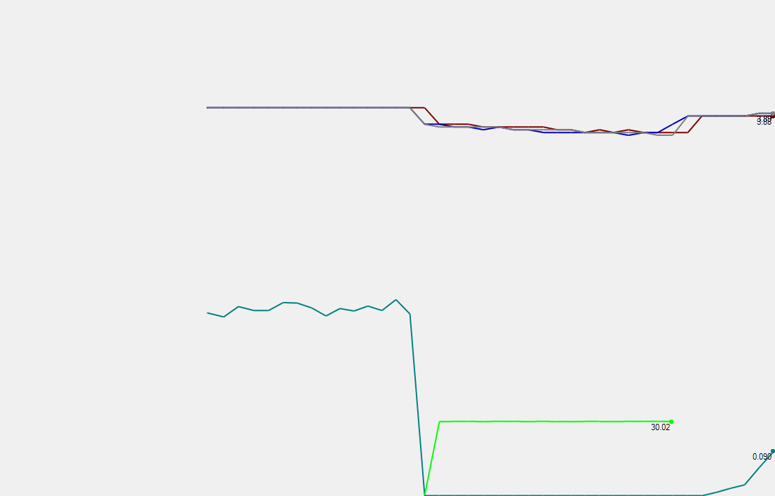

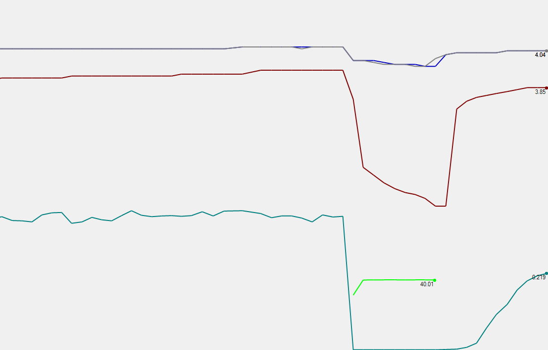

  24. So I have a device that I don't use much and was planning on storing it so, I wanted to discharge the lipo a bit. I plugged it into the device monitor and was pulsing in 30 second, 30 watt bursts. I started to see an "imbalanced battery" message and noticed that one cell held less voltage then the other 2. I allowed the battery to balance and tried pulsing again. The same cell drops immediately much lower than the other two. When I stop pulsing, the cell in question comes back up significantly but still well below the other 2. If I allow it to continue charging, the battery will eventually balance. I have 2 other identical DNA 200 devices that do not do this which makes me think I may have a bad battery cell. These devices are my only experience with lipo batteries so excuse me if I am missing something obvious. Battery with issue is the first image. Battery without is the second.
