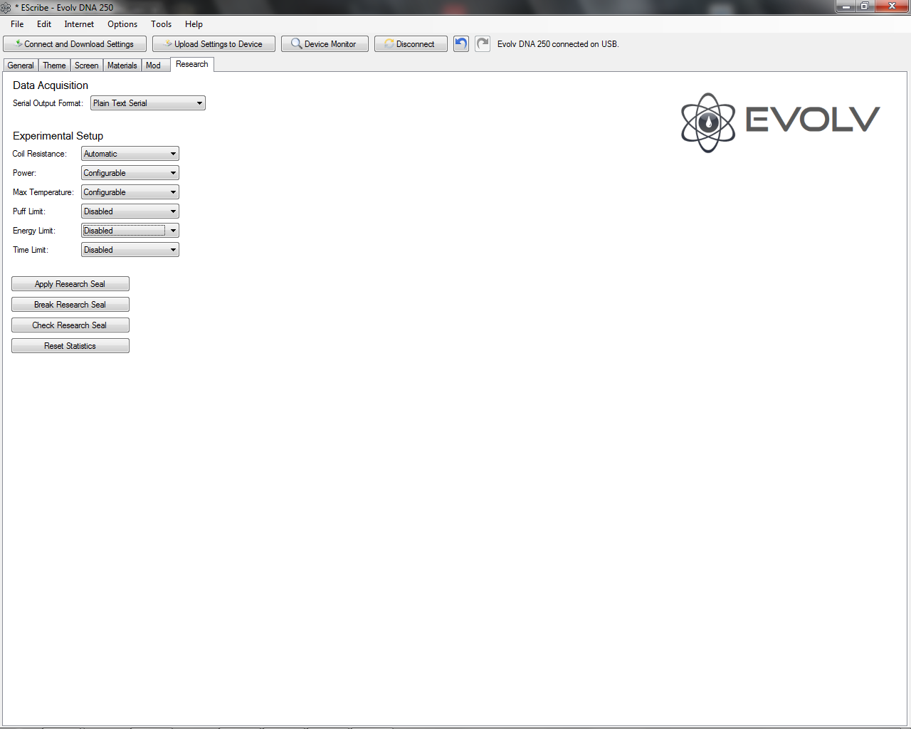

^ Agree. That thing needs connected to escribe. Options/User Interface/Manufacturer <--- Switch permissions to manufacturer, and then go to the research tab. There have to be some kind of parameters set, and if escribe connects to the board. It will download everything on the board and show you in escribe. If it's tripping the research mode screen then some parameter was set and needs cleared before it will do anything. Where did the board come from? This is the screen you want to look at.
