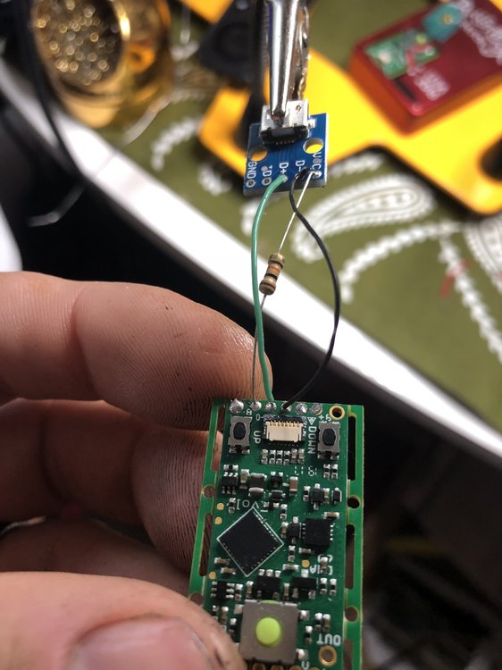

	  External USB Data Connection Trouble - DNA60greenj22 replied to greenj22's topic in Batteries and Charging Spector - Thanks so much! I think I figured it out and you are 100% right! I was expecting to get a connection without power going to the board, just as you would with the stock USB. So I connected the ground and a battery and I’m good to go!! Finally! Thanks for your input.
	  External USB Data Connection Trouble - DNA60greenj22 replied to greenj22's topic in Batteries and Charging Hi Wayneo, I have sorted out USB install in BB’s, but it is a fair amount of modding. I just wanted to try using different USB or taps that I could install with less modifications.
	Hi All, I have looked at, read, re-read, and been attempting to get EScribe/data connection using a generic USB breakout board. My understanding: From breakout board to DNA60: VCC to pin 15 via 10K ohm resistor Data + to pin 14 Data - to pin 13 @ChunkyButt200 can you please help? No connection. I’ve tried this several times on/off for a looooong time. Help is very-much appreciated in advance. And yes, USB cable is data capable.
	Yes - all you need to do is pin 1 (Down +) and pin 6 (up +) then the third wire is simply a ground and can be connected to any other ground/bat - pin (such as 2, 4, or 5). Cheers!
