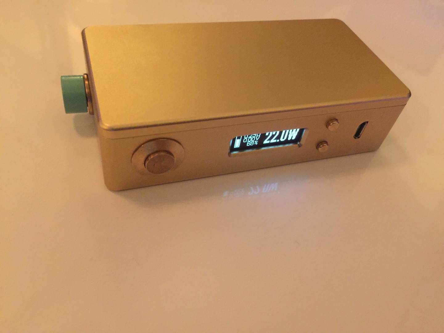

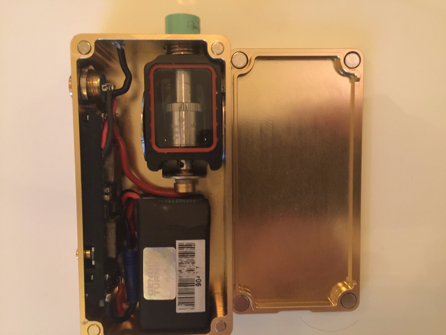

  19. DNA75 "Billet Box"...aka an AI-1 75

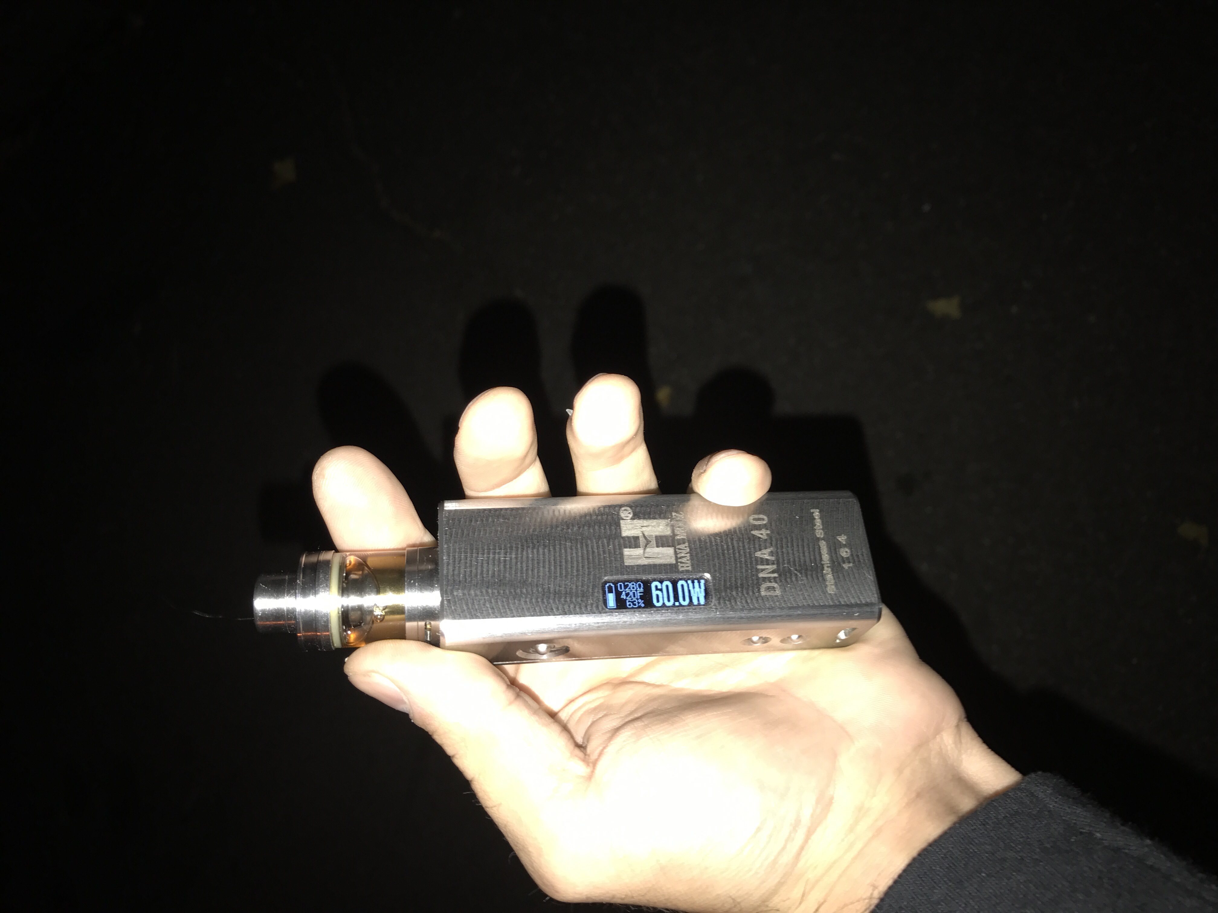

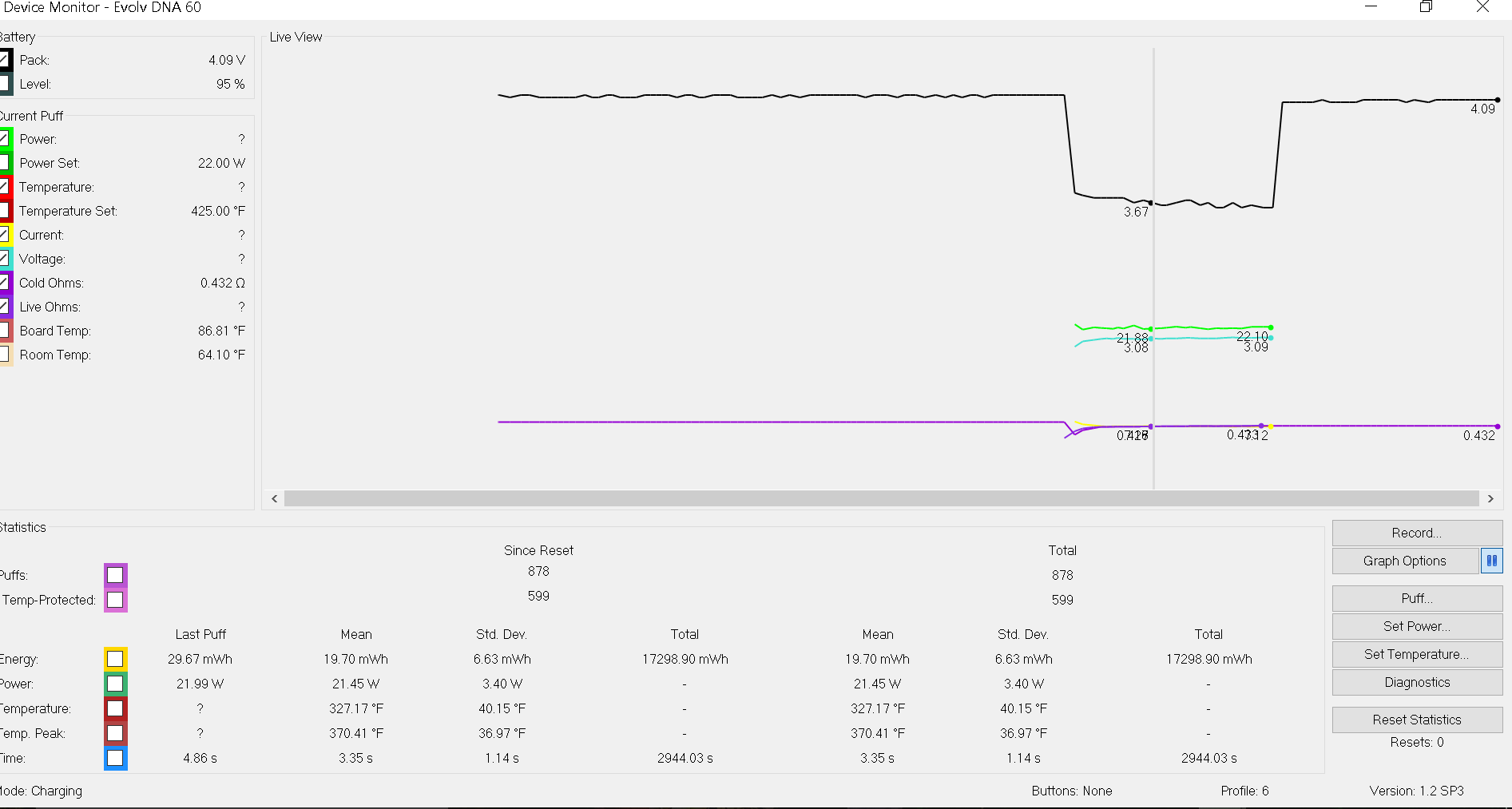

  25. greenj22
    Here you go. All seems to look ok to me in DM, but maybe I'm missing something......The 60 just doesn't vape the same under replicated function with a DNA 40. Idk....
