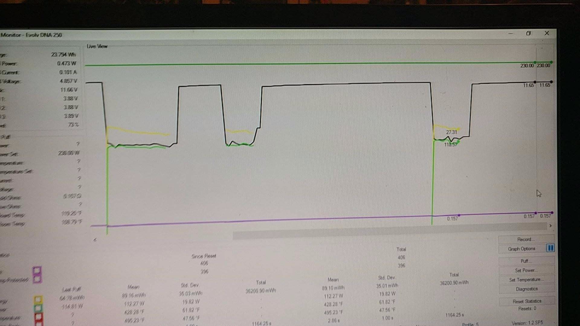

  7. I think I found the issue now, the board was limiting the watts due to the sag, when I dropped the cell cutoff to 3v it was reaching 140w, when I dropped it to 2.8 I started getting the check battery warning. The reason I didn't have this issue on my other mods is probably cause the boxer is better made so has a lower mod resistance. It's hitting harder so causing more sag than my other mods, time to upgrade the 30qs to some vtc5a
  8. Hi, I recently got a boxer triple Dna250 and for some reason it keeps limiting the watts to around 120w I've checked and kanthal limit is set to 250, I'm using stainless steel fused claptons in an aromamizer plus, no issue on any of my other dna mods, in a Ss tc profile I get no preheat and it stops at 120w, same in power mode. Anyone seen this before?
