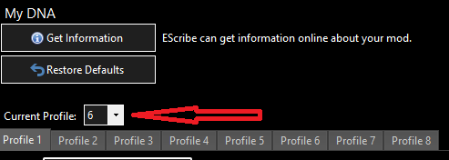

I don't have a 250C with batteries that can be taken out to charge. Never had this issue you describe. I did take the battery out of my 100C after changing profile from profile 6 (default) to profile 1 and waited 1 minute and put it back. No change in profile (still profile 1) so I took out the battery again and waited 10 minutes and hit the fire button several times (to discharge a capacitor if it exhists) before putting the battery back in. The profile reverted to the profile 6 (default) which was selected when I uploaded the device from Escribe. I mentioned a capacitor in the other thread. I went a step further and from default profile 6 I changed in on the device to profile 1. Took out the battery and hit the fire button 5 times and immediately put it back in (within 25 seconds) and the profile went back to profile 6 (default). I think this proves a capacitor stores energy for a short period of time while changing battery without loosing the current profile you set on the device..... My take: I uploaded profile 6 from Escribe as my most used profile. I call this the default profile. Change it on the device to Profile 1. So I still say what I said in the other thread about a capacitor. Taking out the battery and reinstalling different charged battery within a short time causes no profile change but waiting 10 minutes, or until you charge a battery(s) will cause the profile change you moved to to go back to the default profile you originally uploaded to the device from Escribe. Try this exercise and report your findings.... From ESCRIBE the arrow points to the current profile (default uploaded to device). The profile you moved to on the device is only saved as long as the capacitor has energy with battery not installed.
