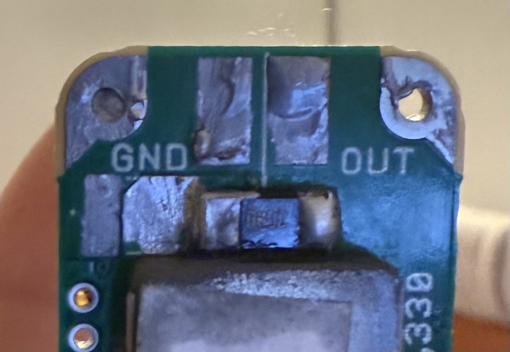

  14. I was soldering the ground wire of this DNA250C board but unfortunately my iron slipped and it bridged the 0m50 resistor and the 2 nearby capacitors. I managed to remove the bridge but the capacitors were also bridged to each other so I had no choice but to desolder them. Unfortunately in the process I think I damaged the board. The left pad of the capacitors is no longer a nice rectangle shape, it seems like it’s been scraped off — or maybe the solder mask. Either way I can’t solder it again because it’s touching the resistor. Anything I can do? I’d be grateful for any help.
