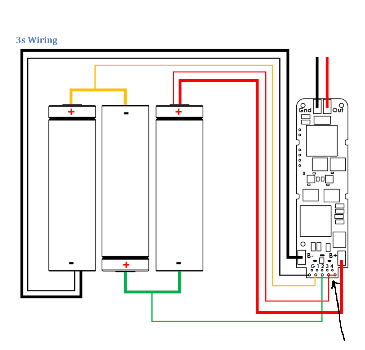

dwcraig1 Posted July 18 Report Share Posted July 18 Did you bridge balance tap connections 3 & 4 as shown here? https://downloads.evolvapor.com/dna250color.pdf 1 Link to comment Share on other sites More sharing options...
ultranothing Posted July 18 Author Report Share Posted July 18 2 minutes ago, dwcraig1 said: Did you bridge balance tap connections 3 & 4 as shown here? https://downloads.evolvapor.com/dna250color.pdf Here's what I did, as far as any physical hardware-type things: 1. I bought the new lipo 2. It had all the same connectors as the old battery (XT60 and 5-pin JST-XH) so I plugged them in. Link to comment Share on other sites More sharing options...
dwcraig1 Posted July 18 Report Share Posted July 18 Having a 5 pin JST makes me think that it is a 4 cell LiPo. Do you have a volt meter? Your Device Monitor shows 14+ volts so it's a 4 cell. I missed that earlier. 1 Link to comment Share on other sites More sharing options...

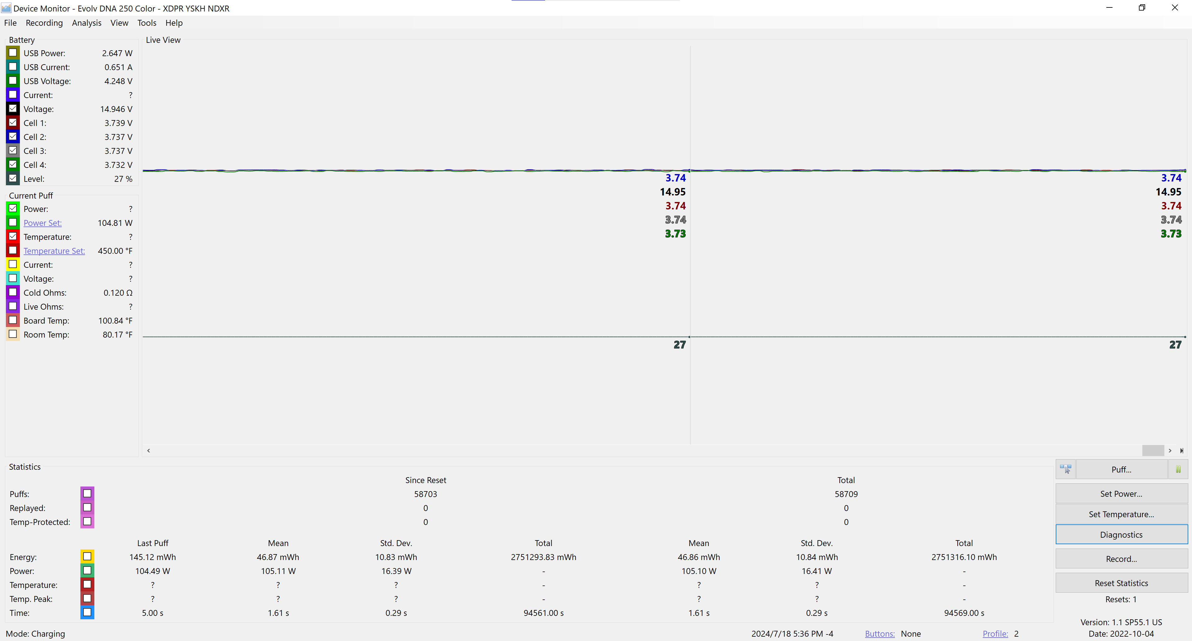

dwcraig1 Posted July 18 Report Share Posted July 18 When charging stops at 27% what is the USB voltage reading? You USB power looks really low, do you get the same reading for USB power when plugged into another USB port? Have you tried a USB charger block (wall charger)? Have you tried other cables? 1 Link to comment Share on other sites More sharing options...
ultranothing Posted July 18 Author Report Share Posted July 18 7 minutes ago, dwcraig1 said: When charging stops at 27% what is the USB voltage reading? Actually, it has now found its way to 34% and the USB voltage is reading 4.252 Link to comment Share on other sites More sharing options...

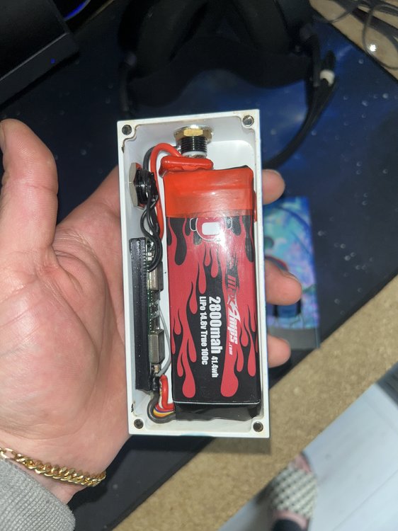

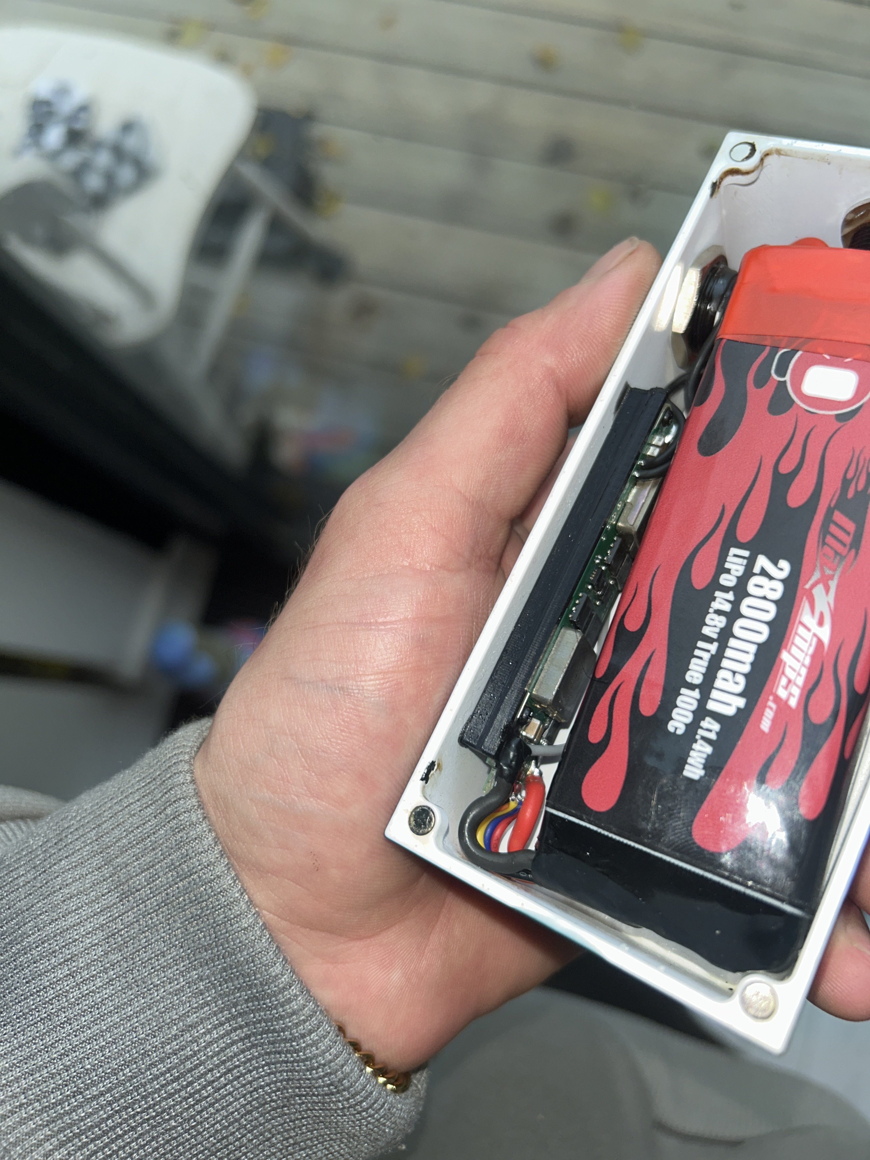

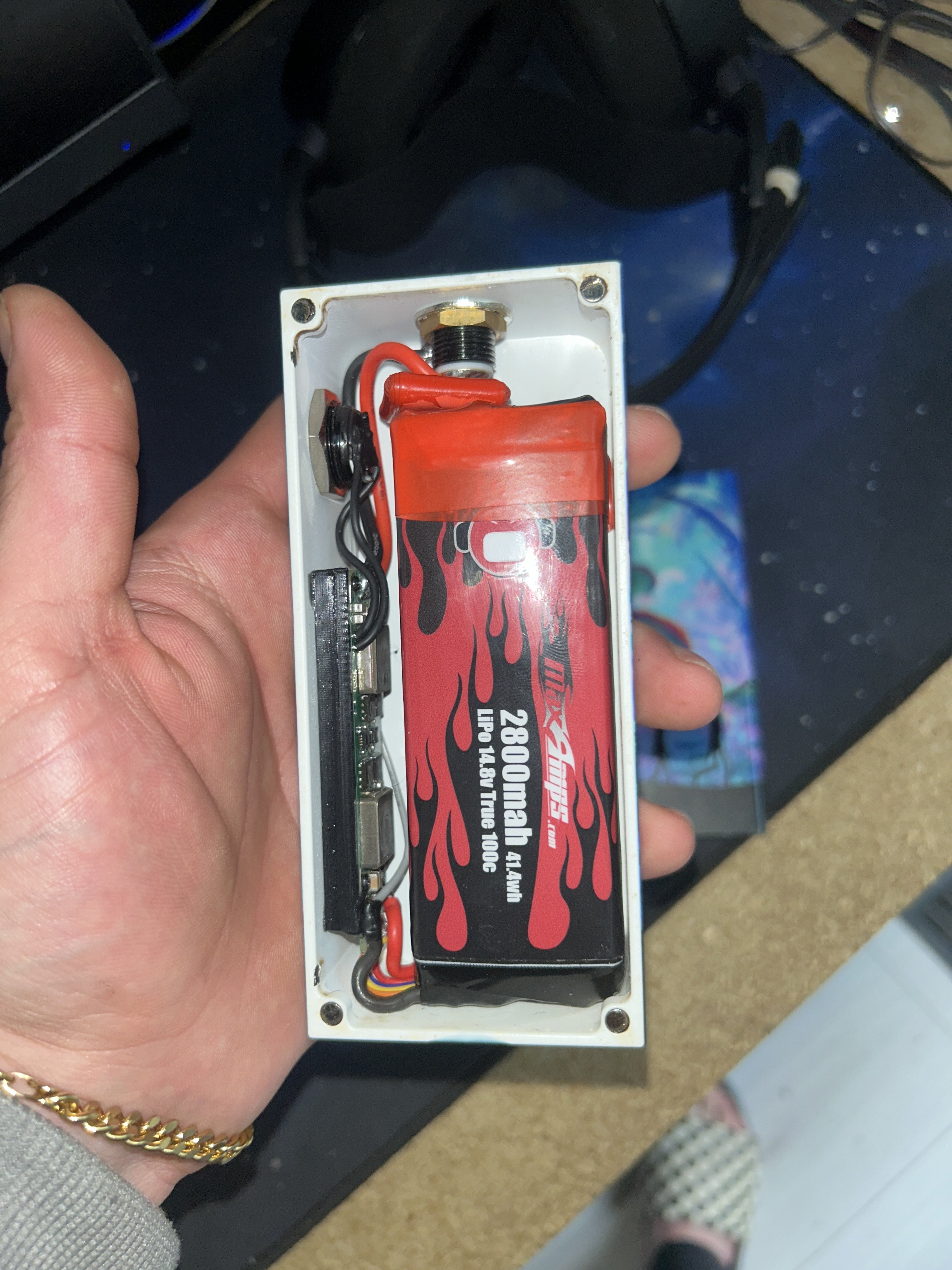

ultranothing Posted July 19 Author Report Share Posted July 19 I ended up taking it apart to get to the board so I could do some tweaking/crimping on the USB port. In the process, the solder point on the 510 broke off so I had to use some solder to solder the solder. The connection now is a lot tighter and seems to be more stable. I guess that the lesson here for future people who find this thread is: Mess with your USB port and ensure that it provides a tighter home for your charger - or just use an external lipo charger and save your fragile port. Link to comment Share on other sites More sharing options...
Wayneo Posted July 19 Report Share Posted July 19 38 minutes ago, ultranothing said: Mess with your USB port and ensure that it provides a tighter home for your charger - or just use an external lipo charger and save your fragile port. In just under 9 years of using DNA mods with built in batteries I have never needed to tweak/crimp my USB outer casing. The mere thought of using an external charger, removing the power and JST connector just doesn't seem practical to me. The odd time I had a loose connection, it was at the cable end. 2 Link to comment Share on other sites More sharing options...
ultranothing Posted July 19 Author Report Share Posted July 19 37 minutes ago, Wayneo said: In just under 9 years of using DNA mods with built in batteries I have never needed to tweak/crimp my USB outer casing. The mere thought of using an external charger, removing the power and JST connector just doesn't seem practical to me. The odd time I had a loose connection, it was at the cable end. Well, through my own negligence and many oversights, I've been a bit rough on mine. I can't tell you how many times, for example, either I or one of my kids knocked it **almost** to the ground before the charging cable saved it from crashing down, which you can imagine put a lot of force on the cable/port. And that's just one of virtually endless examples, now that I've taken the time to really look into this thing and honestly recollect its abusive upbringing. This was my fault. The board is fantastic and Steamcrave build is also top notch. There's no doubt my next device will be a 250c, once I finally and inevitably kill this one. Link to comment Share on other sites More sharing options...

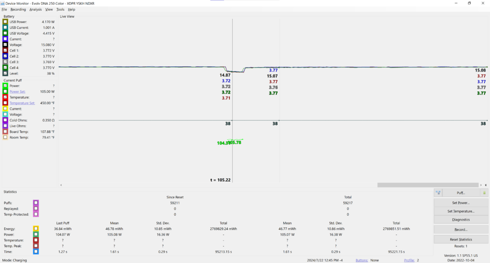

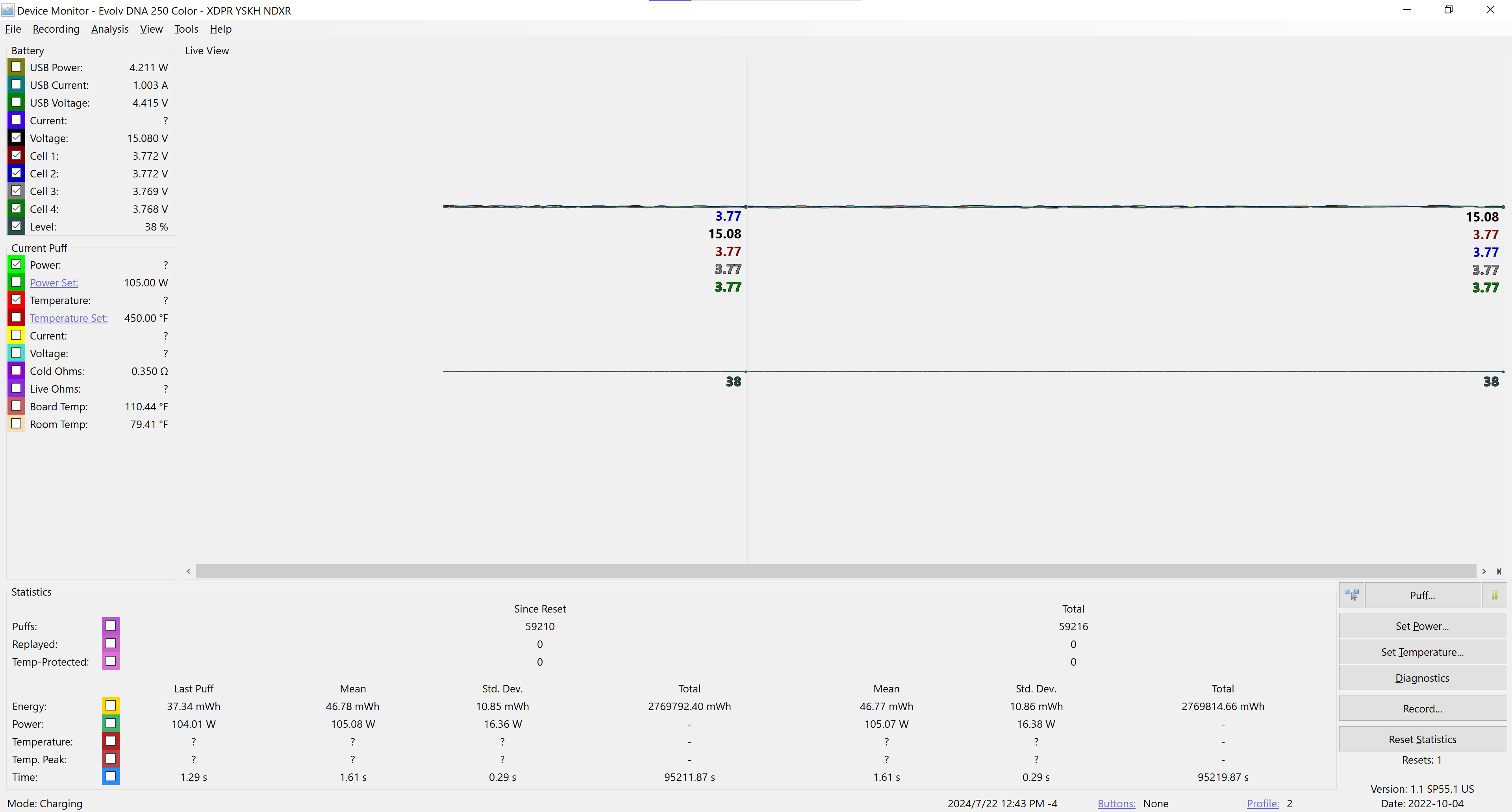

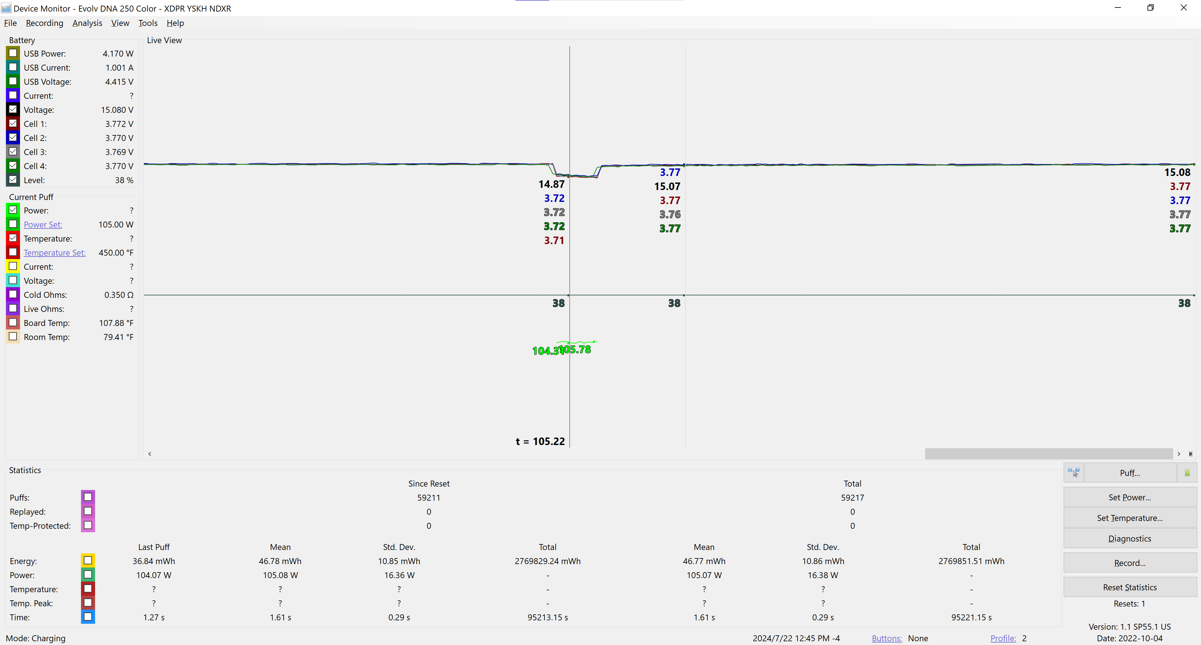

Wayneo Posted July 22 Report Share Posted July 22 Dude, can you post a Device Monitor screenshot. Don't take a puff or do anything. I'm looking at your 4 cells, and if they're relatively all the same voltage (batteries have zero clue about any %). After it's done charging, same thing except screenshot while taking a puff, and I wanna see the puff. Here I'm looking if one cell is noticeably weaker than the others. 1 Link to comment Share on other sites More sharing options...
ultranothing Posted July 22 Author Report Share Posted July 22 16 minutes ago, Wayneo said: Dude, can you post a Device Monitor screenshot. Don't take a puff or do anything. I'm looking at your 4 cells, and if they're relatively all the same voltage (batteries have zero clue about any %). After it's done charging, same thing except screenshot while taking a puff, and I wanna see the puff. Here I'm looking if one cell is noticeably weaker than the others. Yessir, here they are: Link to comment Share on other sites More sharing options...
Wayneo Posted July 22 Report Share Posted July 22 So far everything looks really good. 👍 See how during your puff, they're pretty much all equal in the amount they drop. While you are using the latest firmware, the US version limits new features for you. The 'INTL' has no limitations. 1 Link to comment Share on other sites More sharing options...

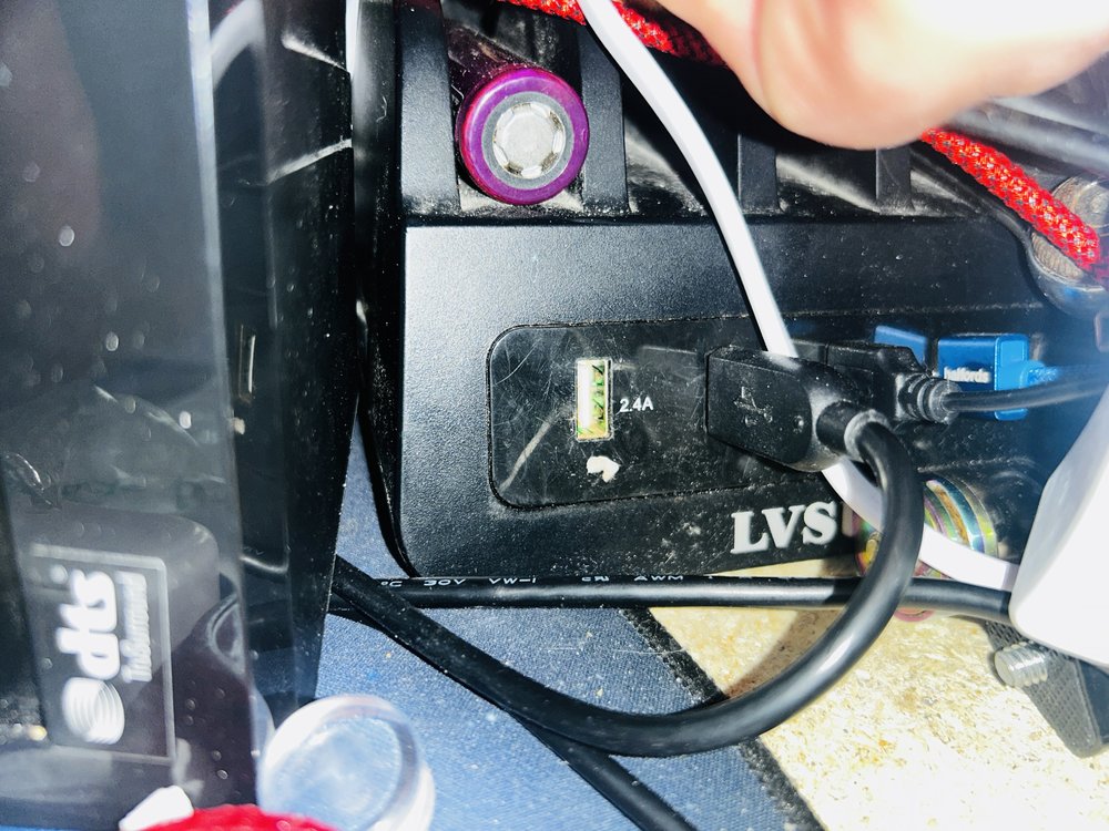

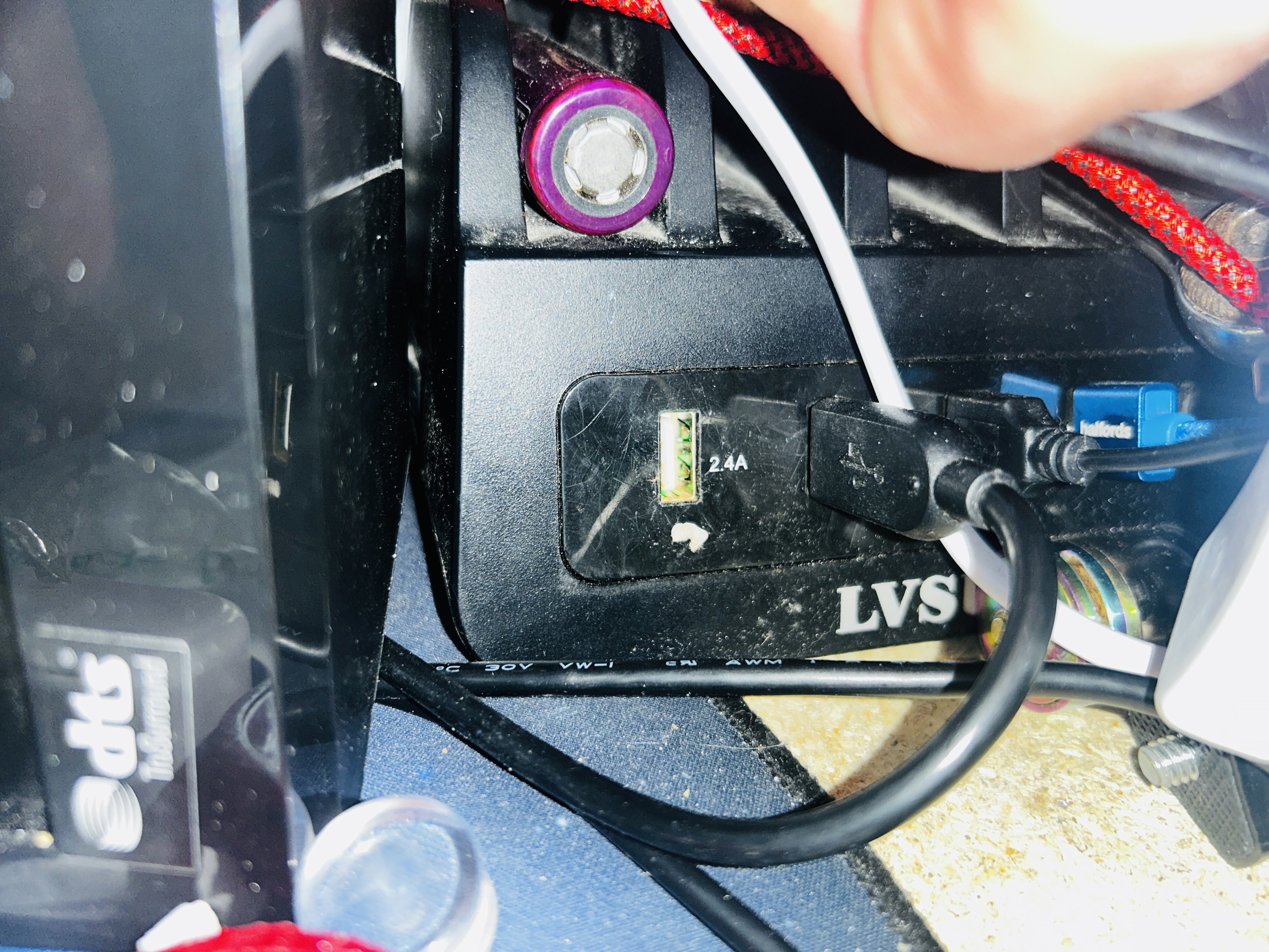

Lennox Posted Tuesday at 12:42 PM Report Share Posted Tuesday at 12:42 PM 1 hour ago, Wayneo said: I plug mine into the nearest outlet to me. You should take whatever safety precautions you believe necessary. I believe there are fire retardent charging bags sold but never heard of anyone using them, maybe you already use one for your current batteries. Perfect I have a usb charging dock I was thinking of using the slower speed on that ? I thought it’s at least lower that directly to the wall, how low are you letting your battery get before charging I was thinking about 20 percent or are you guys draining to 1 ? Sorry for all the questions I’d rather ask than not know my beast just arrived I’m so excited usb charger dock says 2.4a Link to comment Share on other sites More sharing options...
Wayneo Posted Tuesday at 01:15 PM Report Share Posted Tuesday at 01:15 PM 2A charging is the Max, limited by the board, no matter what steamcrave says 🤔 and that’s shared by 4 cells, so that’s really only .5A per cell. Link to comment Share on other sites More sharing options...
Wayneo Posted Tuesday at 01:19 PM Report Share Posted Tuesday at 01:19 PM You can let your batteries run down to the Low battery warning. That all depends on your vaping style. Link to comment Share on other sites More sharing options...
Lennox Posted Tuesday at 01:32 PM Report Share Posted Tuesday at 01:32 PM 14 minutes ago, Wayneo said: 2A charging is the Max, limited by the board, no matter what steamcrave says 🤔 and that’s shared by 4 cells, so that’s really only .5A per cell. So it would only draw 2A from the charger? or are you saying the charger being 2.4A is too much and I shouldn’t charge on that I could look at the output of a xbox and charge on that I’d imagine that’s lower Link to comment Share on other sites More sharing options...
BillW50 Posted Tuesday at 01:52 PM Report Share Posted Tuesday at 01:52 PM (edited) It works like this @Lennox. Even if you use a 100A charger, it still will only draw 2A. You can use less than a 2A charger too. It will only draw what it is capable of supplying if less than 2A. It will take longer to charge of course. Edited Tuesday at 01:53 PM by BillW50 2 1 Link to comment Share on other sites More sharing options...
Lennox Posted Wednesday at 08:33 AM Report Share Posted Wednesday at 08:33 AM 17 hours ago, BillW50 said: It works like this @Lennox. Even if you use a 100A charger, it still will only draw 2A. You can use less than a 2A charger too. It will only draw what it is capable of supplying if less than 2A. It will take longer to charge of course. I’d just like to let everyone know how helpful you’re advice has been and how thankful I am, you have made things a lot easier to understand I had a defmod but the battery was a solid connection and I wasn’t aware of the differences between lipo and 18650 and how they need to be charged and how they discharge and unfortunately that mod is stuck at 3 percent and won’t accept any charge, I’m thinking of possibly putting my own balance cable and power cable into it maybe in a few months after some more research hopefully that is a possibility because it would cost me too much to send back to the original country for them to repair and pay for postage back to me, just another thank you to all who offered their advice 1 Link to comment Share on other sites More sharing options...
