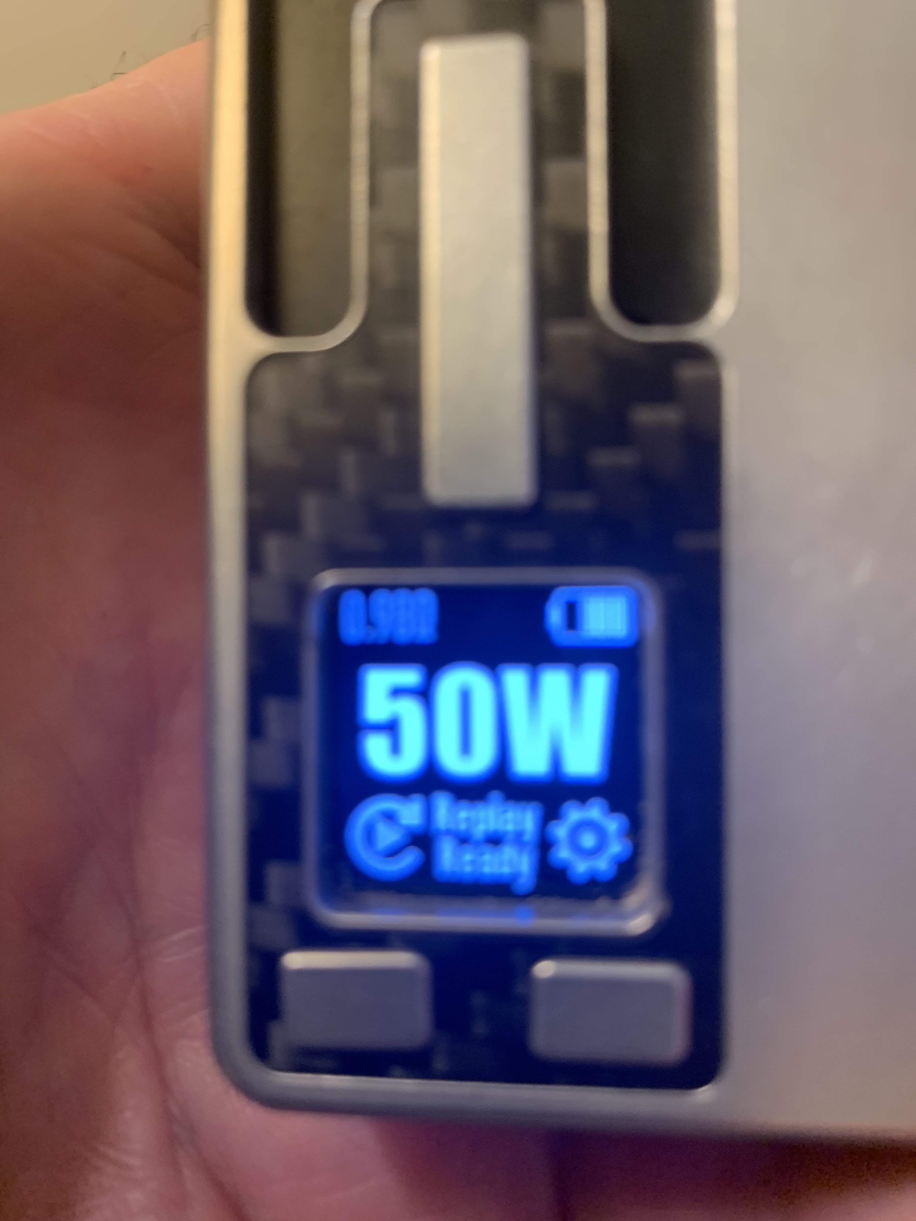

Vapors Tongue Posted June 22, 2024 Report Posted June 22, 2024 Have i found a bug ? Cant seem to get replay to work at all , i get the ready text when i enable it nothing , disable replay i get wattage again. I'm using SS fused Clapton's and before that i had fused Clapton wire in it. any suggestions.

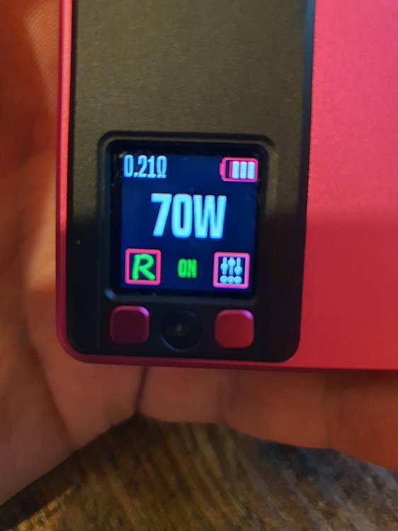

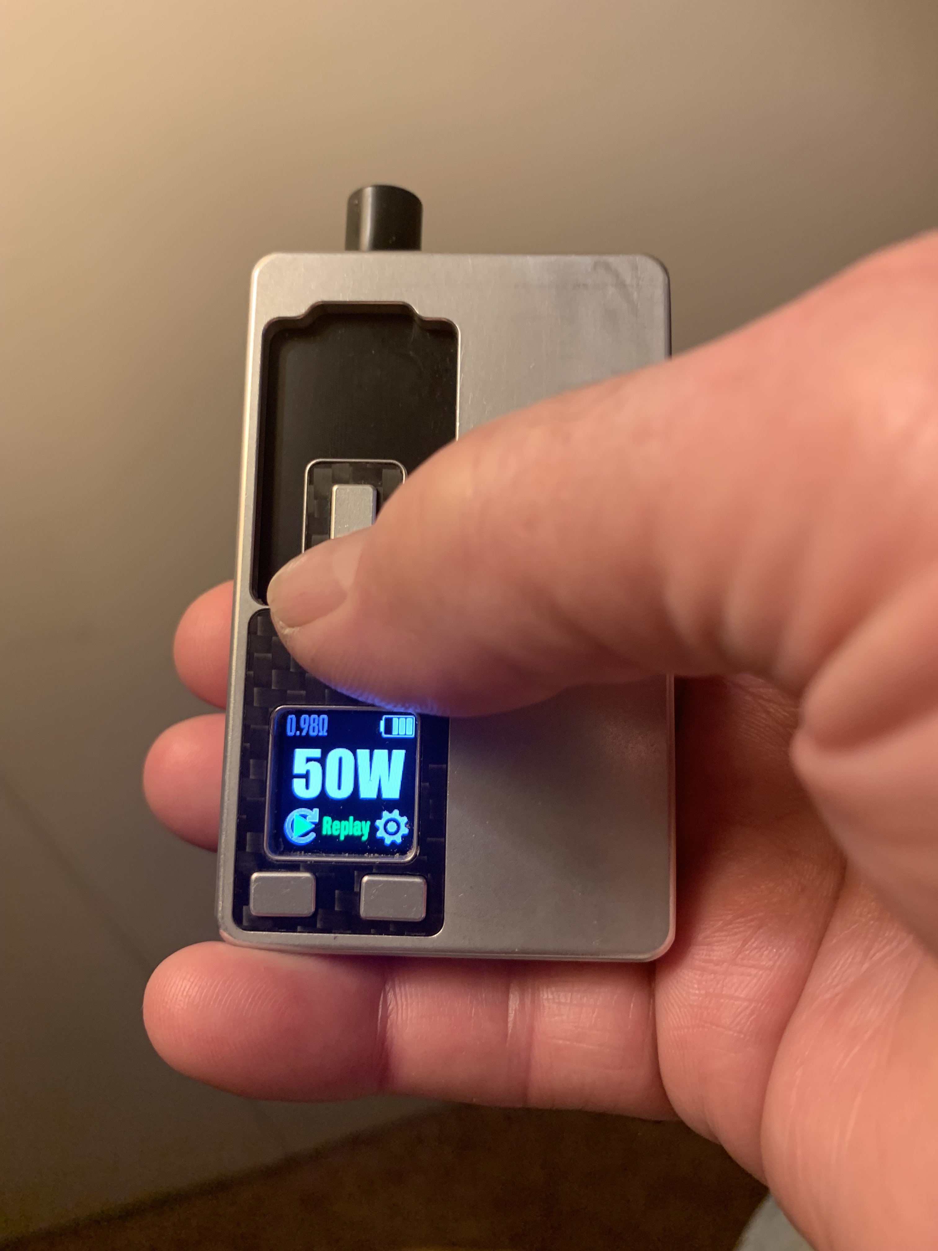

dwcraig1 Posted June 22, 2024 Report Posted June 22, 2024 Here I have my 80C with a Triton 1 ohm Kanthal coil. Without highlighting Replay icon I take a puff during which it says "Firing". When I release the fire button it says "Replay Ready". I highlight the Replay icon and hit the fire button, now it says Replay in green bottom center. It is now Playing. The DNA80C will Replay just about all coils whether TC wire or not. 1
Vapors Tongue Posted June 22, 2024 Author Report Posted June 22, 2024 everything is working up to the bottom photo you have shown, when i press fire again i get check atomizer constant , let go of the fire button it say ready again. i have to move the select click the replay icon and disable and it fires back into wattage. I've hard rebooted the device , applied the service pack , restored defaults , changed themes and it acts the same no matter what i do

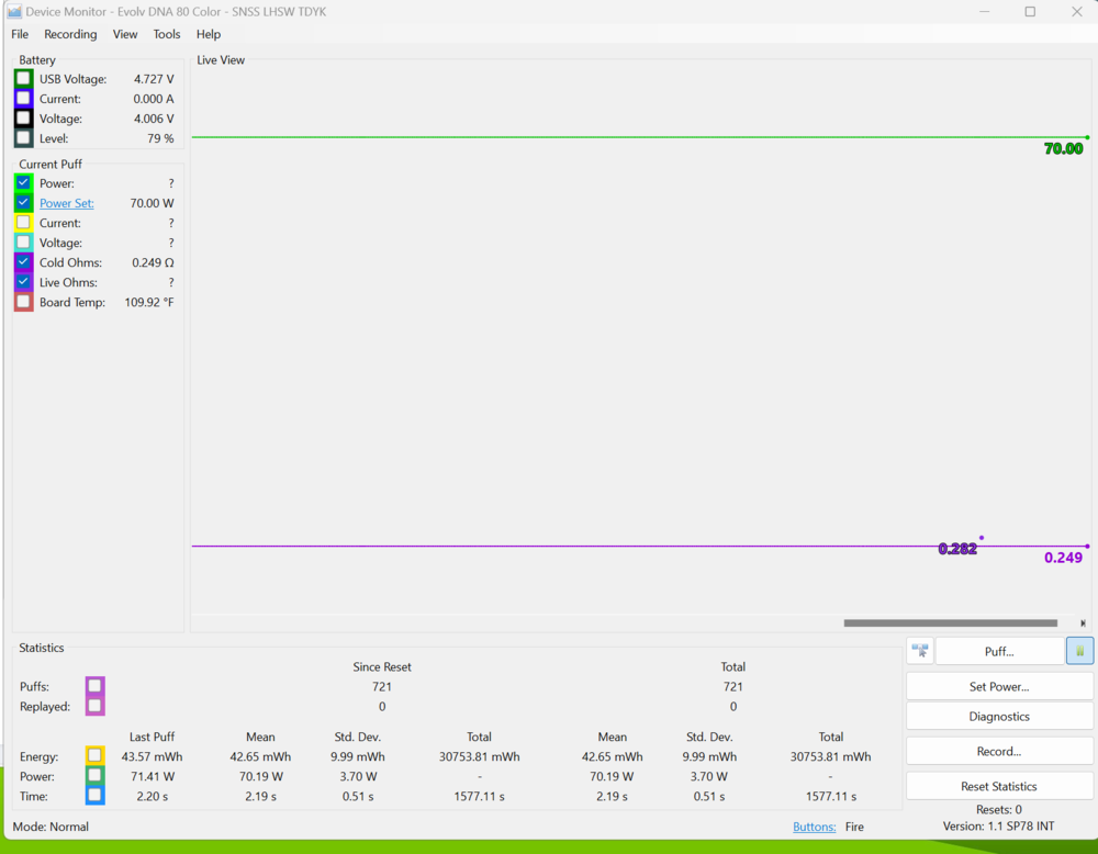

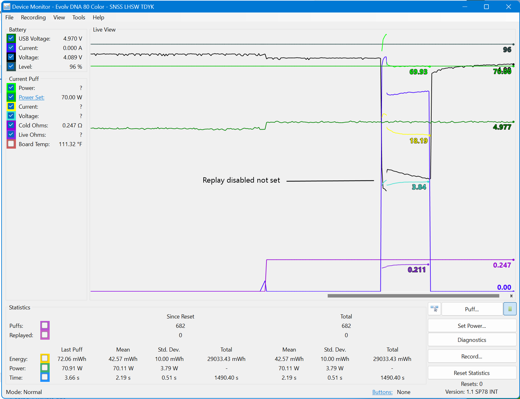

dwcraig1 Posted June 22, 2024 Report Posted June 22, 2024 When using EScribe's Device Monitor does your cold ohms vs live ohms appear as expected? Could you post a screen firing in wattage mode? 1

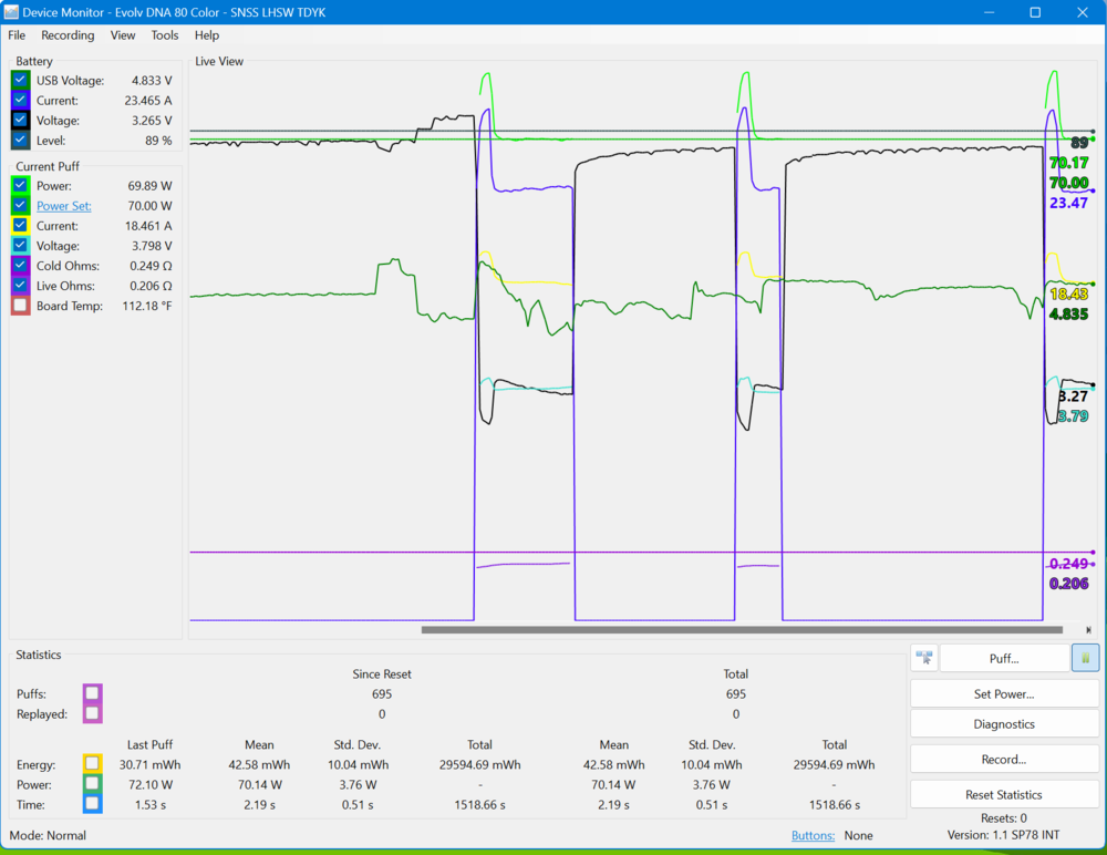

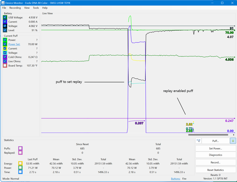

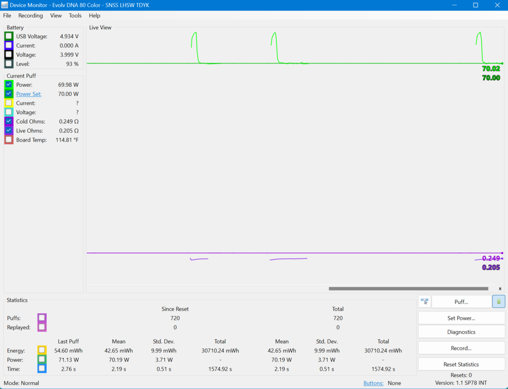

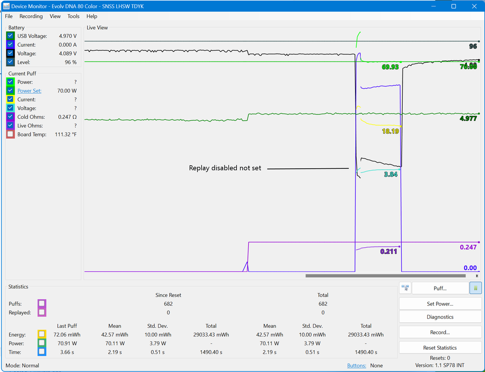

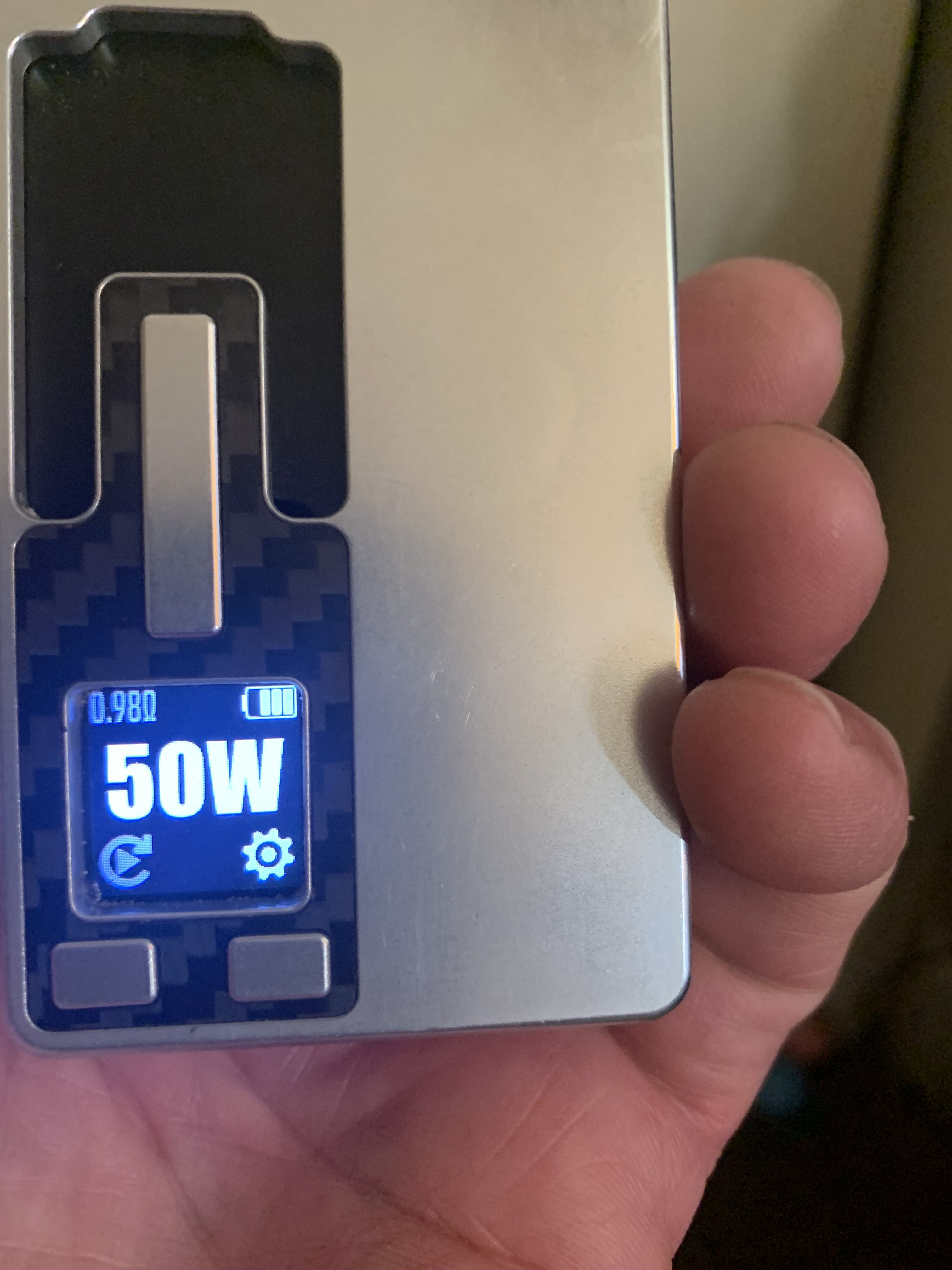

Vapors Tongue Posted June 22, 2024 Author Report Posted June 22, 2024 posting 2 pics here one labeled wattage and the other replay when its supposed to be firing in replay mode but i get check atomiser message and i get nothing
dwcraig1 Posted June 22, 2024 Report Posted June 22, 2024 1st picture looks as expected, 2nd picture I have no idea what is causing that. If you purchased it locally you might try contacting them otherwise open a ticket with Evolv or StealthVape
Vapors Tongue Posted June 22, 2024 Author Report Posted June 22, 2024 1 minute ago, dwcraig1 said: 1st picture looks as expected, 2nd picture I have no idea what is causing that. If you purchased it locally you might try contacting them otherwise open a ticket with Evolv or StealthVape ok will do , the place i bought it from have sold out of the colour i have so that's probably going to be a hassle as id want the same colour back .. lol i was going to buy another anyway before i noticed this , it happened from the very first day but i was using just normal kanthal wire and i thought i will try again with SS coils in it to make sure and it did it again. why I'm here now. might have a word with Vaperz Cloud see if they will swap it even though i didn't buy it direct form them. then if that fails i will open a ticket but i will know for sure if i buy another in the meantime. thanks anyway 1
Wayneo Posted June 22, 2024 Report Posted June 22, 2024 8 hours ago, Vapors Tongue said: posting 2 pics here one labeled wattage and the other replay FYI, We can't see labels or filenames. 8 hours ago, dwcraig1 said: When using EScribe's Device Monitor does your cold ohms vs live ohms appear as expected? And this answer should have been 'no'. The 'live ' ohms need to rise above cold. So my question is do you have any other rba's you can try? And what rba was that? Or, can you remove the boro, reboot device, put the boro back in, monitor some of your puffs and ONLY looking at live and cold ohms, do you ever see live > cold. If Yes, try to enable replay at that point. 2
dwcraig1 Posted June 22, 2024 Report Posted June 22, 2024 Yes I truely missed that the live ohms were lower than the cold ohms. I'm glad Wayneo caught it. 1

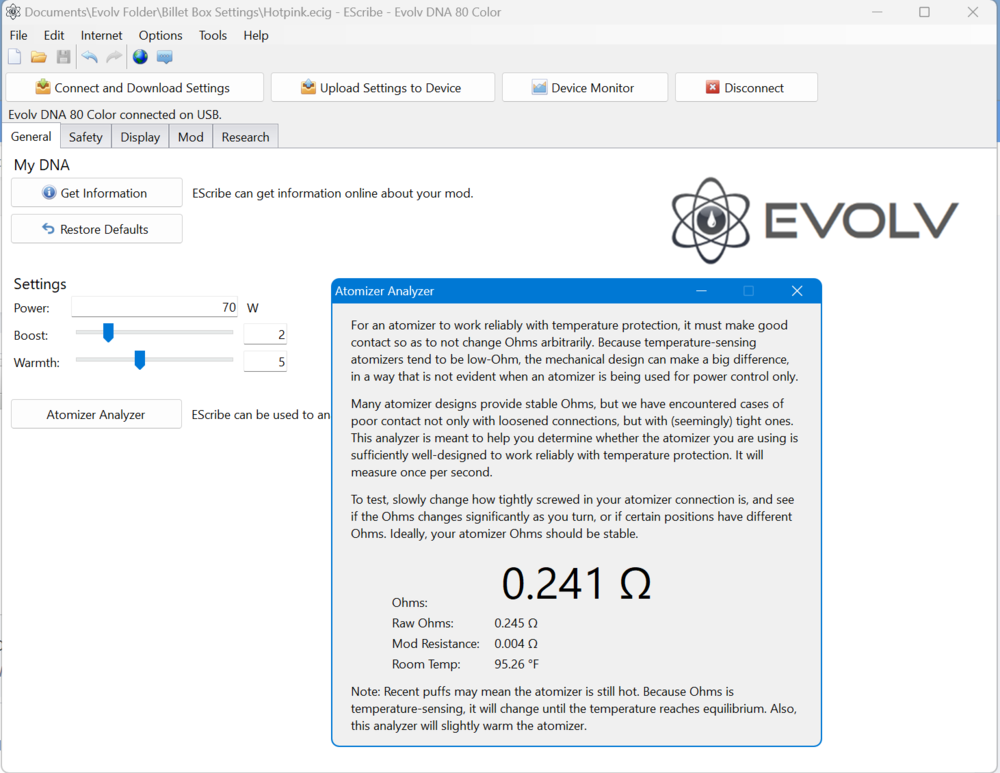

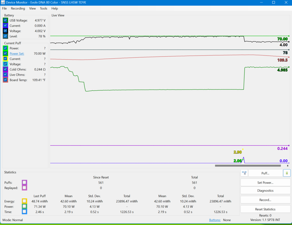

Vapors Tongue Posted June 22, 2024 Author Report Posted June 22, 2024 also a pic of the atomizer analyzer
Vapors Tongue Posted June 22, 2024 Author Report Posted June 22, 2024 i can only see live ohms when replay isn't set. as soon as set reply after the first puff , the live ohm's show but briefly disappears as it says check atomizer so unable to capture
Wayneo Posted June 22, 2024 Report Posted June 22, 2024 Live ohms never greater than cold. Not gonna work in Replay. I don't have either of those RBA's and also never encountered that issue in 6 months of using the 80C, even using Ni80 and Kanthal in Replay and about 6 different RBAs. I don't think it's a board issue, more a device issue. VC should definitely be interested to know or Evolv might figure out what's wrong and inform VC. One question, did you move 'warmth' to 5 or did it come like that? 1
Wayneo Posted June 22, 2024 Report Posted June 22, 2024 Enabling every single checkbox only muddies the screenshot. At most power, power set, cold ohms, live ohms. 😃 1

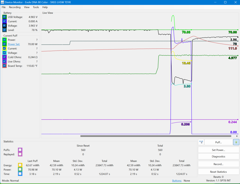

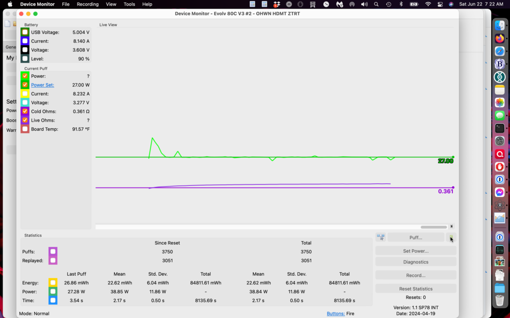

Wayneo Posted June 22, 2024 Report Posted June 22, 2024 Just did a puff. Notice my cold ohms/live ohms. That's in Replay. 1

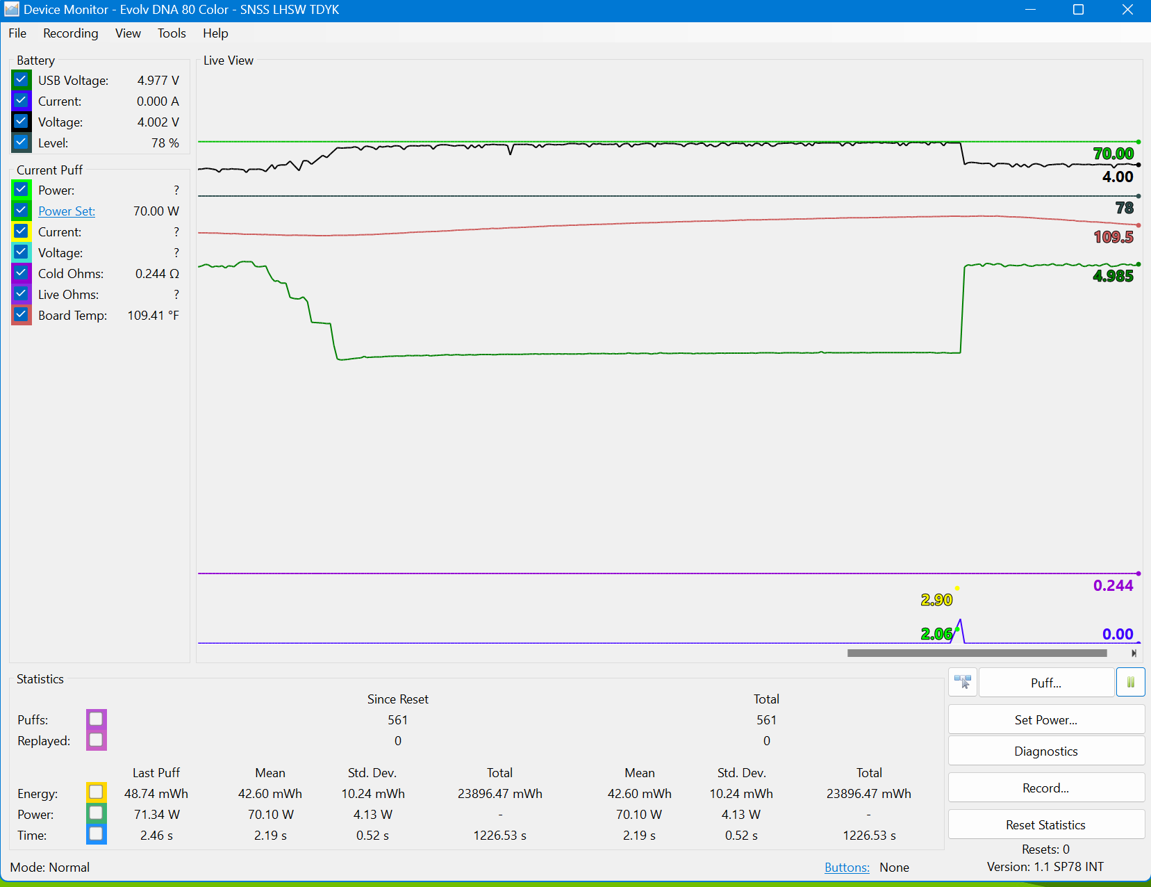

Vapors Tongue Posted June 22, 2024 Author Report Posted June 22, 2024 top screen replay not set , bottom screen replay set . nothing but fresh air and the atomizer error message
