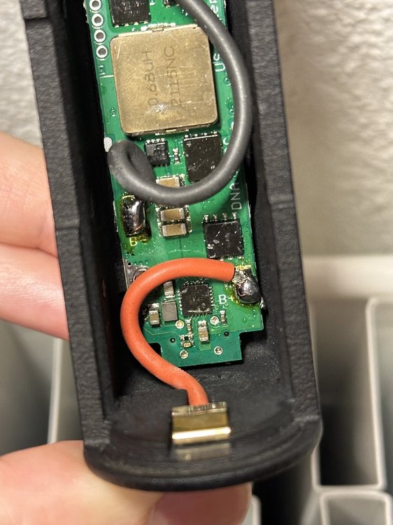

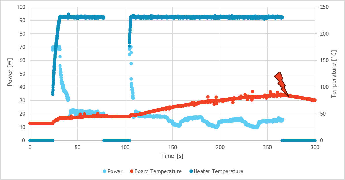

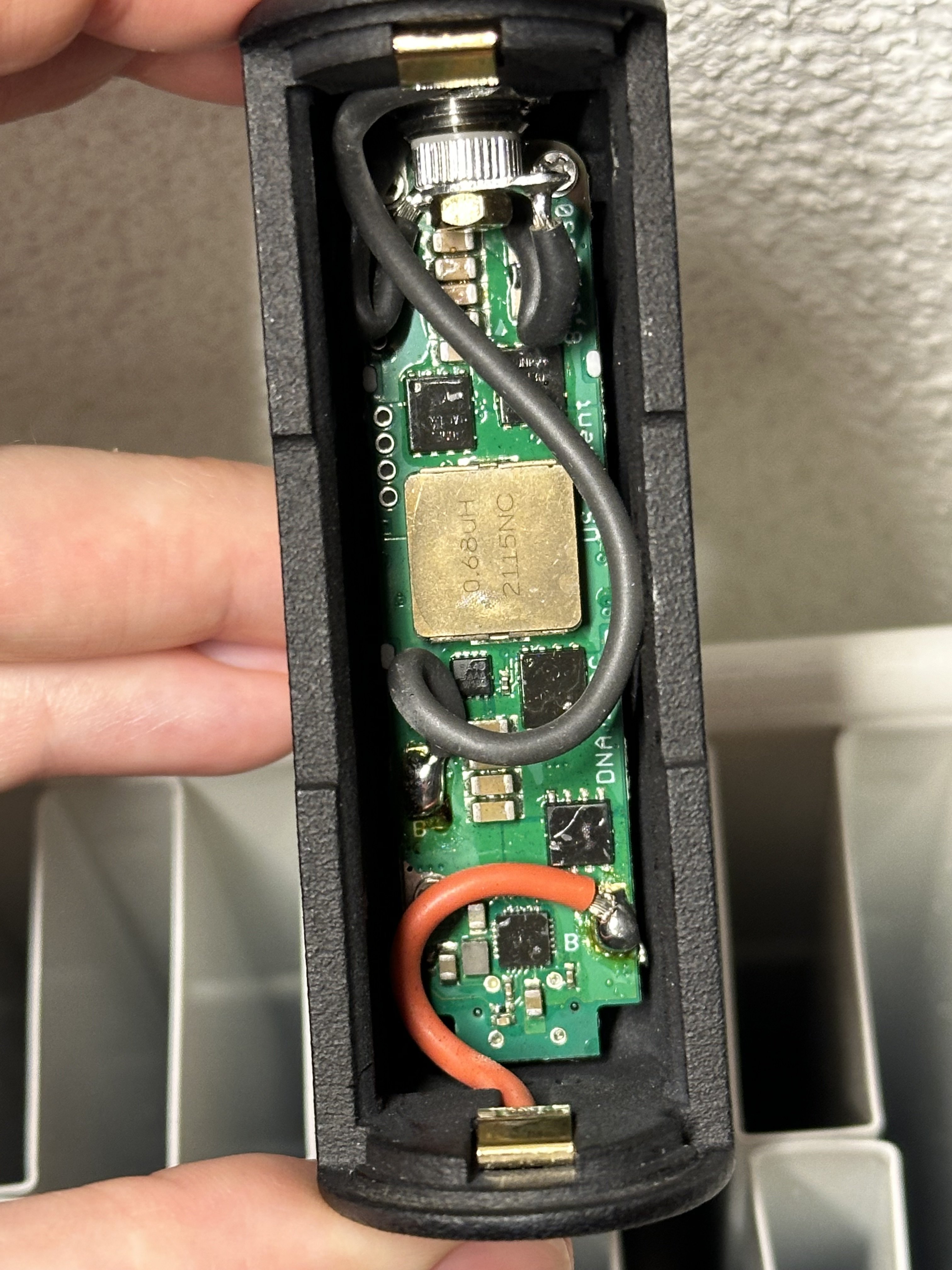

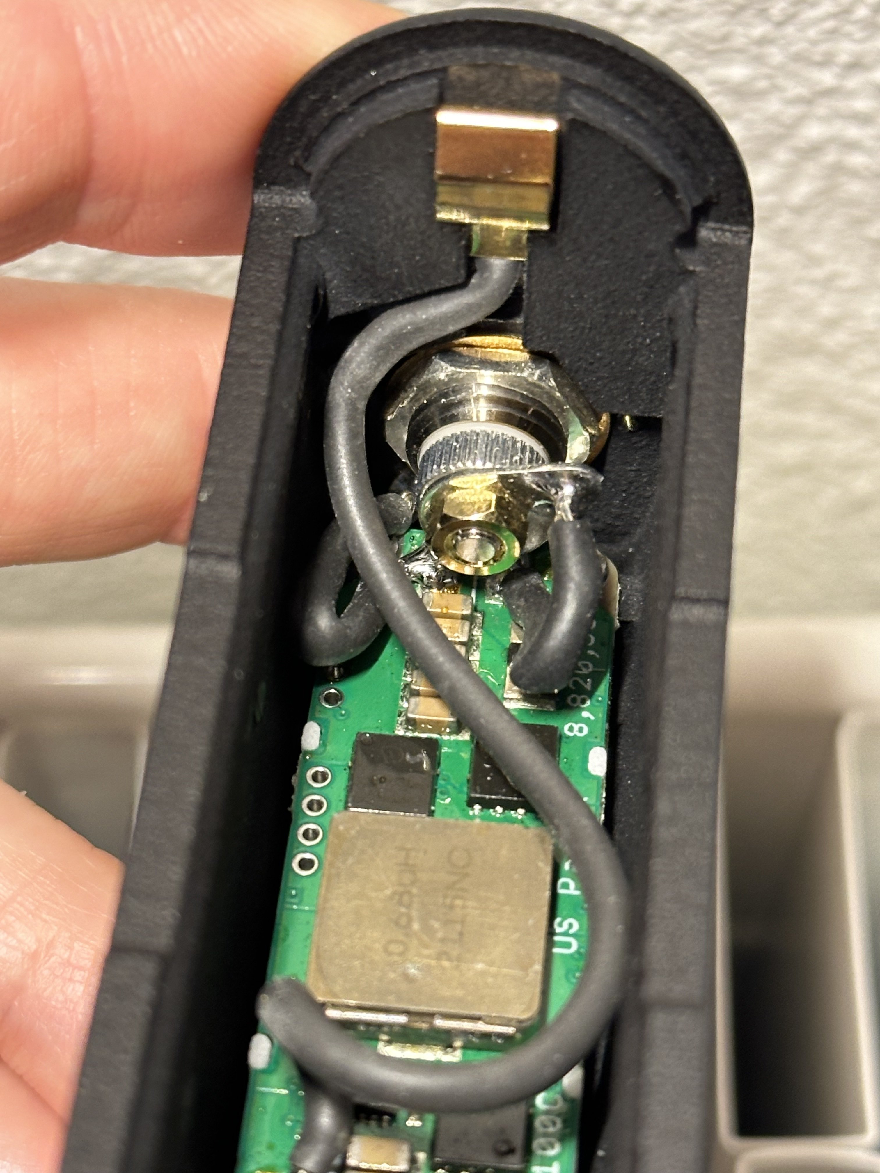

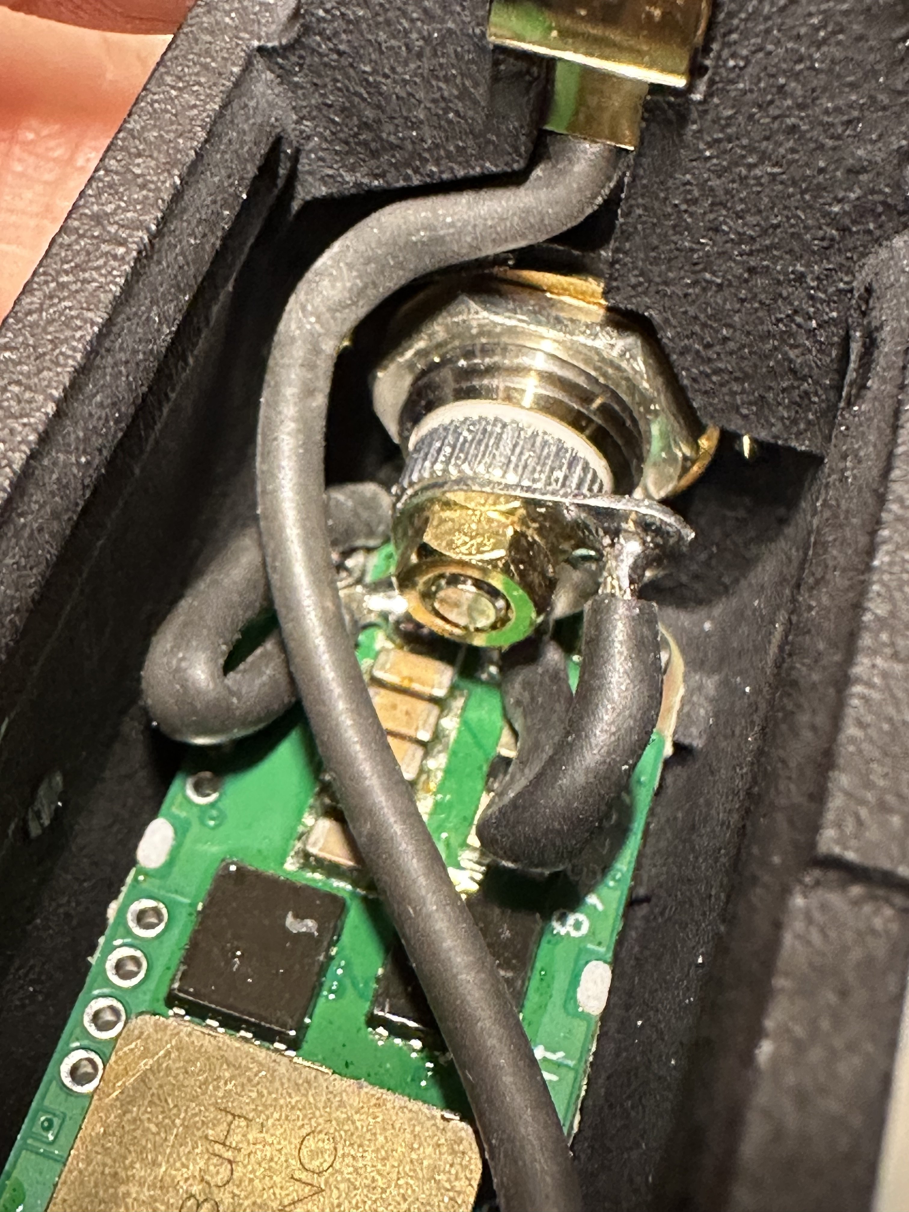

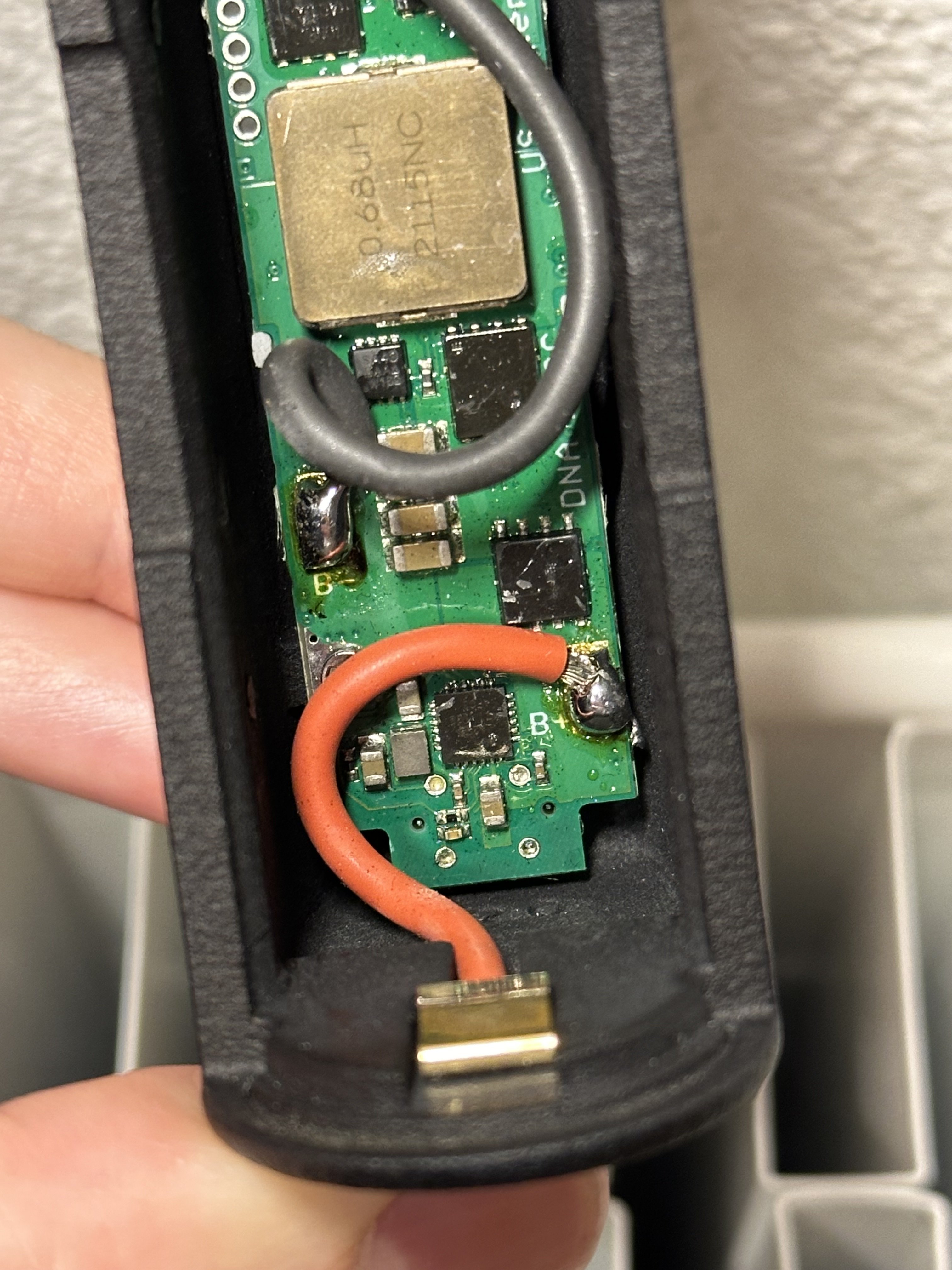

cloudzey Posted May 15, 2024 Report Posted May 15, 2024 Hello my friends, I use a mod with the dna 100c chip connected with a 510 extension cable which is connected to a heater. The resistance of the cable is 0.015 ohm and the resistance of the heater is 0.210 ohm. After less than 5 minutes of use the mod gets the error "chip too hot". Because the temperature of the board (red data in chart) is over 80°C. But there is no heat source near of the mod. The cable is cold, the battery is cold. The heater is hot as visible in chart (dark blue) with temperature set at 230 °C but the heater is far away from the mod. The extension cable length is 60cm. There at the lighning symbol was the error chip too hot. What is the problem with this board? Is there something defect? I have other dna 100c mods that have no problem with the board temperature with the exact same setup.. In the diagram is a heating session first with a pre heat and than continous session with under 20 Watts after the temperature is reached. But even with this "low" power the board heats up over time. I'm very thankful for help!! I can also provide more information if needed

cloudzey Posted May 16, 2024 Author Report Posted May 16, 2024 (edited) Thank you for the answers! Sorry the colors are a bit misleading in the chart. The power is light blue and the temperature of the heater is darker blue. It has never over 70 watts ( very short time) and then only around 20 watts over the time. I think this is a expected power over such a timeframe from a dna100c mod? edit: left y-axis in the chart is power for the light blue data. right y-axis is temperature for the red and dark blue data. Edited May 16, 2024 by cloudzey

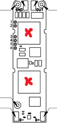

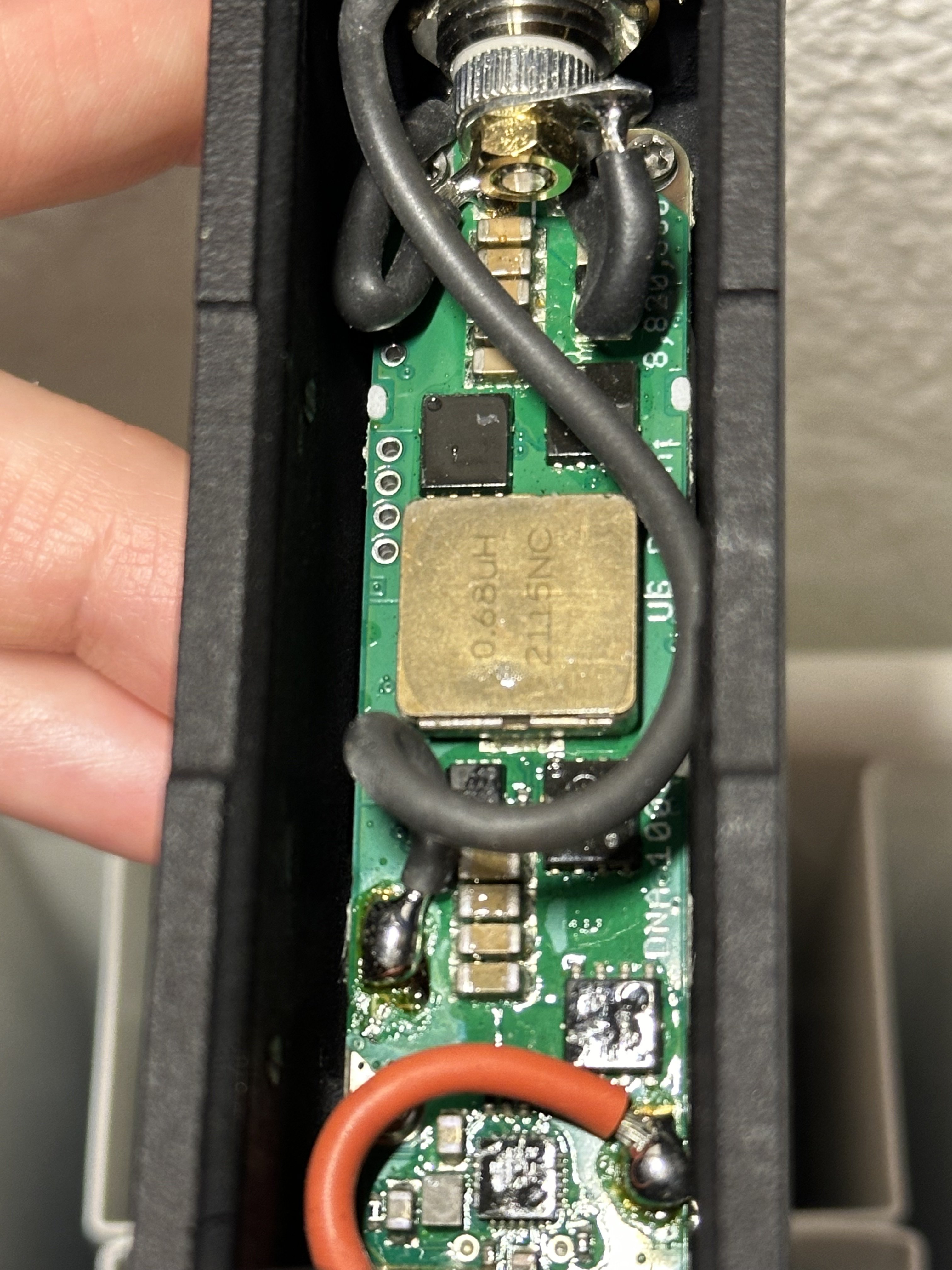

cloudzey Posted May 16, 2024 Author Report Posted May 16, 2024 vor 6 Minuten schrieb dwcraig1: I'm just guessing here as to what else might be the probem if it's not what's already mentioned. On the board there are two inductors and there have been cases where one either falls off or breaks connection. The board will work with just one. These are where I woud expect would be the component that would give off the most heat. Maybe you can see if the both feel about the same temperture after hard use. This board looks different than the one from dna 100c? It has only one of this inductors. And the one get's really warm. Does anyone know where is the temperature sensor for the error: "chip too hot"?
Wayneo Posted May 16, 2024 Report Posted May 16, 2024 That's right, the 100C only has 1 inductor, and it's supposed to get hot. There is a thermistor near that inductor that senses the board temperature 1

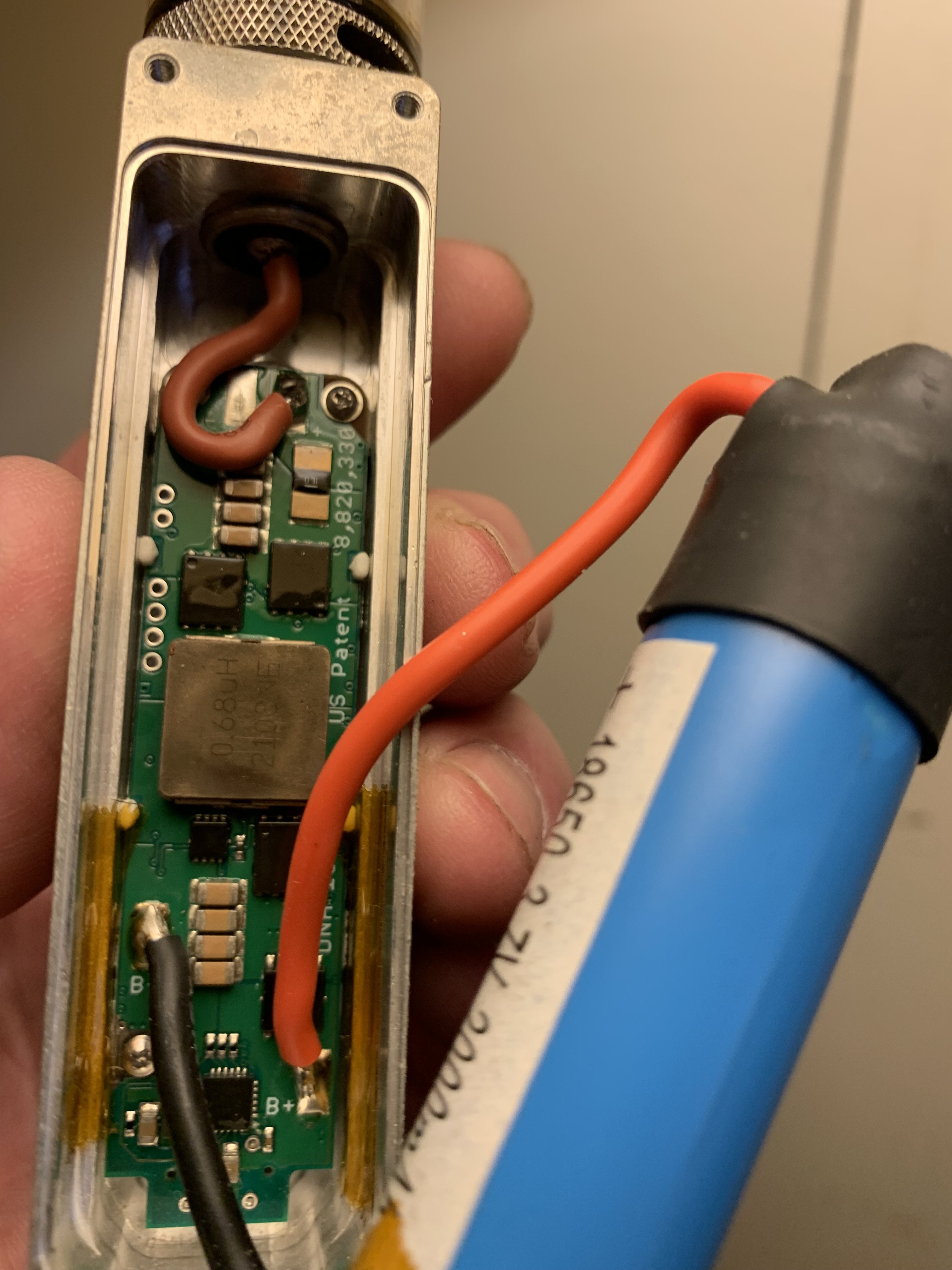

dwcraig1 Posted May 16, 2024 Report Posted May 16, 2024 Yep, only 1, my mistake. Here is one of my DNA100C mods. 1

cloudzey Posted May 16, 2024 Author Report Posted May 16, 2024 vor 2 Stunden schrieb Wayneo: Thanks, i was just looking at the mod setup parameters and they appear all stock/standard so that's not THE issue. Thank you for checking! vor 5 Stunden schrieb dwcraig1: Yep, only 1, my mistake. Here is one of my DNA100C mods. For me it looks kind of similar to mine..
cloudzey Posted May 16, 2024 Author Report Posted May 16, 2024 vor 5 Stunden schrieb Wayneo: That's right, the 100C only has 1 inductor, and it's supposed to get hot. There is a thermistor near that inductor that senses the board temperature btw do you know which one is the board temperature thermistor? or are there more thermistor for temperature measurement?
