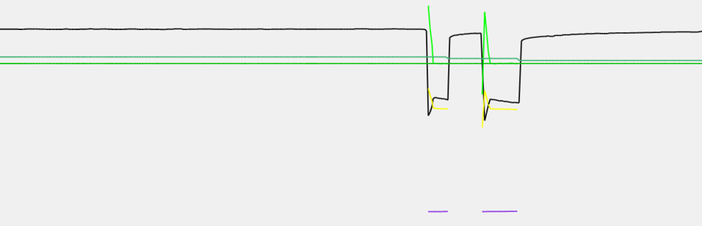

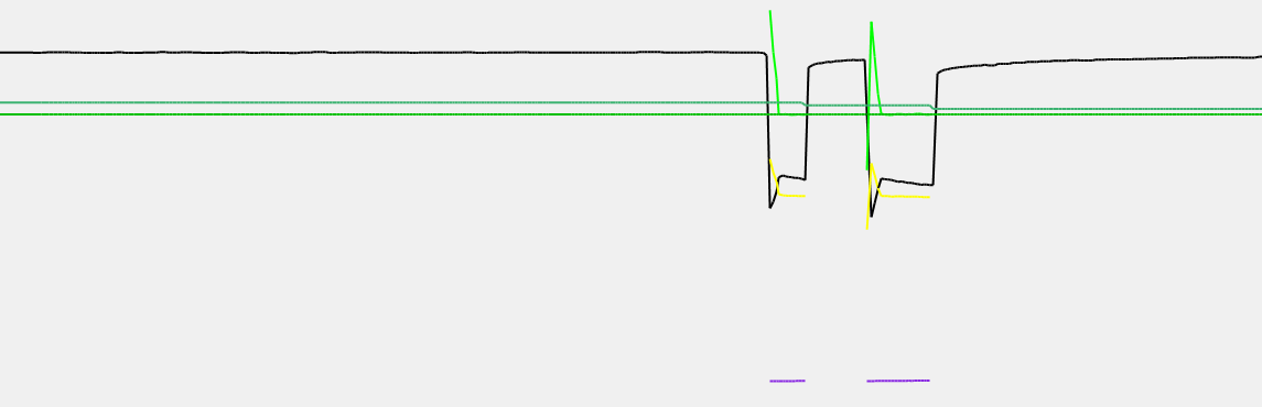

DRiva91 Posted May 8, 2024 Report Posted May 8, 2024 this is like my third dovpo riva dna250c, i dropped my last one and broke so i bought a new one i liked it so much. this one was working flawlessly until about a week ago. I use the same build on the same wattage with the same juice, constantly. a week or so ago i started getting a noticeable drop in vapor production and throat hit. I looked at the diagnostics on the screen and everything looked fine, but when i hooked it up to escribe and used device monitor, i get a competely different value for the current out put when i fire. than what it says on the screen of the device in diagnostics. On the mod screen, it says im get 38.3 amps when i fire. on escribe its says 23.3 amp. i restored it to default settings it doesnt fix it. can anyone help me. i wrote evolv a couple emails for help... havent gotten a reply yet.
dwcraig1 Posted May 8, 2024 Report Posted May 8, 2024 Can you post a screen shot of your device firing like this? Are you using temperature control? Check boxes indicated. 1
DRiva91 Posted May 9, 2024 Author Report Posted May 9, 2024 No, it's ni80, just using wattage. Everything matches up besides the current/amps that being sent to the atomizer. I am on the way back from the hospital visiting my dad, when I get home I can send a screenshot, but i don't think it will show temperature because it's ni80
dwcraig1 Posted May 9, 2024 Report Posted May 9, 2024 It looks to be running at your set wattage after boost is finished. Note there is current output from the battery and current output from the board and they will not usually ever match up. 1

Wayneo Posted May 9, 2024 Report Posted May 9, 2024 Start escribe and do a screenprint of that profile 3 (or whichever profile you're using) 1
