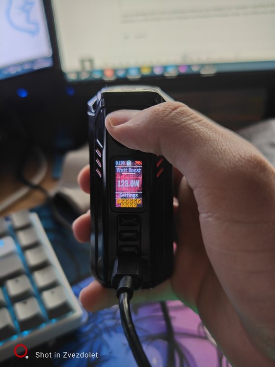

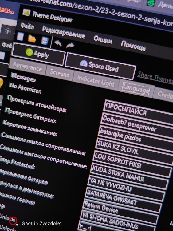

RedRoom Posted May 30, 2023 Report Posted May 30, 2023 Всем привет, столкнулся с проблемой, когда в evolv выставляю русские надписи в кладке Language, вместо русских слов появляются знаки ???? Как это исправить? Hello everyone, I ran into a problem when I put Russian inscriptions in the Language tab in evolv, signs ???? appear instead of Russian words. How to fix it? 12.bmp

Wayneo Posted May 30, 2023 Report Posted May 30, 2023 That 'language' tab shows the standard informational/warning status messages. What kind of items are those 3 '?' marks? Are they (on your mod) labels, pictures, etc? 1
RedRoom Posted May 30, 2023 Author Report Posted May 30, 2023 9 минут назад, Wayneo сказал: That 'language' tab shows the standard informational/warning status messages. What kind of items are those 3 '?' marks? Are they (on your mod) labels, pictures, etc? I want the warnings to be in Russian and displayed normally, but it only displays normally if written in English

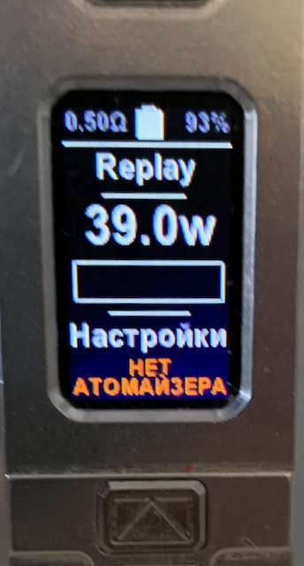

Wayneo Posted May 30, 2023 Report Posted May 30, 2023 9 hours ago, Wayneo said: What kind of items are those 3 '?' marks? Are they (on your mod) labels, pictures, etc? Seems to work for me. You'll understand. Your picture didn't identify the English that should have been russian, but there's the 'no atomizer' in russian. 1

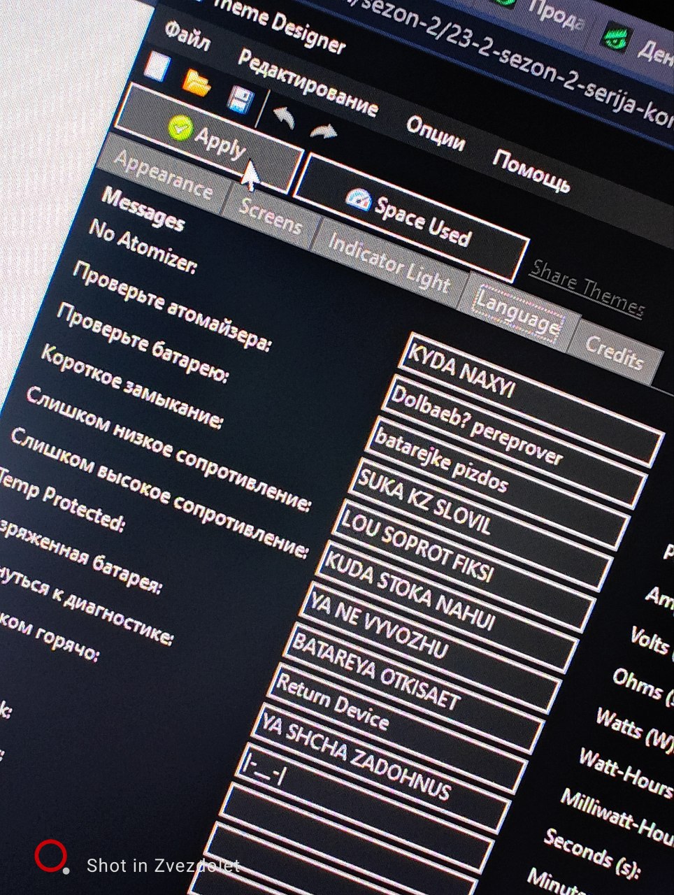

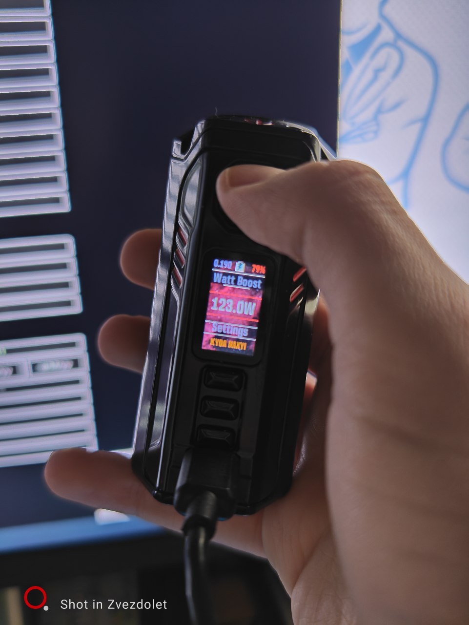

RedRoom Posted May 30, 2023 Author Report Posted May 30, 2023 37 минут назад, Wayneo сказал: Seems to work for me. You'll understand. Your picture didn't identify the English that should have been russian, but there's the 'no atomizer' in russian. I use a translator and I don't understand what you are writing at all. Russian I specified in the program, in the absence of an atomizer, to write words to me in Russian, but instead of Russian words, she writes me a question mark ???
RedRoom Posted May 30, 2023 Author Report Posted May 30, 2023 1 час назад, Wayneo сказал: Seems to work for me. You'll understand. Your picture didn't identify the English that should have been russian, but there's the 'no atomizer' in russian.
Wayneo Posted May 31, 2023 Report Posted May 31, 2023 Here is the theme I used. There are a few variations. I am not sure if the words are russian or ukranian. https://bit.ly/42uxCcN Here is another https://forum.evolvapor.com/files/file/554-roman_finder250c_rusecigtheme/ I would say there are at least 5 or 6 russian themes. You could try a search in russian while in the theme park. Good luck.

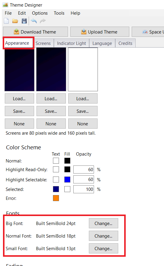

aMirS Posted May 31, 2023 Report Posted May 31, 2023 (edited) 18 hours ago, RedRoom said: Всем привет, столкнулся с проблемой, когда в evolv выставляю русские надписи в кладке Language, вместо русских слов появляются знаки ???? Как это исправить? Hello everyone, I ran into a problem when I put Russian inscriptions in the Language tab in evolv, signs ???? appear instead of Russian words. How to fix it? 12.bmp 174.84 kB · 2 downloads I think this problem is because of the font of your theme. Use the font that correctly displays the Russian language (like arial, roboto black and ... ) . Change the font in the appearance section and your problem will be solved. Edited May 31, 2023 by aMirS 1
