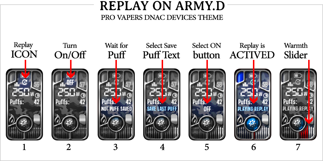

aMirS Posted December 24, 2022 Report Posted December 24, 2022 (edited) Hi OnyxBlackscale, It's diagram of how to correctly activate replay in pro vapers theme (ARMY.D variant). HAPPY HOLIDAYS…. Edited December 24, 2022 by aMirS 1
OnyxBlackScale Posted December 24, 2022 Author Report Posted December 24, 2022 (edited) hey!, thanks for getting in touch, The problem i was having was between step 3 and step 4. as the 'not puff saved' would never turn over to the blue 'save last puff' option, so i couldn't select it at all, it would just jump from action centre/daylight mode straight to the flame icon. was really frustrating, because i knew i needed to save the puff, just the mod wouldn't let me. But I managed to get it to stop doing it, by changing my Escribe over to manufacturer mode (7 clicks about us tab, also seems to work in theme designer to add more indepth/dev options. like max power limit, which to me hints you can push it past 400w, though not sure how comfortable id be doing that, overclocking the board might just pop it) and changing how the replay puff detection sensitivity worked (basically put it into high noise mode allowing it to detect the 0.07 ohm change id get when taking a toke.) but after pushing that update, literally the first toke after that and bang. working great. so i'm more than happy. mostly cos i dont need to sit down with my coily tool and make some new coils, as i made a ton of them when i ordered my mod so i could have fresh coils in all my tanks, maybe if id have gone for just one metal rather than a mix of Kanthal and SS316 for my claptons, wouldnt have been having this headache. or could be something to do with double coils. dunno, maybe it was just doing that tech thing and not working till you have a whinge about it, then it works absolutely fine just to make you look silly after asking for help. But yeah, its fantastic now, currently have a aromamizer supreme V3 on top with a single beefy coil in it, set to 35W with a 25W 2 second preheat, and it works great, can just about feel how it feathers the power near the end of the toke (which is nice, as normally by the time I'm done with my toke i usually have to let off the power a second early and keep inhaling to stop condensation in my longer drip tips, in replay mode with the punch and warm settings i'm using don't have to do that, can finish my toke then release the button and get a whole lot less condensation in my 65mm pipe stem) Though will say, Many thanks for the theme, i really like it. though made a few minor personal tweaks to it (repositioned the lock screen and deleted the picture. added date and time to lock screen, put my username on the lockscreen, swapped the main screen white battery icon out for a percentage (doesn't look as neat, but a lot more info than the ranges that the battery bar has) and just sat having a think what else i might like to add to it) I'll pop up a short review on your theme page after i've had some breakfast Edited December 24, 2022 by OnyxBlackScale 1
