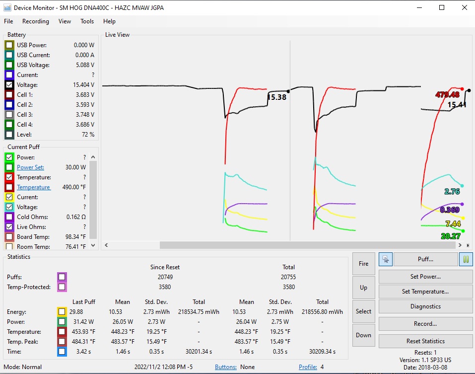

Marco234 Posted November 2, 2022 Author Report Posted November 2, 2022 1 hour ago, BillW50 said: The power and temperature didn't change? What were you changing? Warmth? It only has an effect when playing within Replay, just like @Wayneo said. I figured I am going to have to do it for you. Here is Warmth set in the middle, then full, and then off. Maybe you don't see a difference, but I sure do. It gives it a boost in power in the beginning the puff. The higher the warmth, the higher it applies more power. When off, power is flat without any extra power at the beginning of the puff. sorry looking at this is akin to me looking at statistical graphs which im not good at....and yes i was changing warmth soley and nothing really occured. Earlier you said warmth soley changes the temperature part of the mod not the wattage part....but all i wanna know is by how much does the temperature (as you said before, warmth associates with temp) change by each number up. Thats all i am trying to say. I am sorry.
BillW50 Posted November 2, 2022 Report Posted November 2, 2022 (edited) Well if you increase power, you increase voltage, resistance (with TC material), and temperature too, so they all go hand in hand. When you decrease power, you decrease voltage, resistance, and temperature. So when you increase warmth, you are warming the coil faster. Of course, once you hit the max temperature setting, it isn't allowed to go higher and power will drop to keep the temperature from going higher. And you can't say like one bump up in Warmth is 10 watts more power. Nor can you say it is 10° warmer. As it isn't calculated that way. As it is based on a percentage of the power setting looking at the Device Manager. There could be other factors in play in the algorithm. As I don't have the source code and I am sure it is a trade secret anyway. But you can see the effects in the graph. And that is what is important. Edited November 2, 2022 by BillW50

BillW50 Posted November 2, 2022 Report Posted November 2, 2022 Replay isn't meant to be defined. It is meant to repeat that last saved puff. Punch is only available outside of Replay playing. And Warmth is only available while Replay is playing (the saved puff).
