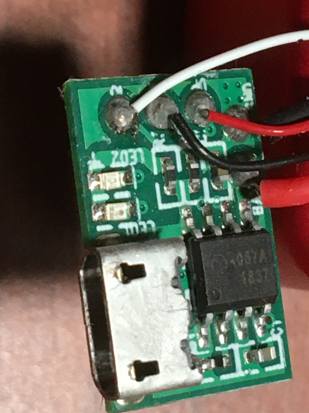

Well i have a micro usb, but i dont know what cable i must put in the board.
the micro usb is not from evolv.
Link to comment
Share on other sites
Some people just put the wires through the holes without soldering. As long as it is making a connection and you don't bump it, should be ok. I wouldn't try updating the firmware though. One slight intermittent connection might brick the board. But other things besides uploading settings should be fine.
