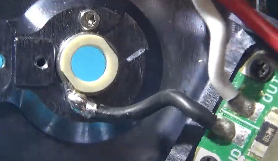

jhinton7930 Posted January 24, 2022 Author Report Posted January 24, 2022 I tried all kind of settings in escribe. Saw another post about the odin that was having similar issues. It had video links showing that it was a loose screw on the 510. I carefully took it apart and tightened the screws on the 510 up and we are back to working like it should. If it comes loose again I guess I'll have to soldier it to the 510 it's self like in the second video. Appreciate you for the response tho. 1

BillW50 Posted January 25, 2022 Report Posted January 25, 2022 (edited) I never had a problem with my Paranormal mods either. Although others have had door problems. And some have reported if the 510 is too long of your atty, it pushes down on the 510 pin too far and it touches on the positive side on one of the battery connections. Thus sending over 6 volts to your coil until you unscrew your atty. It could damage the DNA250C board too. Although I haven't heard of any blown boards. Luckily the Odin mods are easy to take apart and easy enough to put Loctite on the threads and the Odin should outlive many of us. Edited January 25, 2022 by BillW50

BillW50 Posted January 25, 2022 Report Posted January 25, 2022 (edited) 28 minutes ago, Wayneo said: @BillW50 Loctite on the threads <- Don't do that. It can throw off your ohm readings. I personally encountered that AND here's a post from an Evolv employee saying the same ThatGuySwain - https://forum.evolvapor.com/topic/69140-paranormal-75c-resistance-too-high-fix/ Yes I figured as much. That is why you move the ground wire and solder directly to the 510 base itself. Edited January 25, 2022 by BillW50
BillW50 Posted January 26, 2022 Report Posted January 26, 2022 Dovpo Odin DNA250C high ohm reading - temp protection - Part 1 Dovpo Odin DNA250C high ohm reading - Part 2 1
