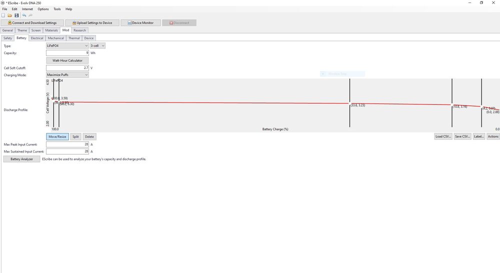

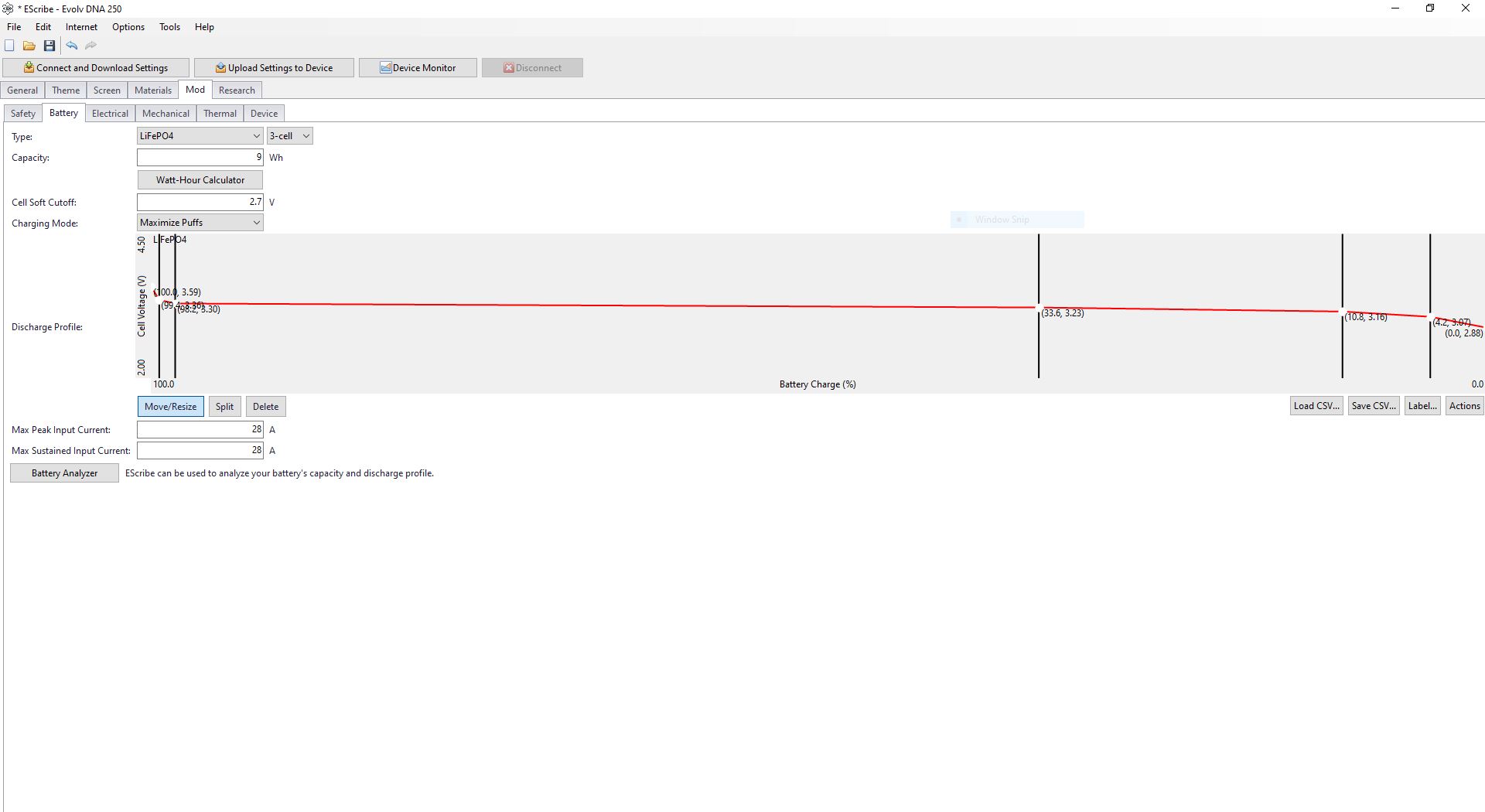

BillW50 Posted May 19, 2021 Report Share Posted May 19, 2021 (edited) The chipsets 200/250/250C can use LiFePO4 and you need to change the battery type with EScribe. These chipsets require 2 or 3 cells (250C up to 4) wired in series. So I don't follow trying one cell first. Nor do I foresee any problems with the battery level reading. If you do, just run the battery analyzer. And yes, if the chipset knows you are using LiFePO4, you can safely charge them in the mod. And you can turn on the board without cells through the USB connection. It won't fire of course. Edited May 19, 2021 by BillW50 Additional info Link to comment Share on other sites More sharing options...
vapenow Posted May 19, 2021 Author Report Share Posted May 19, 2021 Thanks @BillW50 for the advice on chipset, if only the 200/250/250C support LifePo4, yup, it will require multiple cells in series. Noted. For the curve, have you looked at it, it is very Very flat. Unsure of 1) How the device knows how much battery is left and 2) Safety of dropping below threshold. Does the chip have a profile for LifePo4 cells? Link to comment Share on other sites More sharing options...
BillW50 Posted May 19, 2021 Report Share Posted May 19, 2021 LiFePO4 cells does drop in voltage as they are discharging, although not as much as other cells and are almost flat. DNA boards also uses watt hours to figure out the battery level. So even if the discharge was perfectly flat, it would still accurately read the charge level. You can run the battery analyzer or enter the correct value yourself with EScribe. The default LiFePO4 profile probably works fine. Yes LiFePO4 is settable under the manufactures interface with any 200/250/250C. Link to comment Share on other sites More sharing options...

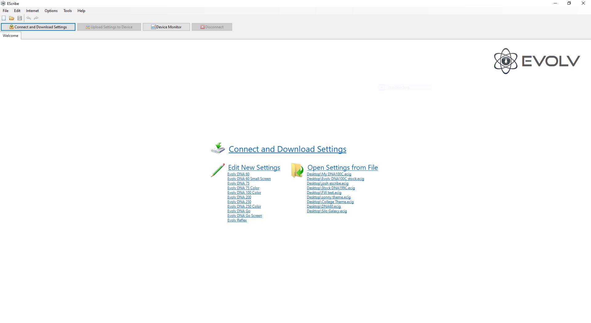

dwcraig1 Posted May 19, 2021 Report Share Posted May 19, 2021 You can load various mods into EScribe without connecting the actual mod. Just pick one from "Edit New Settings" 1 Link to comment Share on other sites More sharing options...
dwcraig1 Posted May 19, 2021 Report Share Posted May 19, 2021 And make changes. 1 Link to comment Share on other sites More sharing options...
vapenow Posted May 19, 2021 Author Report Share Posted May 19, 2021 Okay this is sounding like: Just put setting to Lifepo4 and you are done. Please forgive me but there are a lot threads that allude to some issues: 1) Must be multiple cells in series to run a 250C board, hence if cells voltage is not balanced perfectly Venting issue could happen 2) Min cutoff is 2.5 volts for board, cell is 3.3 V with sharp drop off and can run near board cutoff at high current draw poses many safety concerns, killed battery concerns, and malfunction/error Are these issues resolved, it cant be as easy as drop them into a mod and change the setting in escribe...I wish it were like that. In fact if it is I could just drop a pair of Lifep04 18650s from lithium werks or A123 directly into a Lost Vape Centaurus and risk-be-gone. Tell me if I am missing something, please. Link to comment Share on other sites More sharing options...
BillW50 Posted May 19, 2021 Report Share Posted May 19, 2021 (edited) Yes selecting LiFePO4 and save changes back to the mod and that should be it. Cells should be the same type and capacity, age, etc. But perfectly balanced isn't really important since the DNA monitors the state of each cell anyway. And if one cell is lower more than the others the DNA will throw up an error and won't let it do something it shouldn't. The DNA does cell balancing after charging, but it is slow. So being closely balanced beforehand will be a lot faster. The only problem I see is the default LiFePO4 Profile not reading the correct battery level. And running the battery analyzer will build a Profile tailored to those cells if it isn't right and your all set. You can change the cell cutoffs if you like, but it shouldn't be necessary. Edited May 19, 2021 by BillW50 Link to comment Share on other sites More sharing options...
