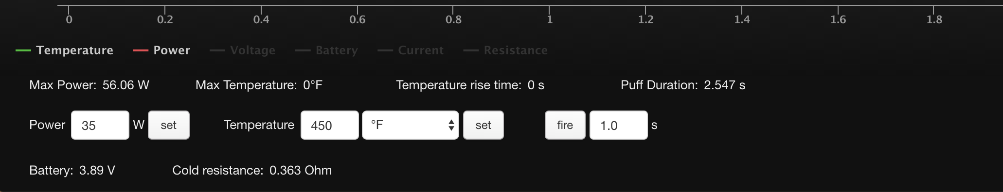

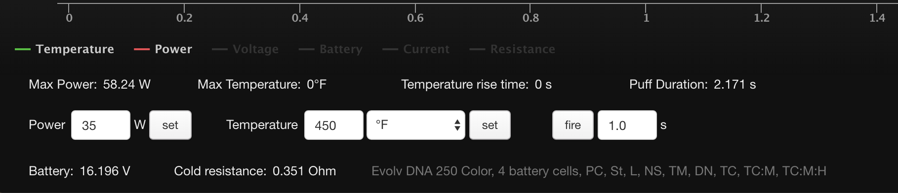

Wayneo Posted April 19, 2021 Report Posted April 19, 2021 15 watts on ALL mods SHOULD feel the same. All things being equal (between your Odin and the Thelema), the 'boost' will be the same for YOU. It does not matter 1 battery vs. 2 or even 4 for your specs. There are many good youtube videos that explain the features of these boards. Here are 2 screenshots for you with similar coils. One a lowly 75C, the other a 400watt capable 250C. Look at max power. 75C 250C I think it was just 'boost' not enabled initially. Enjoy your mod. 👋 3

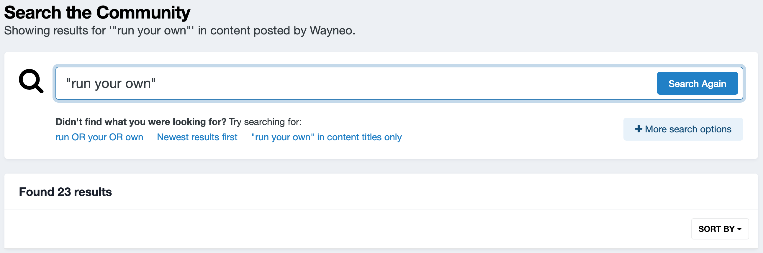

Wayneo Posted April 22, 2021 Report Posted April 22, 2021 On 4/21/2021 at 5:31 AM, BillW50 said: Careful Wayneo, people might get the wrong idea that batteries and manufacture settings doesn't matter. 😉 Only in bizzaro world could a person think that from what I wrote 🤣. I still think it was just 'boost' not enabled initially. In this case I DO recommend the Evolv 'manufacturer' defaults over those from a user created file, that's not even a Dovpo product. In all fairness I did post the Dovpo Mini 'default theme' last year, and after >350 downloads not a single comment or review noticing that their Ohms too low/high messages were backwards 🤣. Hey it's their default. With all the tools available to end users I promote users to run their own for their setup. A quick search here shows at least 20+ times. 😉

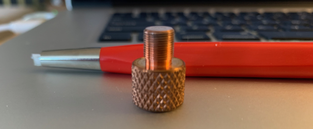

Wayneo Posted April 22, 2021 Report Posted April 22, 2021 My Mirage DID NOT have the same internal resistance as Jason's in that file. My 2 Paranormals DID NOT have the same internal resistance My 2 Triades DID NOT have the same internal resistance I check and set with my all shined up Copper tool before ever taking a puff. For every mod I own. PS That red tool, available on Amazon is great for cleaning 510's. Fiberglass threading you snip off when dirty.
