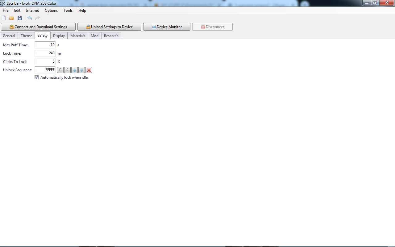

IcyFridge Posted February 12, 2021 Report Posted February 12, 2021 Hello all. I'm new to the DNA world and got a VT75 Nano in near mint condition with buttery smooth threads. I love the device except for two things... 1. Is there a way to change the timer for the device going into sleep? 2. Is there a way to make clicking power 5 times required to power on (not unlock) the device instead of one click? The reason for this is that I usually carry my mods in my backpack. If the VT75 goes to sleep in my backpack, it takes only one touch of the power button to turn on. I don't want this to happen inside my bag. I'd love to be able to let it go to sleep in something like 15 minutes and then require 5 clicks to turn it on.
Wayneo Posted February 12, 2021 Report Posted February 12, 2021 Welcome, There are numerous youtube videos on the workings of these boards. DJLSB vapes has some good ones. Here's a link to the manual.https://downloads.evolvapor.com/dna75.pdf 1. No, but there are different states of sleep. You can't turn them off, but they do power down to a very low draw, listening/waiting for a button press. 2 Also different ways/things to lock, like your fire button while in your backpack, but your screen will come on, then fade or go off, unless you're in stealth mode. All those (Brightness/Fading) are in escribe -> screen. Button presses in Theme Designer. Most features and operations are the same between board type (color and non color), with only a few differences such as display items while charging on the 75. AND the search feature works here 👋 1
IcyFridge Posted February 12, 2021 Author Report Posted February 12, 2021 48 minutes ago, Wayneo said: Welcome, There are numerous youtube videos on the workings of these boards. DJLSB vapes has some good ones. Here's a link to the manual.https://downloads.evolvapor.com/dna75.pdf 1. No, but there are different states of sleep. You can't turn them off, but they do power down to a very low draw, listening/waiting for a button press. 2 Also different ways/things to lock, like your fire button while in your backpack, but your screen will come on, then fade or go off, unless you're in stealth mode. All those (Brightness/Fading) are in escribe -> screen. Button presses in Theme Designer. Most features and operations are the same between board type (color and non color), with only a few differences such as display items while charging on the 75. AND the search feature works here 👋 Thank you for this information. I've already modified the screen timings as I hate the screen being on too long. I know there's a way to change the number of clicks to lock/unlock. My biggest issue is when the device wakes from sleep, it only takes one button press. I'd rather it take 5 presses to wake from sleep/power on (not unlock).
zark Posted February 12, 2021 Report Posted February 12, 2021 54 минуты назад, IcyFridge сказал: Моя самая большая проблема - когда устройство выходит из спящего режима, требуется всего одно нажатие кнопки. Я бы предпочел 5 нажатий для выхода из спящего режима / включения (не разблокировки) Такой возможности нет, при нажатии любой кнопки, экран будет светится, изменить настройки можно с помощью Escribe Так же можно выбрать другую комбинацию клавиш
IcyFridge Posted February 12, 2021 Author Report Posted February 12, 2021 Yes. I have it set to 5 clicks for lock/unlock. I speak of power on. When I power it on, it's unlocked.
zark Posted February 12, 2021 Report Posted February 12, 2021 4 минуты назад, IcyFridge сказал: Да. У меня для блокировки / разблокировки установлено 5 нажатий. Я говорю о включении. Когда я его включаю, он разблокируется. Это невозможно изменить, может в следующих обновлениях Escribe добавит подобные настройки
