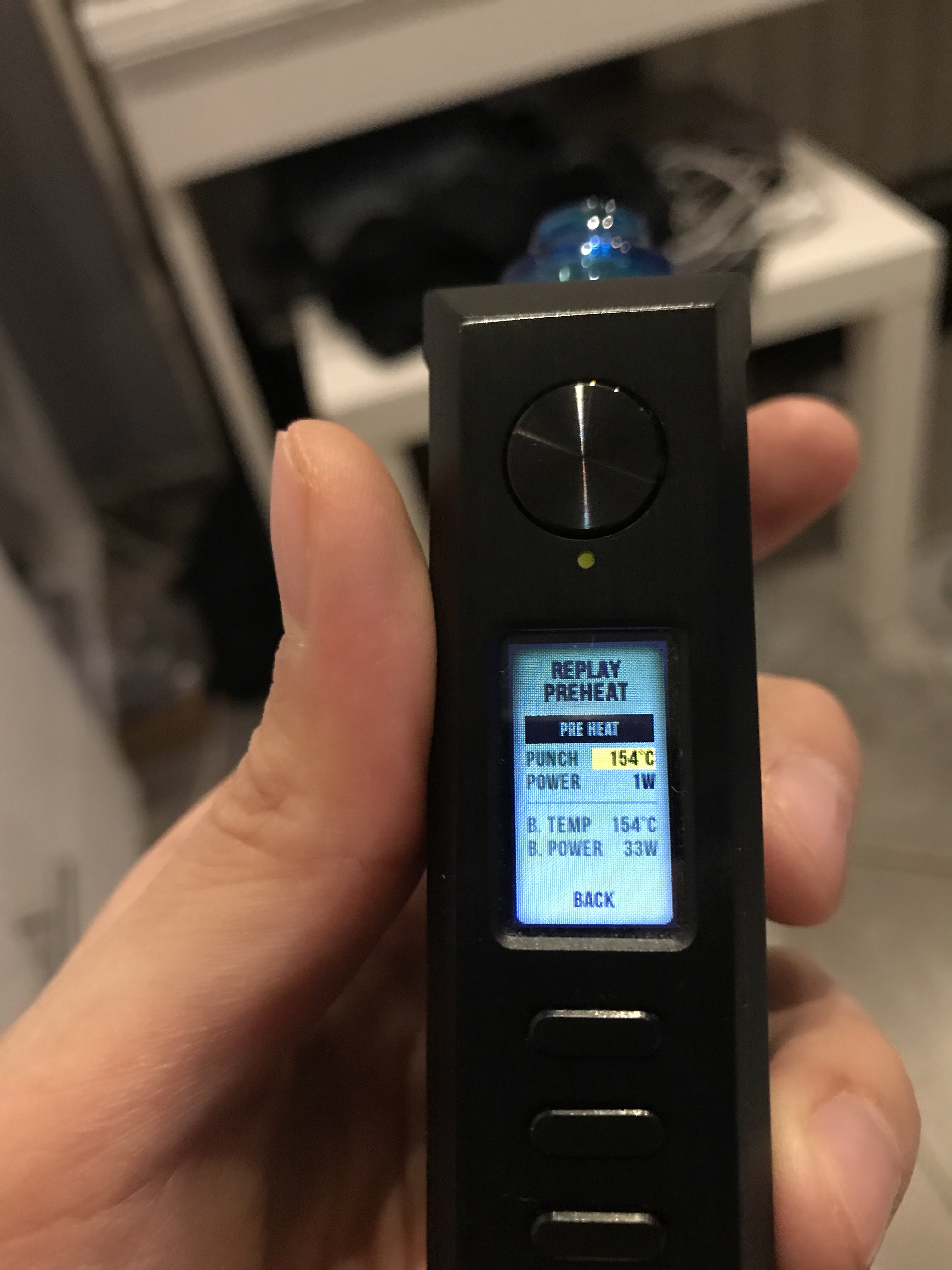

dwcraig1 Posted December 8, 2020 Report Share Posted December 8, 2020 If preheat (1 watt) is set lower than power (33 watts) it has no effect. 1 Link to comment Share on other sites More sharing options...
Wayneo Posted December 8, 2020 Report Share Posted December 8, 2020 Y'ever seen a board temp of 154°C DW? That'd be like 309.2°F Link to comment Share on other sites More sharing options...
dwcraig1 Posted December 9, 2020 Report Share Posted December 9, 2020 I did see the "B" but at the time didn't realize it was "Board" I think you have found the problem......or a problem. Earlier screen shots doesn't show it that hot. Link to comment Share on other sites More sharing options...
Wayneo Posted December 9, 2020 Report Share Posted December 9, 2020 I don't think it's a board problem, I think it's a user caused problem. Many of his DM posts show they're just Device Monitor puffs. No airflow through those/that coil so it just sits there cooking. Link to comment Share on other sites More sharing options...
