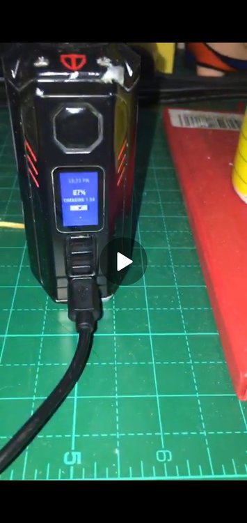

djgomes Posted July 17, 2020 Report Posted July 17, 2020 Hi guys. Could someone help me with this problem. My finder showed the message of disconnected on the display, what can it be?
Wayneo Posted July 17, 2020 Report Posted July 17, 2020 Does that change if a data/charging cable is plugged into it? 1
dwcraig1 Posted July 17, 2020 Report Posted July 17, 2020 I'm going to take a guess, judging by the single dot at the bottom of the screen maybe is means "Locked". Escribe/Theme designer might offer some insight to it. Vou adivinhar, a julgar pelo único ponto na parte inferior da tela, talvez signifique "Bloqueado". O designer Escriba / Tema pode oferecer algumas dicas.
djgomes Posted July 17, 2020 Author Report Posted July 17, 2020 8 horas atrás, Wayneo disse: Does that change if a data/charging cable is plugged into it? yes ... It appears in the image loading ... I don't have a photo but I took a print of a video I already had on my cell phone. 1
djgomes Posted July 17, 2020 Author Report Posted July 17, 2020 Well ... I was wondering if you can save him or died?
dwcraig1 Posted July 17, 2020 Report Posted July 17, 2020 The device does appear to be locked. Does it work if you unlock it? Default unlock is 5 clicks of the fire button, if that has been changed EScribe will show what it was changed to and/or you can change it to whatever you want.
djgomes Posted July 17, 2020 Author Report Posted July 17, 2020 So he didn't die ... Good ... As soon as I get home I'll try again to set him up in the scribe. Thanks a lot for the help. 1

Gavnaf Posted July 19, 2020 Report Posted July 19, 2020 В 17.07.2020 в 04:05, djgomes сказал: Привет, ребята. Может ли кто-нибудь помочь мне с этой проблемой. Мой искатель показал сообщение о том, что он отключен, что это может быть? This is a design theme. In the theme editor, you can remove this signature. Or change the subject to another. The mod shows that the charger is disconnected.
djgomes Posted July 29, 2020 Author Report Posted July 29, 2020 sorry for the delay to post but the finder is alive. thank u all 1
dwcraig1 Posted July 30, 2020 Report Posted July 30, 2020 4 hours ago, djgomes said: sorry for the delay to post but the finder is alive. thank u all That is great to hear. Can you give some more details about how you got it fixed? Isso é ótimo de ouvir. Você pode dar mais detalhes sobre como corrigi-lo?
djgomes Posted July 30, 2020 Author Report Posted July 30, 2020 10 horas atrás, dwcraig1 disse: That is great to hea r. Can you give some more details about how you got it fixed? Isso é ótimo de ouvir. Você pode dar mais detalhes sobre como corrigi-lo? Just reset the device using the registry, download a new theme and update and return to normal. 1
