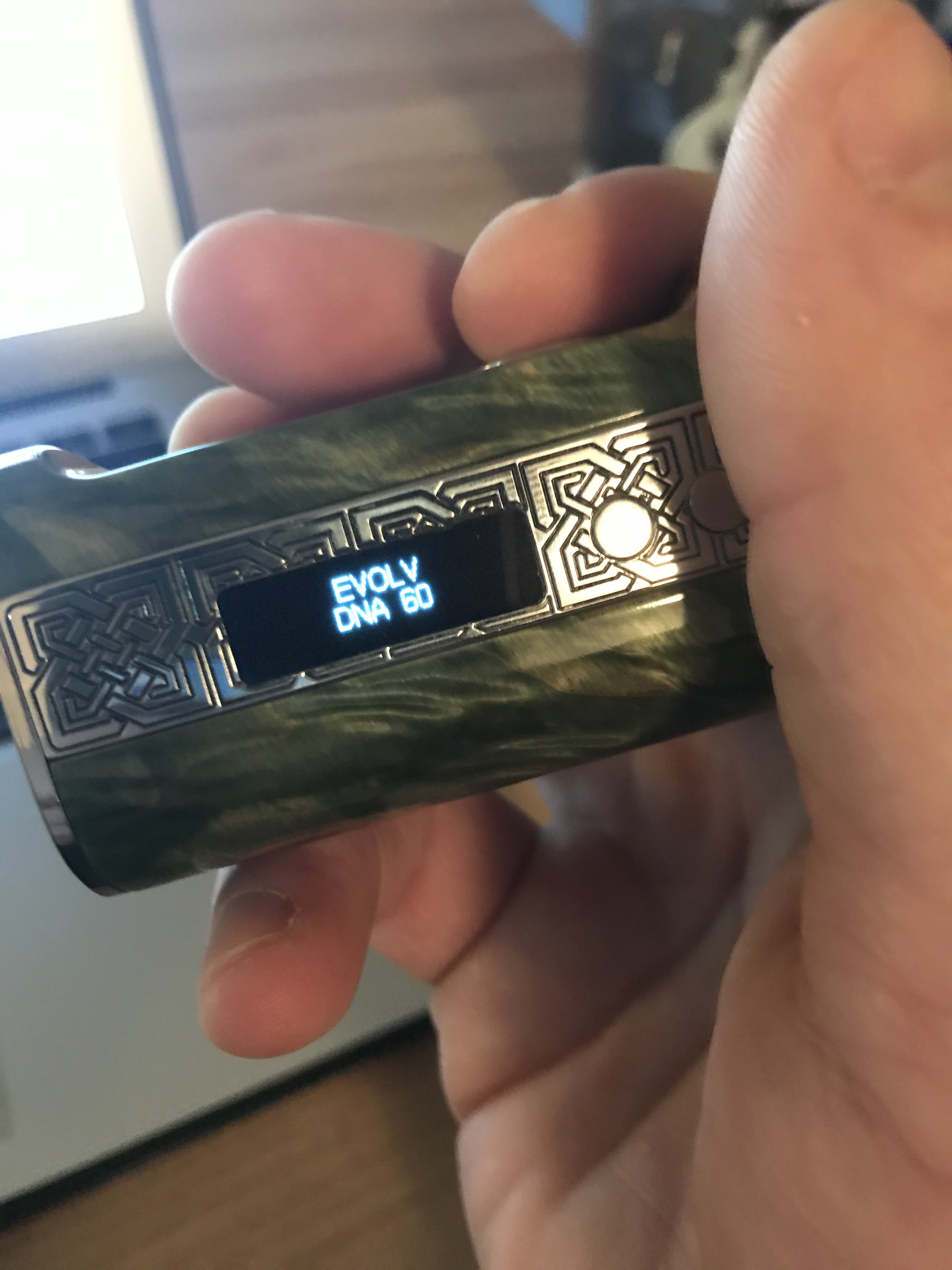

Chef Ginger Pants Posted July 8, 2020 Report Posted July 8, 2020 Does DNA60 work on Mac? I have Escribe for my DNA75C mods, but just got a RusMod in and it will not show up

Chef Ginger Pants Posted July 9, 2020 Author Report Posted July 9, 2020 Yeah Wayneo... not sure if Russia just uses different software? The buttons function the same, w. everything working off the "lock" screen, but I cant change materials etc.

Chef Ginger Pants Posted July 9, 2020 Author Report Posted July 9, 2020 Thanks Wayneo... first DNA60 here but yeah it just won't show up... I use SS316L too so thats the core issue... i need to add my material and setup a profile.
