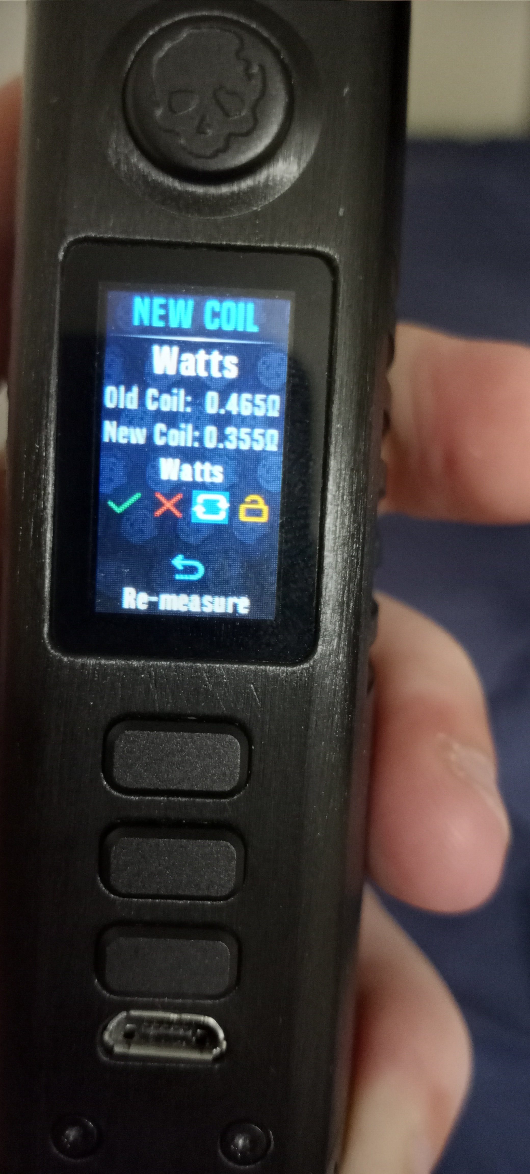

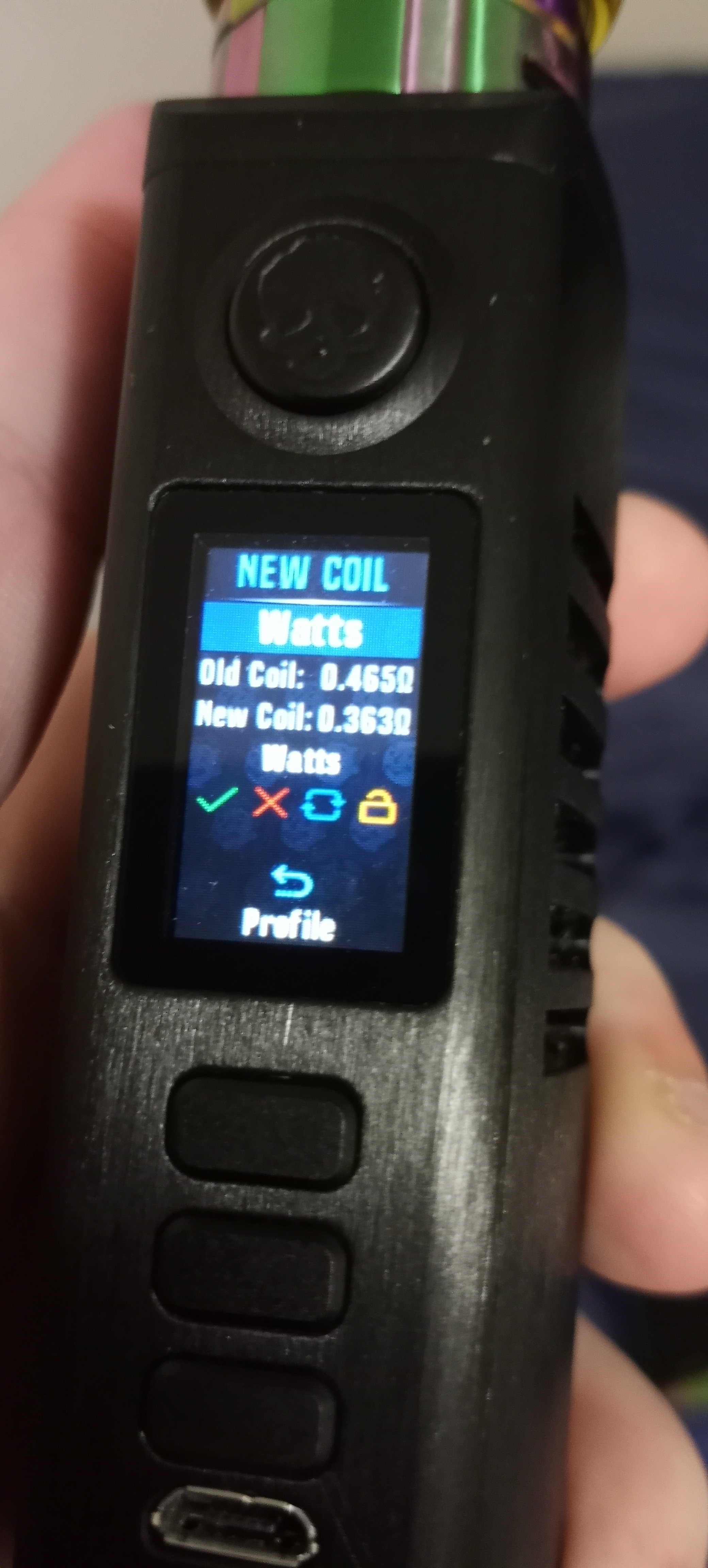

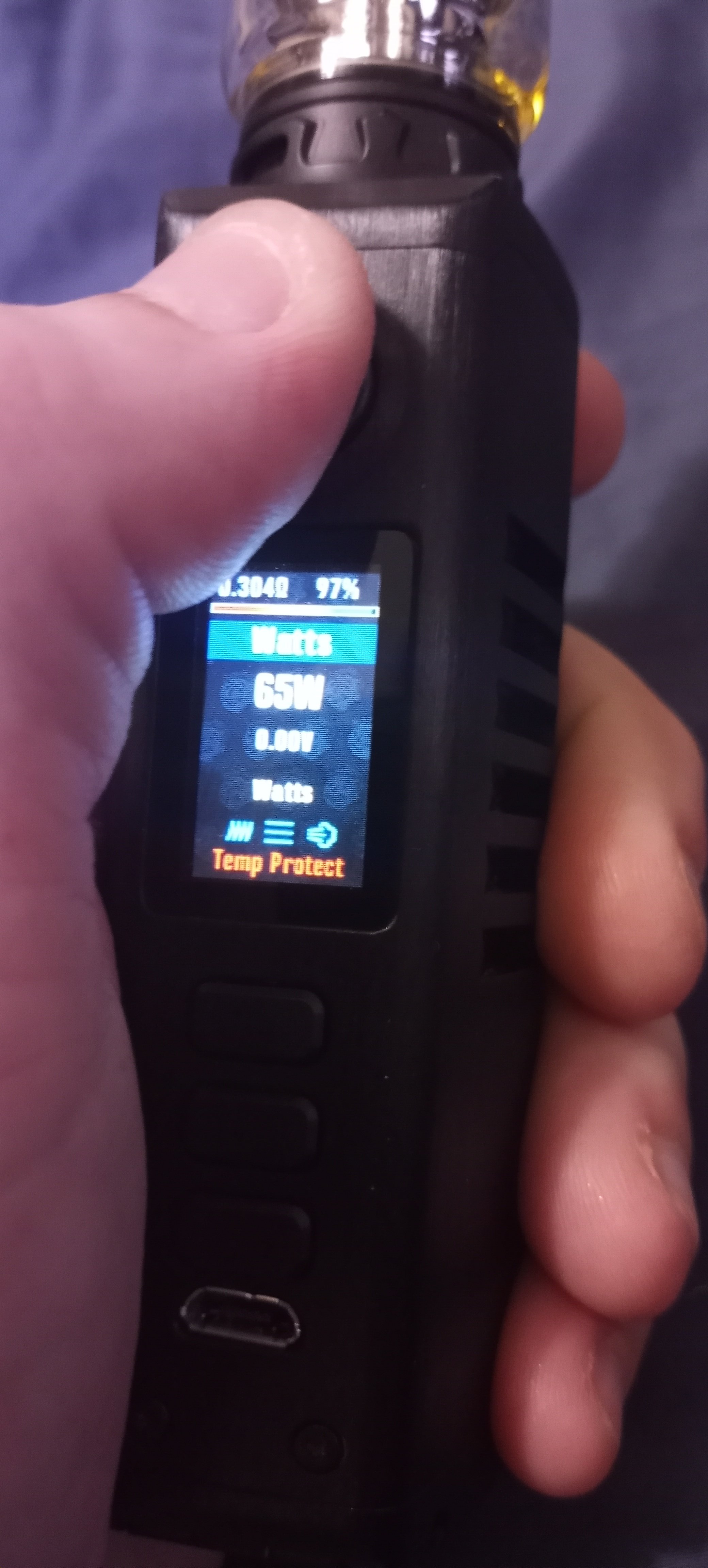

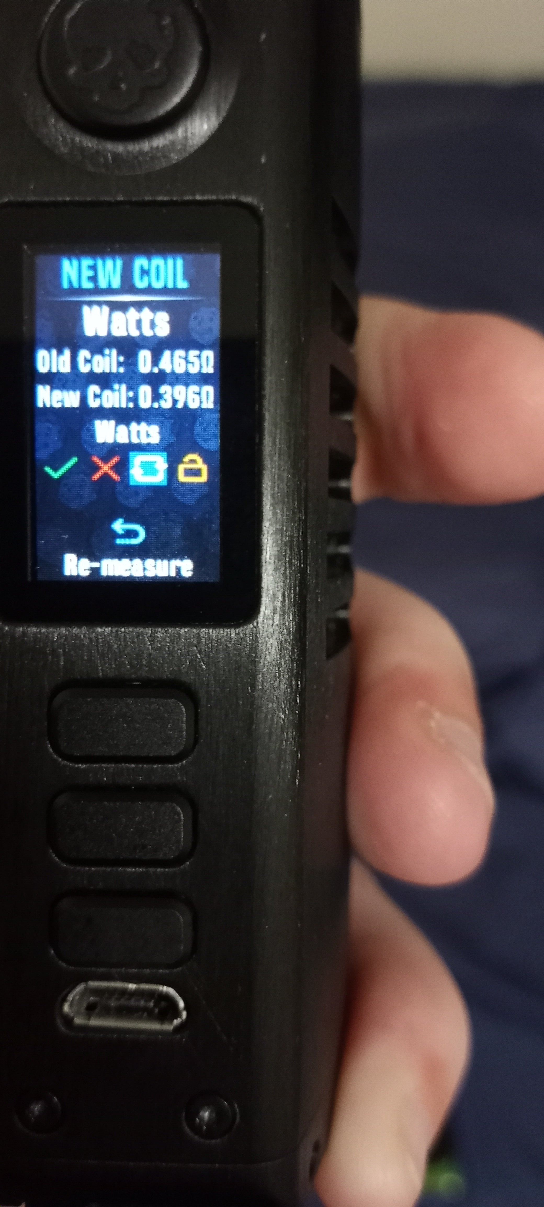

ToddB130 Posted November 2, 2020 Report Posted November 2, 2020 I'm having just about the same issue. I just bought an odin mini dna 75c and the ohms are 0 2 too high every single coil build or tank i put on it. Also everytime I hit the refresh button it fluctuates in a range thats .2 too high. The coil for my tank says it should read 0.2 and it does on all my other mods but this one it shows 0.4 I hit refresh it shows 0.41 hit refresh again 0.39 again 0.38 and so on. This is my first DNA mod also. Also I keep getting a message that says temp protect (which I think the person who wrote this ment to say but he said temp control) but its the same coil same tank that works fine on all other mods no temp issues. Ice also tried other tanks and my rta with builds but its always 0.2 over. Should I send it to dovpo for warranty? Super butthurt about this man I live this device and what to use it so bad but am so frustrated at it giving me these issues and I mean this things not cheap and now I have to wait what a month to get a working one? All my 20-40 dollar smok mods have been 100 reliable and accurate why is this expensive chip not?? The first couple pics are just showing the fluctuating ohms that are 0.2 to high and how much they fluctuate.
