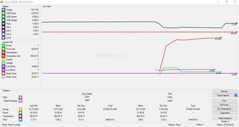

Using Device Monitor in EScribe will show quite a bit of information. Check the boxes for cold ohms, live ohms and power and post some screen shots of this happening. The Snippet Tool in Windows works well for capture. An example here, not replay but still good example.
