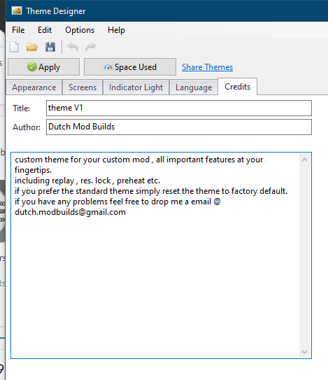

retird Posted May 1, 2020 Report Posted May 1, 2020 That .ecig file gives me the same error message that you are getting. I wonder if the Mod Designer has somehow locked the file so it cannot be installed on another 75C device? I also grabbed just the theme out of your .ecig file to try to upload and get the same message. From your .ecig file I see this and you might want to contact them at the e-mail shown... Please let us know what you find out.,....

Wayneo Posted May 2, 2020 Report Posted May 2, 2020 Loaded easily on my 75C. That is clearly a V1 theme in the .ecig file. But if you like it .............. whatever. Just go delete wallpaper #3 which is not even used and it will load, or any one of the wallpaper screens. At least it's not hideous 2
retird Posted May 2, 2020 Report Posted May 2, 2020 hum, I found many unused wallpapers in a file (not show in theme) and deleted about 5 and it still would't load.... didn't delete any wallpapers being used by the theme tho.... good you got it to load @Wayneo. I'll delete a wallpaper being used and load it.... curious about the theme contents....
Wayneo Posted May 2, 2020 Report Posted May 2, 2020 By now you'll see It's nothing more than a slightly and hastily warmed over copy of the djlsb theme with Replay (IF the djlsb version didn't have Replay) Start escribe. File -> Open that .ecig file Theme tab -> open/change/look at/save theme (after deleting 1 wallpaper) You'll see nothing but theme
