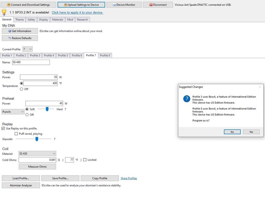

So I didn't really know the answer for sure so I installed the US firmware on my DNA75C and tried to enable the profile that I was using to be able to Replay. No you need the International version. Just go ahead and install it as the boards are the same boards, it's a legal thing for Evolv.
Here is what I got when I tried to enable Relay with the US version (SP 33.2 US)
Edit: So after posting the above I noted that it only mentioned Boost so I went back and did it over. Replay did not work with the US version.
