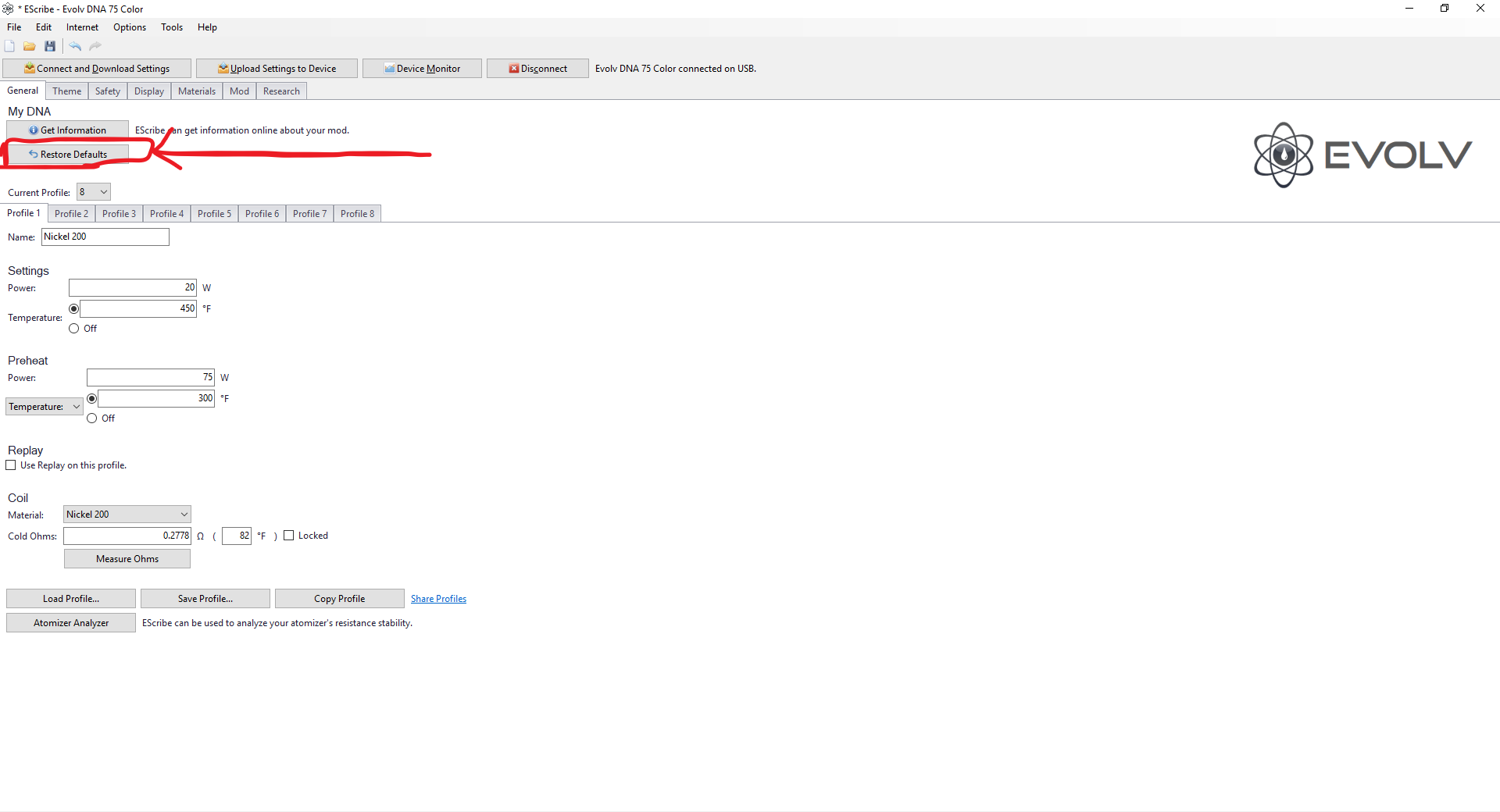

JacobEvolv Posted January 8, 2020 Report Posted January 8, 2020 (edited) To revert to default: Connect the device to Escribe and on the front page there is a button labeled "Reset defaults" This should do the trick! Edited January 8, 2020 by JacobEvolv 1
dwcraig1 Posted January 10, 2020 Report Posted January 10, 2020 On 1/8/2020 at 12:02 PM, Barendlab said: i have change the them on my dna 250c by vaping bogon need the origel them back pleas help Very few manufacturers set up their mods properly to where you can reset defaults and end up with how it came out of the box. I'm not sure how Dovpo set up the Odin. Generally when "Reset Defaults" is used the board get set to Evolv's default settings not the mod makers. One way to get it back to original setting would be to connect it to EScribe on the/a computer that it had been connected to when the desired settings were still on the mod. Connect to EScribe and go to the "Help" and choose "backups", scroll to the one needed, they list the board type and date then upload settings.
