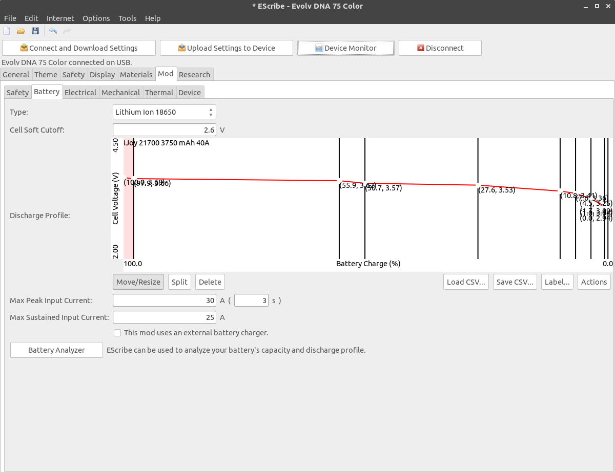

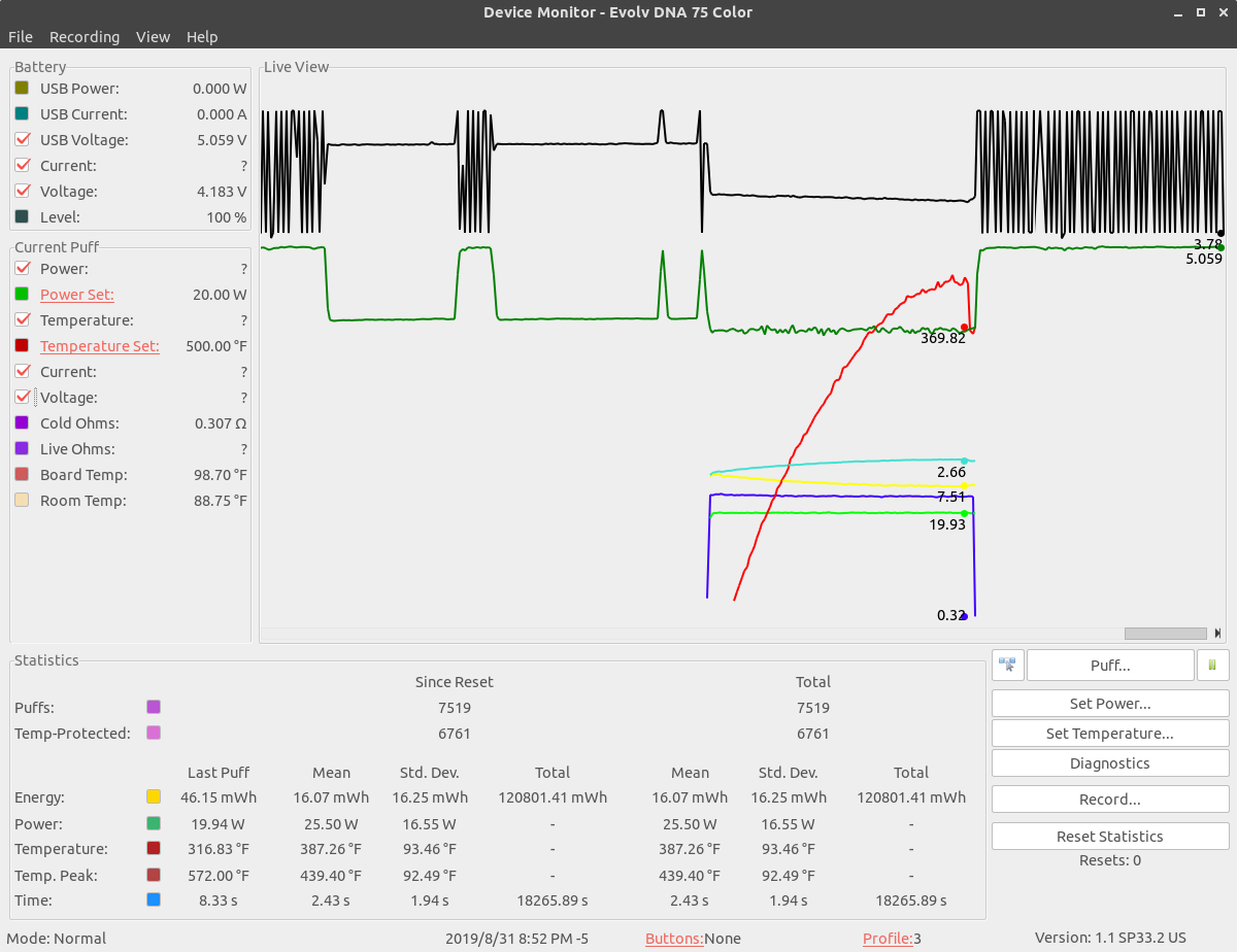

erroct Posted September 1, 2019 Author Report Posted September 1, 2019 @Wayneo, the mod has never done this till the day before yesterday, where it was left in a hot car for a few hours (I'm thinking it messed up the cell). It's a profile I got for the iJoy 21700 3750 mAh 40a I got off this forum. I then read mooch's thread on my battery an adjusted it to be in a range between 2.6-3.7v. But yes, my battery profile is pretty messed up. I can't find one for the specific battery I have. @retird, I have not tried a different battery as I am currently out of town, and I only own 1 21700. I suppose I could get an adaptor for my 18650s... Take a look at the screenshot below, I keep the mod limited within the "safe on paper" range. For some reason, the voltage keeps swinging. The vape hits like once every 20 presses of the fire button. Lastly, my vape is an ABM DNA 75c Squonk mod, 1x21700. Thank you to both of you for your help, it is much appreciated.
Wayneo Posted September 1, 2019 Report Posted September 1, 2019 @erroct I've asked a few questions, but not actually helped you yet. Bad cell or not, can you just put back on the default battery profile, or the NOT edited iJOY version and see if you're still seeing that? When you're back in town you can run 'battery analyzer' yourself for whatever cell you will be using, which will be accurate. I believe you also adjusted the 'mod resistance' value, to what I'd call way out of the norms (last printscreen, and not saying it's wrong)

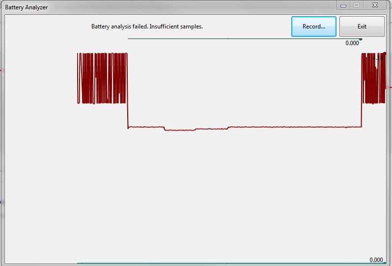

erroct Posted September 3, 2019 Author Report Posted September 3, 2019 @Wayneo I restored the chip to stock, still the same voltage issue. I'll run the battery analyzer tonight. @retird The battery was working fine, and I'm confident that it has nothing to do with the mod. I tried a different battery and had no issues. 1
erroct Posted September 3, 2019 Author Report Posted September 3, 2019 (edited) Failure Edited September 3, 2019 by erroct
retird Posted September 3, 2019 Report Posted September 3, 2019 2 hours ago, erroct said: @retird The battery was working fine, and I'm confident that it has nothing to do with the mod. I tried a different battery and had no issues. So you are confident that there is nothing wrong with the mod and a different battery worked with no issue..... so you have resolved the issue....
