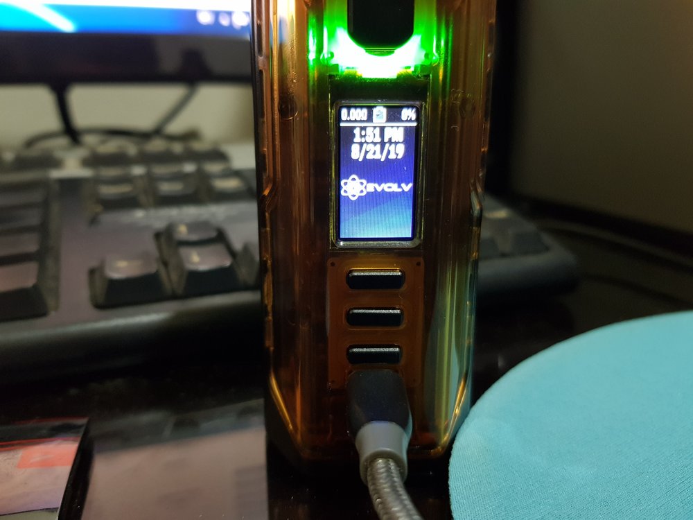

Habubi Posted August 19, 2019 Report Posted August 19, 2019 The device sitting on 4% battery without any work ٢٠١٩٠٨١٩_١٤٣٧٢٢.mp4

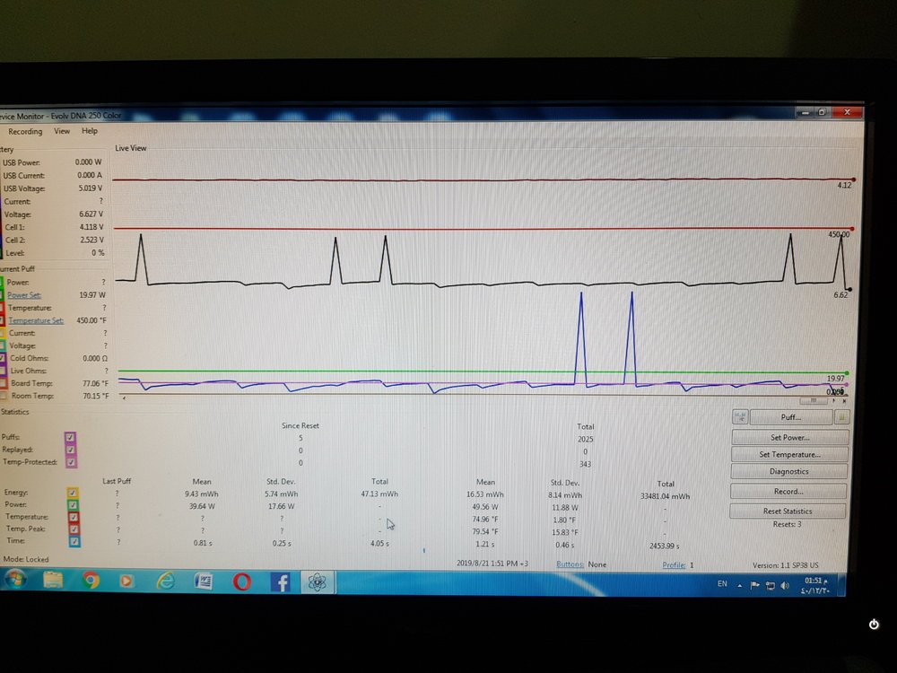

Wayneo Posted August 20, 2019 Report Posted August 20, 2019 @Habubi Look at cell 2 in your video, that battery is showing like 2.8v (can't tell from fuzzy video, PRINTSCREEN would have been better. Did this just start? Did you have any leaking?
retird Posted August 21, 2019 Report Posted August 21, 2019 Could it be that you have a bad or broken connection in the battery tray or juice leaking onto the board? Can you use a meter and check the voltage at the wires going to input connections going to the board at B- and B+? See diagram in pdf linked here: https://downloads.evolvapor.com/dna250color.pdf
c8h10n4o2x2 Posted October 6, 2019 Report Posted October 6, 2019 Hi, Had this same issue. Went into Options - User Interface - Clicked Advance. Went to the Mod tab and then the Battery tab and set Type to 2-cell and uploaded the changes. mine shows and accurate percentage now. Hope this helps
