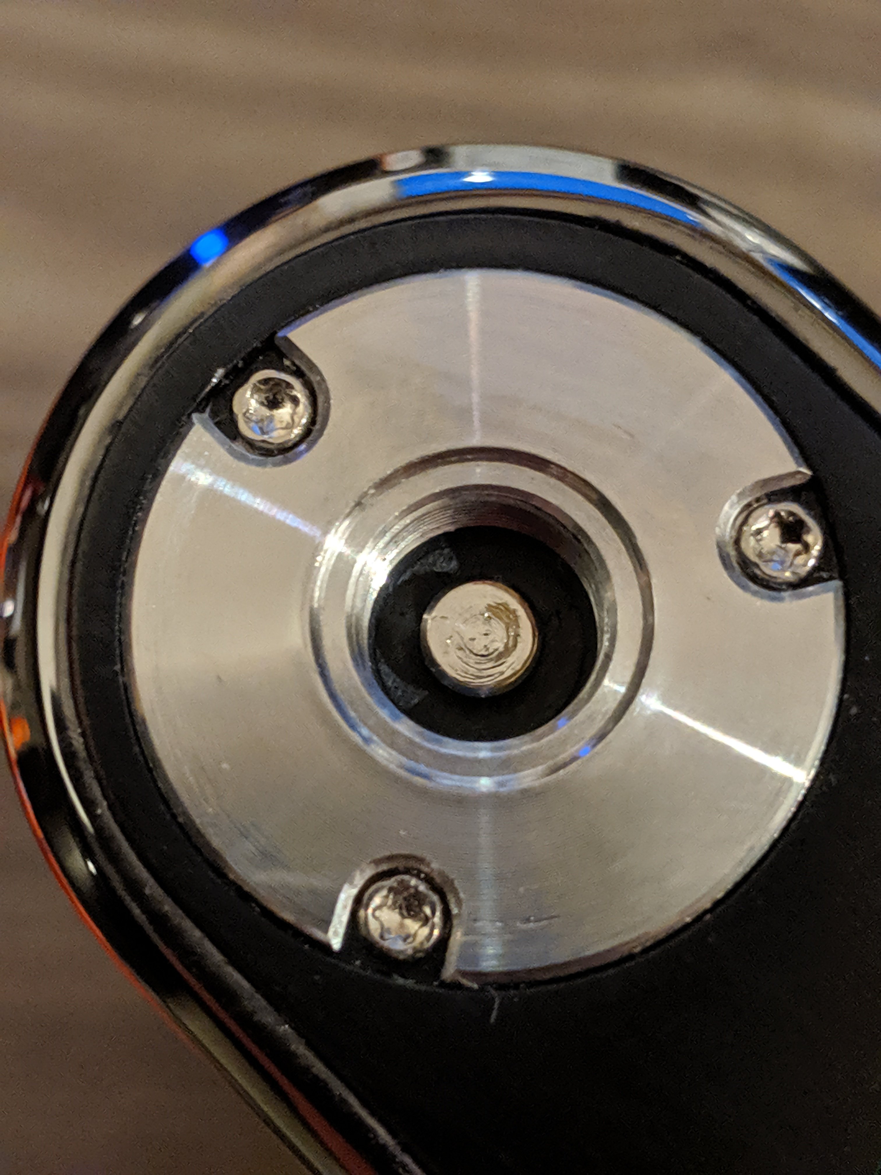

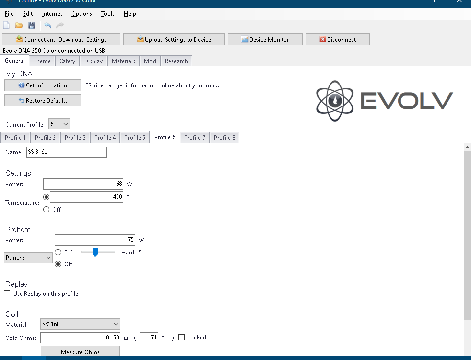

Hi everyone. I've just acquired a Lost Vape Paranormal DNA250C having previously used an Innokin Proton exclusively. On my Proton I was getting great flavour from TCR mode at 60w and 390°F. However, on the Paranormal I'm getting nothing out of those settings on SS316 mode; I have to use at least 75w and 550°F to get anything close to what I'm used to. Preheat is on and punch is set at 7. I'm using a Wotofo Profile RDA with Nexmesh SS316L strips. Any idea what's going on? The resistance is measuring at similar levels on both mods. One thing I did notice was that the centre pin on the Paranormal looks a bit scuffed up (see pic). Could this be the issue? Any insight from y'all would be much appreciated.

Thanks for that. I don't have any mesh attys. In general, your preheat settings look fine. If it's now working fine, then leave it off.

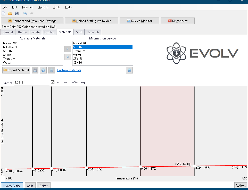

BTW, you have 2 material types for SS316, the one you posted was for straight 316, and this profile's using the 'L' variant. All's good, just pointing that out.

Yeah that was me attempting to troubleshoot. I downloaded the CSV from steam engine for SS316L. Tried it on both. No difference tbh. So why would preheat make such a difference? Thanks for the help btw.

Straight up ....... I honestly don't know. And I won't know until I get one to test it out. If that's what it took for you, I'm not gonna argue :relaxed:.
Do you mind posting a full printscreen of Device Monitor while firing? Over on the left, tick (enable) Power, cold ohms, live ohms.

Turns out it wasn't the preheat that was the issue. It was the mod measuring the resistance differently. When the mesh strip is first inserted into the RDA/mod it measures it as 0.16 and performs poorly but after firing it a couple times and measuring again it registers at 0.17 and performs much better with it set as that. I thought the pre heat was the issue because I turned that off the same time I measured the coil.
