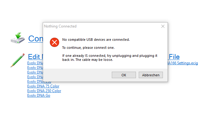

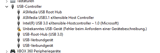

JohnnyBigodes Posted May 21, 2019 Report Posted May 21, 2019 Hello guys, today I tried to connect my Lost Vape Therion 166W to 2 different PCs with Windows 10 and the result seems to be the same. At first it gets recognized, but when you try to upload any settings through escribe the device stops working. It seems that it deletes the USB driver, so that the device stops beeing recognized. Even tried to install the drivers again but it wont work. (Error = Unknown USB device) Is there anyone with the same problem or is my DNA250 not good anymore? Thanks in advance for your responses.

JohnnyBigodes Posted May 21, 2019 Author Report Posted May 21, 2019 vor 2 Stunden schrieb dwcraig1: First thing would be to try a different cable. External USB hubs can be a problem too. Yes I already tried different cables and different ports. Nothing helps... Seems that my DNA is broken. I still can charge it through USB and vape on it, but i cant change any settings on escribe.
