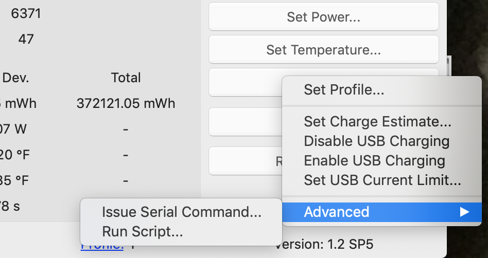

Llittle_Llama Posted April 4, 2019 Author Report Share Posted April 4, 2019 These are my only options, and when I try any of the ones at the top dropdown it just wants me to set up parameters. Link to comment Share on other sites More sharing options...

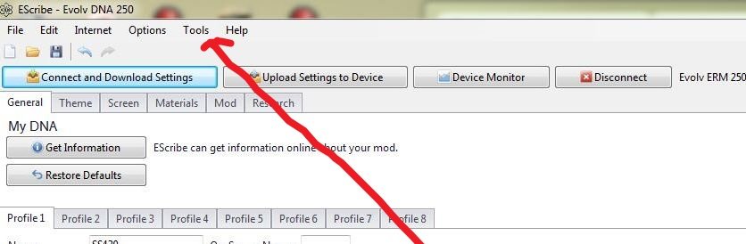

dwcraig1 Posted April 4, 2019 Report Share Posted April 4, 2019 Do you mean you can't access this? Link to comment Share on other sites More sharing options...
Llittle_Llama Posted April 4, 2019 Author Report Share Posted April 4, 2019 Mine looks nothing like that, the only things I have are this: Link to comment Share on other sites More sharing options...
Llittle_Llama Posted April 4, 2019 Author Report Share Posted April 4, 2019 This is really frustrating trying to both fix something and learn a new software at the same time. It has to be even worse for you since you're trying to do the same thing as me but online and not in your hands. I really appreciate the help, and honestly feel like I'm almost there! If I had that Tools tab I think I would be good by now 😕 Link to comment Share on other sites More sharing options...
dwcraig1 Posted April 4, 2019 Report Share Posted April 4, 2019 That screen is "Device Monitor". It can be run separate from the main EScribe , try and locate your main EScribe. Do you have a volt meter and a stand alone 18650 battery charger? Link to comment Share on other sites More sharing options...
