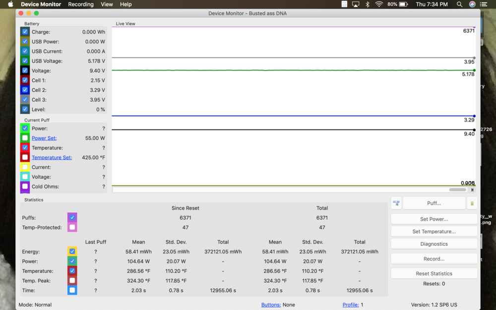

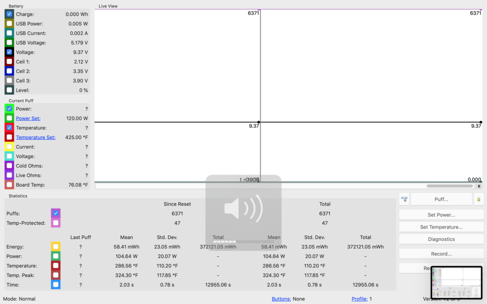

First battery: Cell 1: 2.12 Cell 2: 3.35 Cell 3: 3.90 New battery: Cell 1: 2.15 Cell 2: 3.29 Cell 3: 3.95 Seems a little suspicious to me...
So new battery came in today... I'm having the exact same issues! Battery levels are exactly the same as before with this battery. No idea what to do at this point since I don't think both batteries could be so close to the same levels. Here is the pic for the new one:

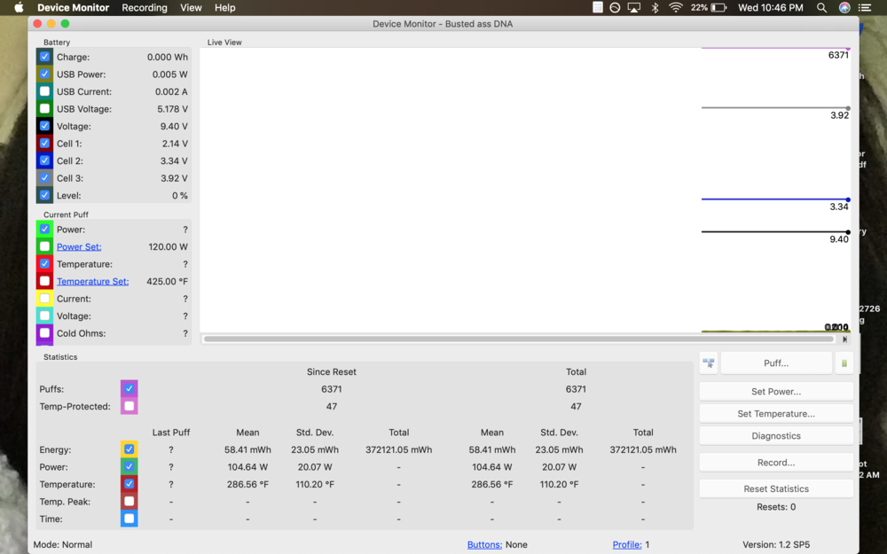

I've never used escribe before, so it's all new to me. The battery is showing not charged, but nothing happens when I plug it in to charge it. It won't come on, and the screen stays blank. Can it be turned on when charging, I would assume so but I feel I need to ask. The mods acts fine when plugged into my Macbook with the exception of the screen being dark. Also, the screen has become super dim since this started happening. When I hit the "Fire" button on escribe the screen says "Check Battery" Ok, this is what I ended up with:

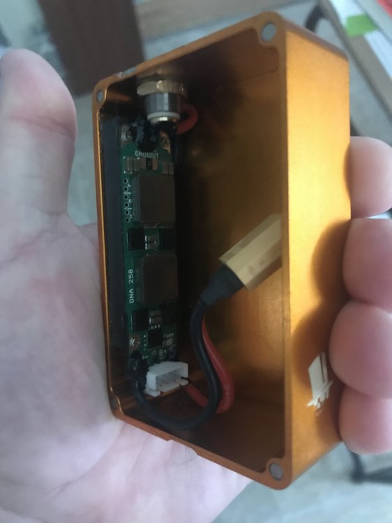

I bought a custom mod about a year ago. It worked perfectly until one day it just wouldn't turn on. I bought another battery (lipo) for it and nothing changed. I know its a real chip, I got the COA with it and it came from a reputable maker (I'll get the name later tonight). I emailed them and they were of no help (so maybe not that great of a maker?). Is there someone that could help me, I can't solder to save my life and I've never messed with a chip/lipo before. ANY help would be greatly appreciated as I want to use this awesome mod again! I am a hobbyist on a budget and this was by far the most expensive mod I've ever bought. Thanks in advance!
