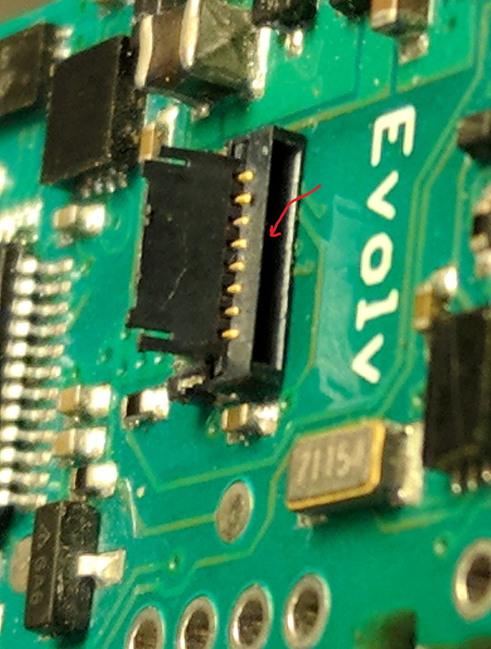

DNA250c screen connector ZIF
Bombastinator
Open/close - 3 color pictures are usually in the  datasheet for each board. The connector hinges at the edges, close to the board. I usually grip the connector with my fingers at each side and lift it straight up towards the cable. When you reinstall, there's like a click/detent so you know it's locked in.
Use a magnifying glass if needed.

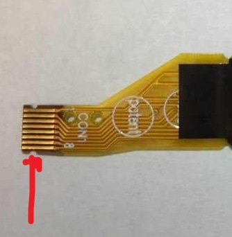

It goes into the slot marked by arrow, not above it.
Put it in squarely past the notch marked by arrow and carefully close cover.
I had major problems with this on my first one, I kept trying to put it between the door and connector instead of the slot.
