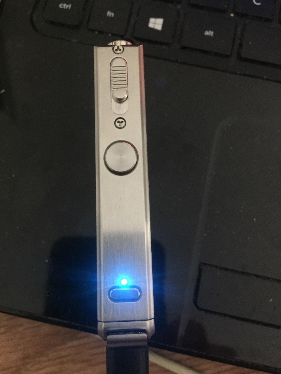

ehab Posted December 9, 2018 Report Posted December 9, 2018 (edited) Mybattery is full why the light not off Edited December 9, 2018 by ehab
ArminF Posted December 9, 2018 Report Posted December 9, 2018 It will turn off after while. The chip pulses the charge between 4.15 and 4.20 Volt to protect the loading. When i leave mine over night (yes i trust the chip) the light is off in the morning.

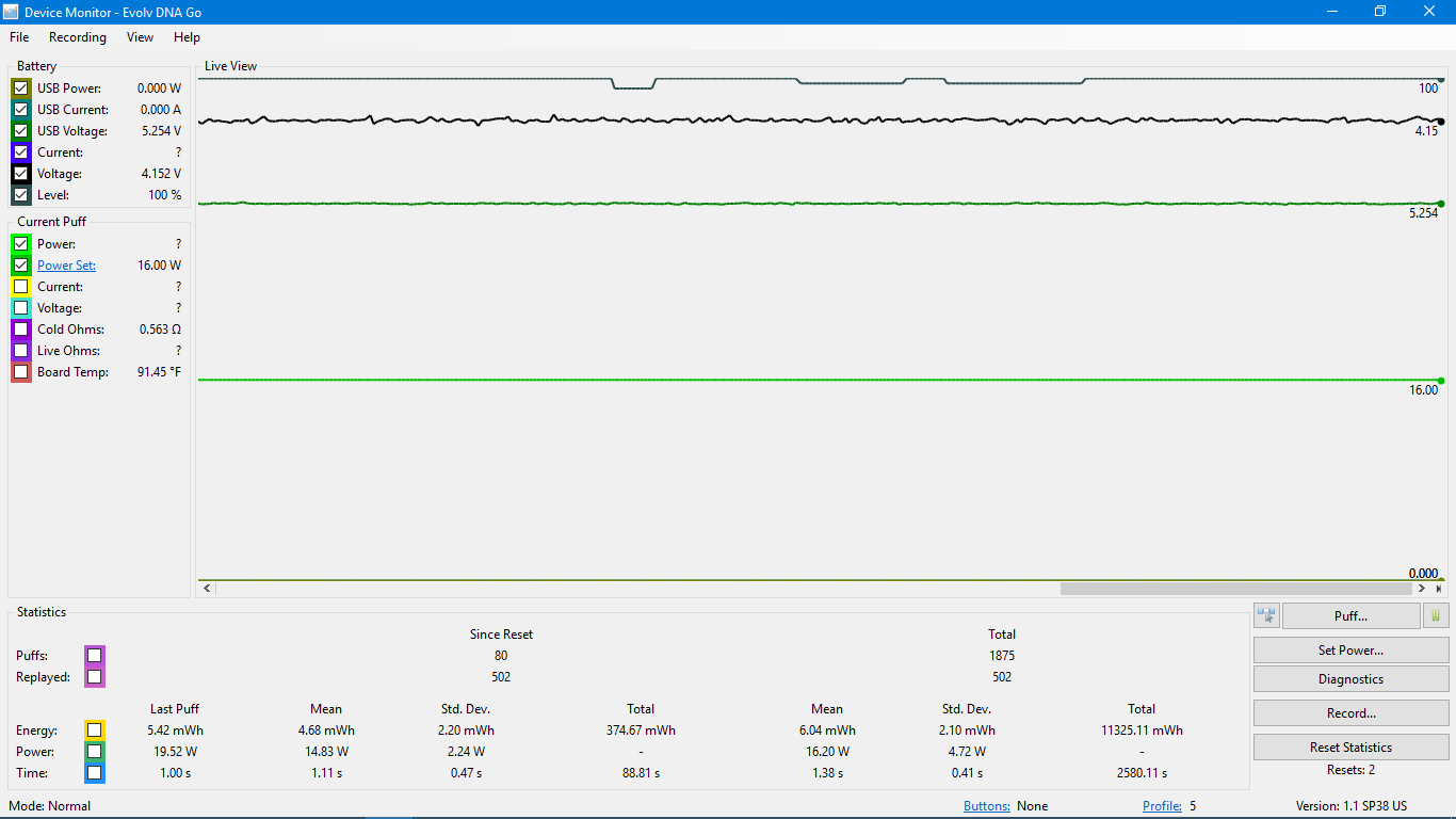

ehab Posted December 9, 2018 Author Report Posted December 9, 2018 Did u see the mode is normal. its mean its stop charging but light not off
retird Posted December 9, 2018 Report Posted December 9, 2018 When the Blue Light is showing it is telling you the battery is 95% to 100% charged. While plugged into EScribe the Blue Light will remain on until the device "goes to sleep" at which time the led will go out. When unplugged from EScribe (after fully charged) the blue light tells you the charge status when you want to see it and Blue is but one of the charge level lights. This also is true when using a wall charger to charge the battery.
