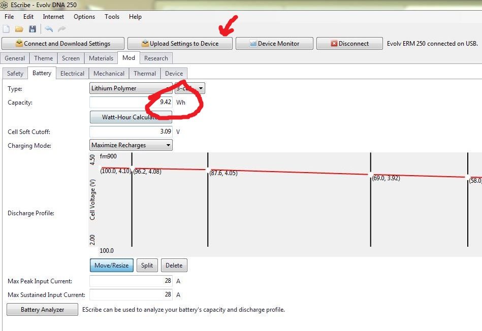

dwcraig1 Posted February 19, 2019 Report Posted February 19, 2019 In Escribe change the figure for battery capacity and upload settings. You didn't mention what cells that you are using so either convert mah to watt hours and subtract 20% or try a conservative figure like 25 wh if using 3 cells. Or run Battery Analyzer. Note: I have modified the curve to reflect the change from max puffs to max recharges (charging stops at 4.1 volts)
