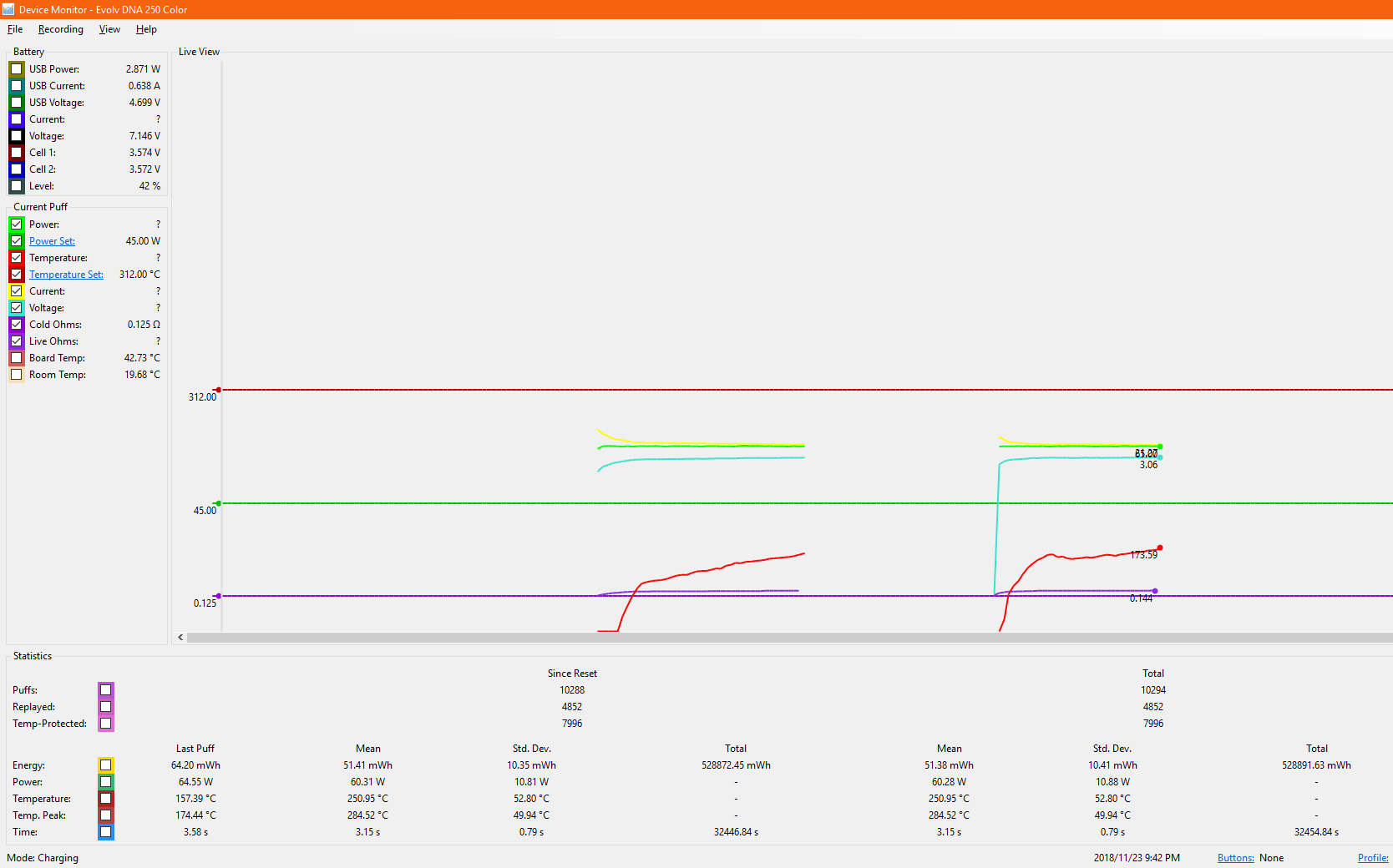

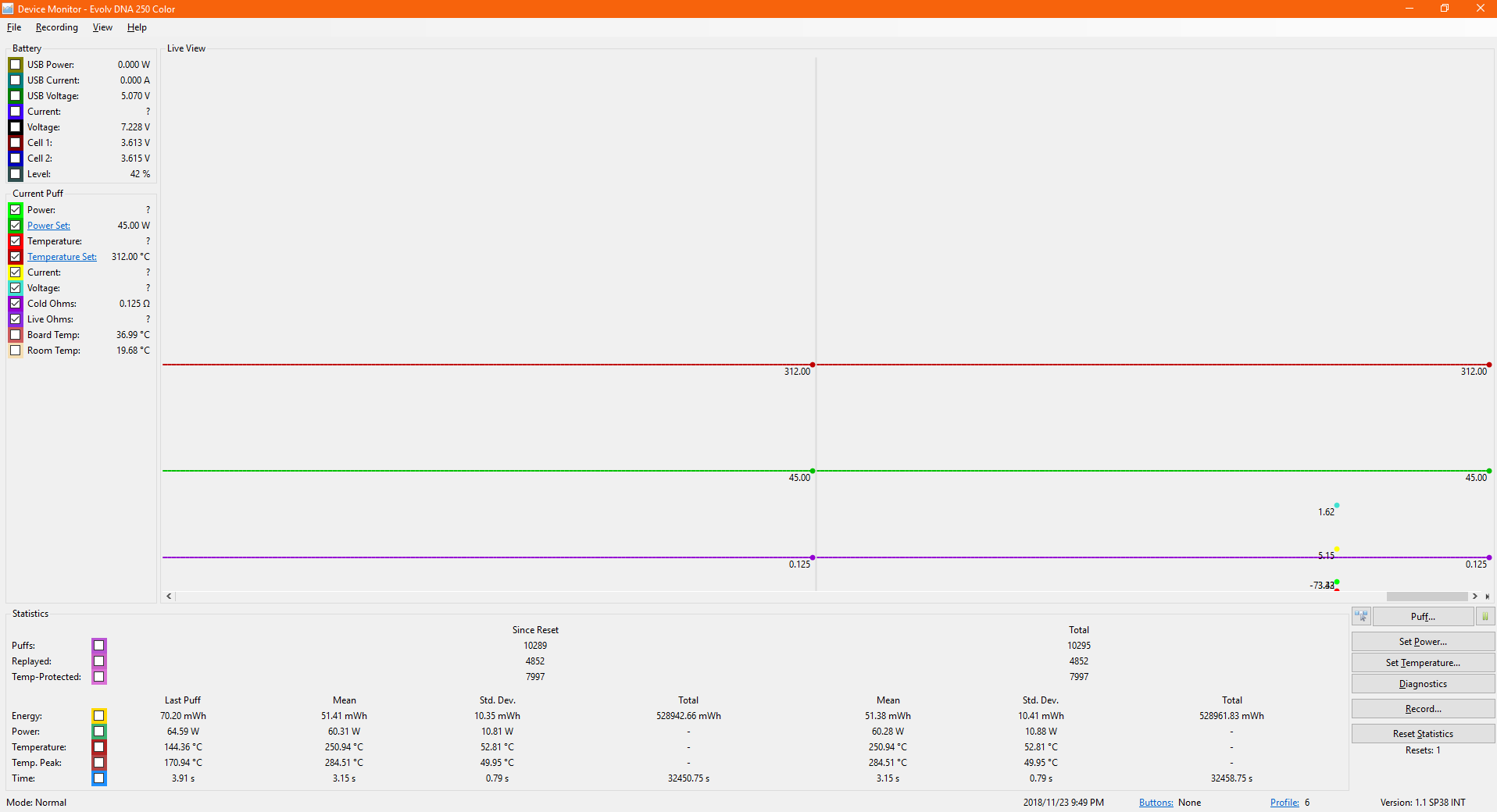

Nexolek Posted November 25, 2018 Report Share Posted November 25, 2018 (edited) Are you able to get a screenshot of a few puffs in Device Monitor? That might help. Edited November 25, 2018 by Nexolek It helps to use the right words... Link to comment Share on other sites More sharing options...
Darkstar_ Posted November 25, 2018 Author Report Share Posted November 25, 2018 Sure, This is a normal puff This is a "temp protect" puff which is happening all the time now. I have to use wattage mode. Link to comment Share on other sites More sharing options...
Lanzarotechris Posted January 8, 2019 Report Share Posted January 8, 2019 First thing that hits my eye is your temp setting. 312°C is way too high. As you see with the "normal puff" that temp is around 170°C in the peak, so you can set the temp to 200°. I prefer 235°, and you should not go higher than 250° as that is the temp when the cotton will start burning. Second thig is the resistance. In the normal puff it rises only a little (from 0,125 to 0,144) and then stays at that level. It looks to me like a kanthal coil, not SS. That could answer the question why TC is not working properly. Kanthal can not do TC as there is (more or less) no resistance change. That is why you need to use SS for TC because the resistance will change and the computer can calculate the temp from that change in resistance. So check your coils and make shure you use the right material for the right setting. If you need info which wattage to use with which resistance I would forward you to steam engine. You put in your details about the coil and you get a recomended Wattage. Of course you have to know your details like material, thickness, diameter and so on. From that recomendation you can start and go up or down with your wattage setting if you want it warmer or cooler. Link to comment Share on other sites More sharing options...
