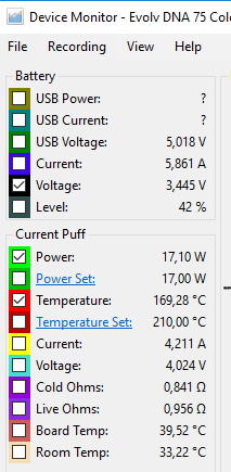

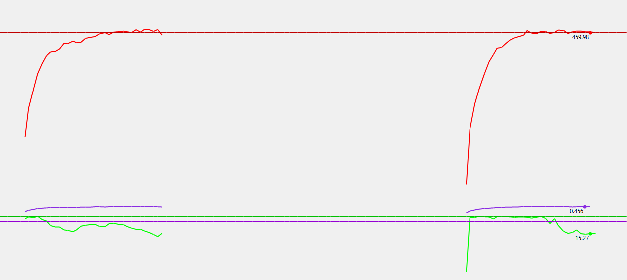

Please see the Escribe screenshots when in TC without Replay function and a Preheat of 20 W.
Mirage-1.PNG.49a051c0151bbf7024cf8dea65f73102.PNG    Mirage-2.PNG.0b98149525278edf28d1040a7830fc90.PNG

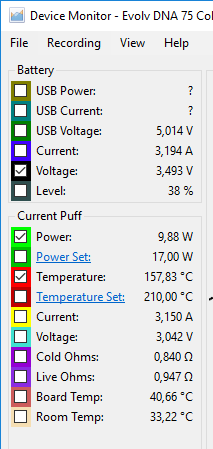

And with Replay function activated (No Preheat). The problem appears (2nd version).
Mirage-3.PNG.33fff9ff2ebba42fcc4b47bdacc3918e.PNG  Mirage-4.PNG.5db3e0f84c672c6ded1558fcc98d9b6e.PNG

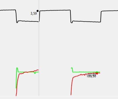

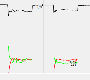

Please see the below screenshots.
Mirage-5.PNG.780b6ada7dbfb7659c71bd170f2989bc.PNG  Mirage-6.PNG.a11f292378b0b33cdcdef34ba2fa6e3b.PNG
The leftmost is without the Replay. Watt  almost steady at 17. The yellow line is the current.
The rightmost is with the Replay On. Watt drops down in a fraction of a second and ranges from 14 to 14.7.
Believe me, the two watts make the difference in the vaping!

Thank you @retird
Yes I did try.  You may see the screenshots in my first post.
The top one shows vaping in TC mode, where everything is as it should be, and the below one vaping in TC mode with the Replay function ON.
With the Replay function ON, the watt drops down to 9,5 making the vaping impossible.
Some times instead, the watt rises to 25-26, making the liquid to boil!

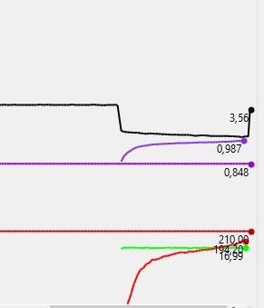

Mirage-NR.JPG.469ad364e7b1222aedf5ab8ed1a71ceb.JPG  Mirage-R.JPG.ecffc6774973c66a7a4e80d4a061bea9.JPG
The left screen shot is without Replay.
Shows Live Ohms, Cold Ohms (purple lines), Temp set (red line) and ranging of the Temp and Watt.
Temp is set at 210C and Watt at 17 (without any preheting/boosting)
The is rising up to 194C and watt remain almost steady at 17 (during the puff). the increase in resistance is within the normal limits, I think.
The right screenshot is with Replay with same settings.
That is, Temp at 210C and Watt at 17, without any preheating and warmth at 1.
Resistance increases normally, the resistance shows measurable variation and finally drops to 13 giving subdued vaping.
Each puff has great differences from the next one, mainly in the variation in Watt, which either drops down to 10 or rises up to 25!

From your Screenshots you can see that TC is trying to get to Set Temperature of 210.00 @ 17 watts but only gets to 194.00.  Raising the wattage a bit or adjusting preheat should let it get to Set Temperature.  We know that is how the 250C  board manages TC.
Now in Replay Mode the device (DNA250C board) manages  in the background many functions to achieve consistent repeated vapes.  I don't know how it manages things but it does.
I assume you are vaping 1 vape then setting Replay.... try vaping 2 vapes then set Replay and see what it looks like in Device Monitor.
Maybe I'm not understanding what the issue is?   Is your issue that you get the same vape in Replay as you get in TC mode but just at different Temp and Watts as seen in Device Monitor?
