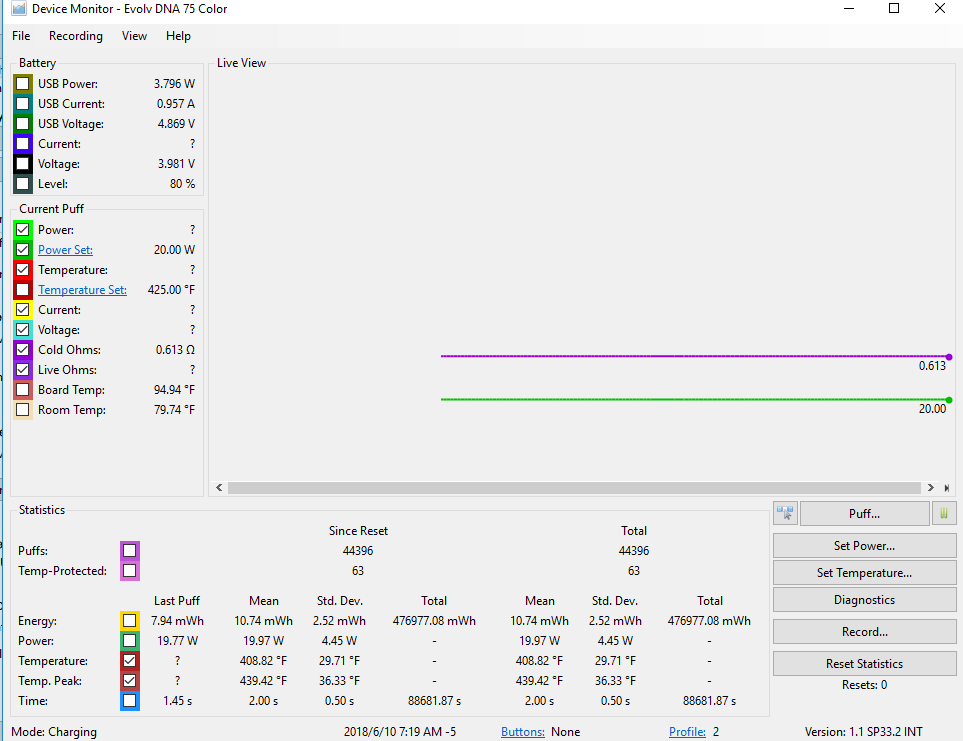

spalife Posted June 10, 2018 Report Posted June 10, 2018 (edited) I am a bit of an OCD when it comes Wattage/Temperature control and Liquid consumption. I looked hard but I am not able to find info regarding when in Replay Mode What is the ? - Wattage and Voltage of last vape - Temperature of last vape - Coil Live Resistance during last vape Appreciate if anyone can share their knowledge or direct me to some references. Edited June 10, 2018 by spalife
retird Posted June 10, 2018 Report Posted June 10, 2018 In Escribe Device Monitor check the boxes shown on the left and vape. The graph will fill in.... 1
spalife Posted June 10, 2018 Author Report Posted June 10, 2018 Yeah, they do in Device Monitor. I wanted that info while using Replay on the Mod. I don't seem to find any info on viewing/enabling those on standard or custom themes.
retird Posted June 10, 2018 Report Posted June 10, 2018 The theme design determines what is available to access on the device... You may be able to find what you want in the Download section of this forum.... make sure to backup your ecig and theme file before making any changes so you can restore them if needed.... https://forum.evolvapor.com/files/category/6-dna-75-color-250-color/
