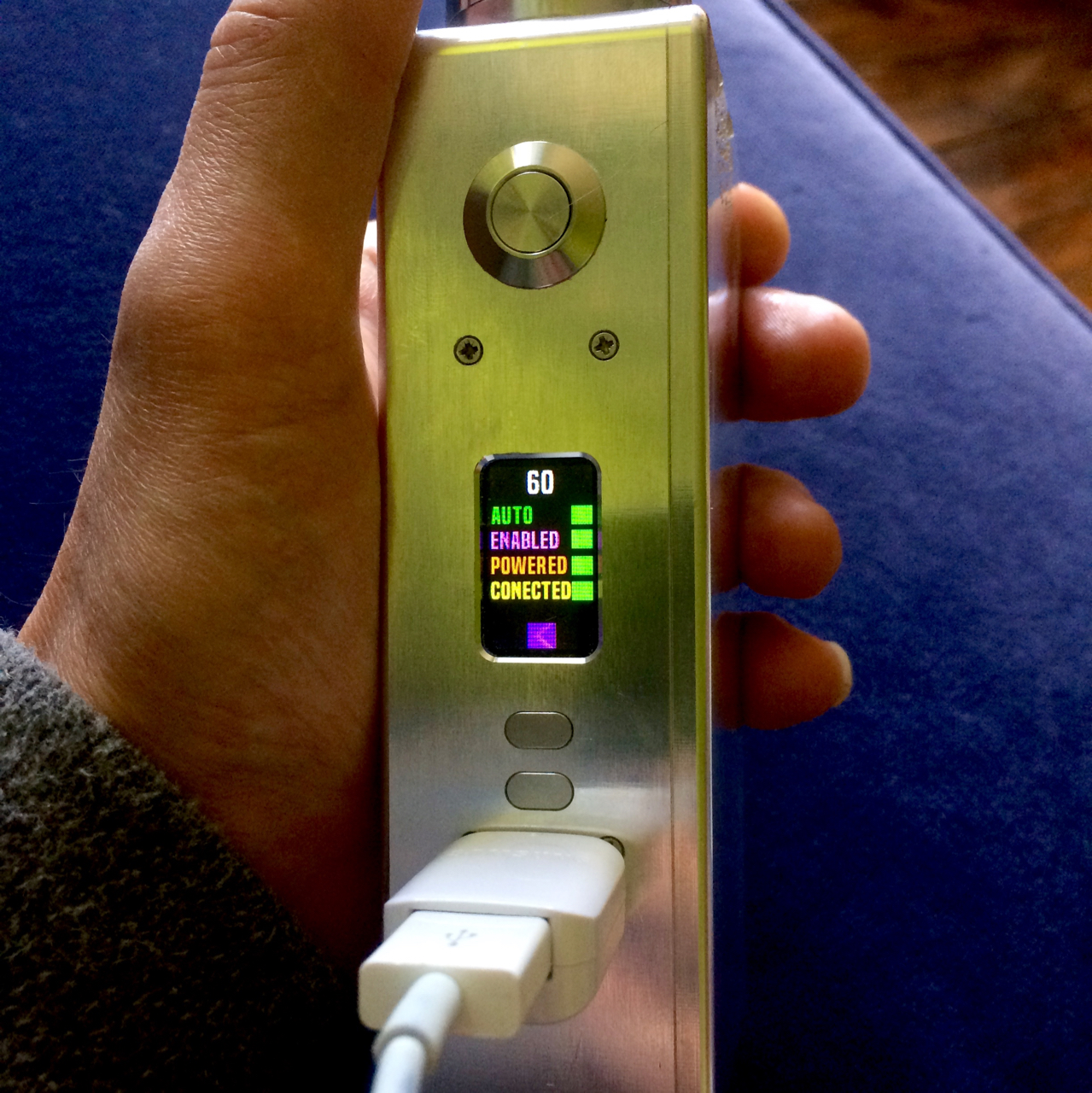

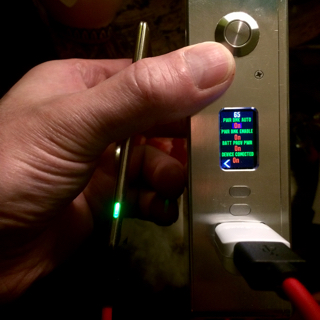

Guy Nicolson Posted May 18, 2018 Author Report Posted May 18, 2018 Set up a page for OTG Power Bank with all the toggles and info I could see to use I can charge a power bank using micro USB but not charge my iPhone using a cable that I regularly use to charge that. This tells me the OTG adapter is working. Maybe it's the current level from the mod that is the problem?

Guy Nicolson Posted May 18, 2018 Author Report Posted May 18, 2018 (edited) If you completely turn off the iPhone before charging, it will turn back on when you plug it into the charger. If its on when you plug it in to charge, the battery symbol at the top right corner will turn green to indicate its charging. Additionally the lock screen will show the battery percentage followed by the word "charged" under the clock. I get none of the above when using power bank OTG to charge my iPhone with a frequently used lightning cable and an alternate tested and working lightning cable After setting up a screen with a toggle for each the mod shows it is connected and discharging AUTOMATIC POWER BANK MODE ENABLED BATTERY DISCHARGING ( POWER BANK) CONNECTED AS POWER BANK Edited May 18, 2018 by Guy Nicolson
