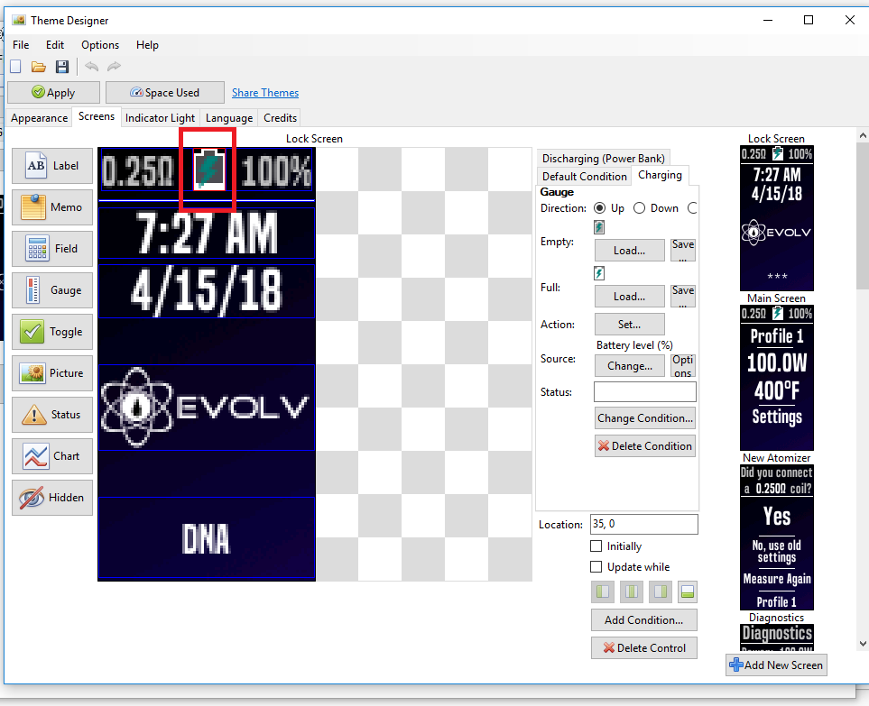

retird Posted April 15, 2018 Report Posted April 15, 2018 Does your theme have a battery level icon and does it place a lightning bold in the battery level icon when charging. This pic shows the battery level on a lock screen and while charging one only needs to press the fire button to turn the screen on and check the charging state.

ruckus Posted April 16, 2018 Report Posted April 16, 2018 Maybe consider adding something to the lockscreen in the theme editor ? You can add a large battery gauge that show's only when charging or individual battery cell voltage(s)...
retird Posted April 16, 2018 Report Posted April 16, 2018 Cabbage Evolv Light and Cabbage Evolv Dark theme (the newest versions), found in the Downloads Section has a Battery Screen that Shows Total Voltage, Voltage for Each Cell, and Current output Amps of last vape. It is real time in both Non-Charging and Charging State. Also when vaping you are at the Main Screen and while not charging you can select Battery and it will jump to the Battery Screen and you can see the state of all batteries, Select Back and you are back to the Main Screen.... One of the best themes I've used...... Works with 75C and 250C Screen shot from Theme Designer of Battery Screen ..
